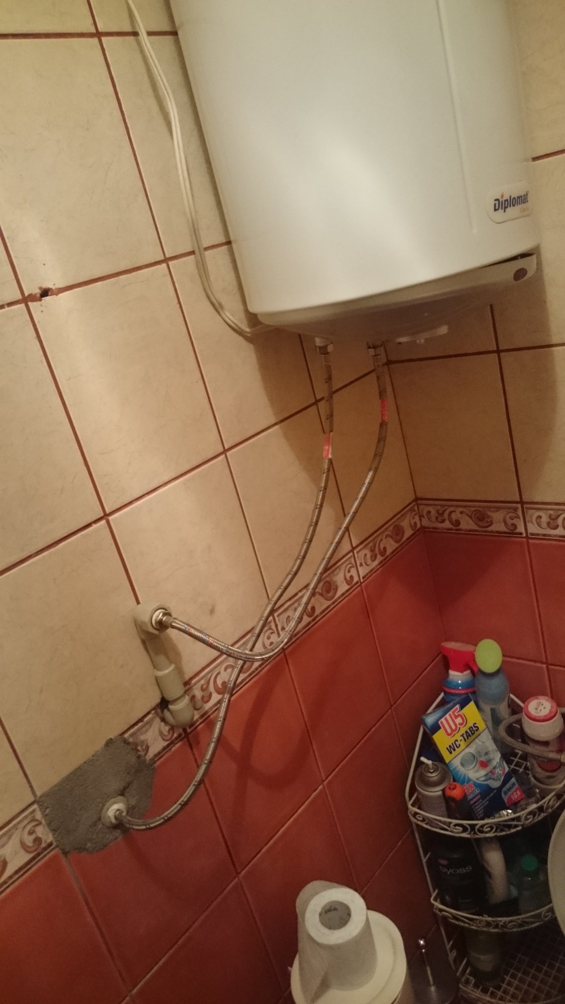

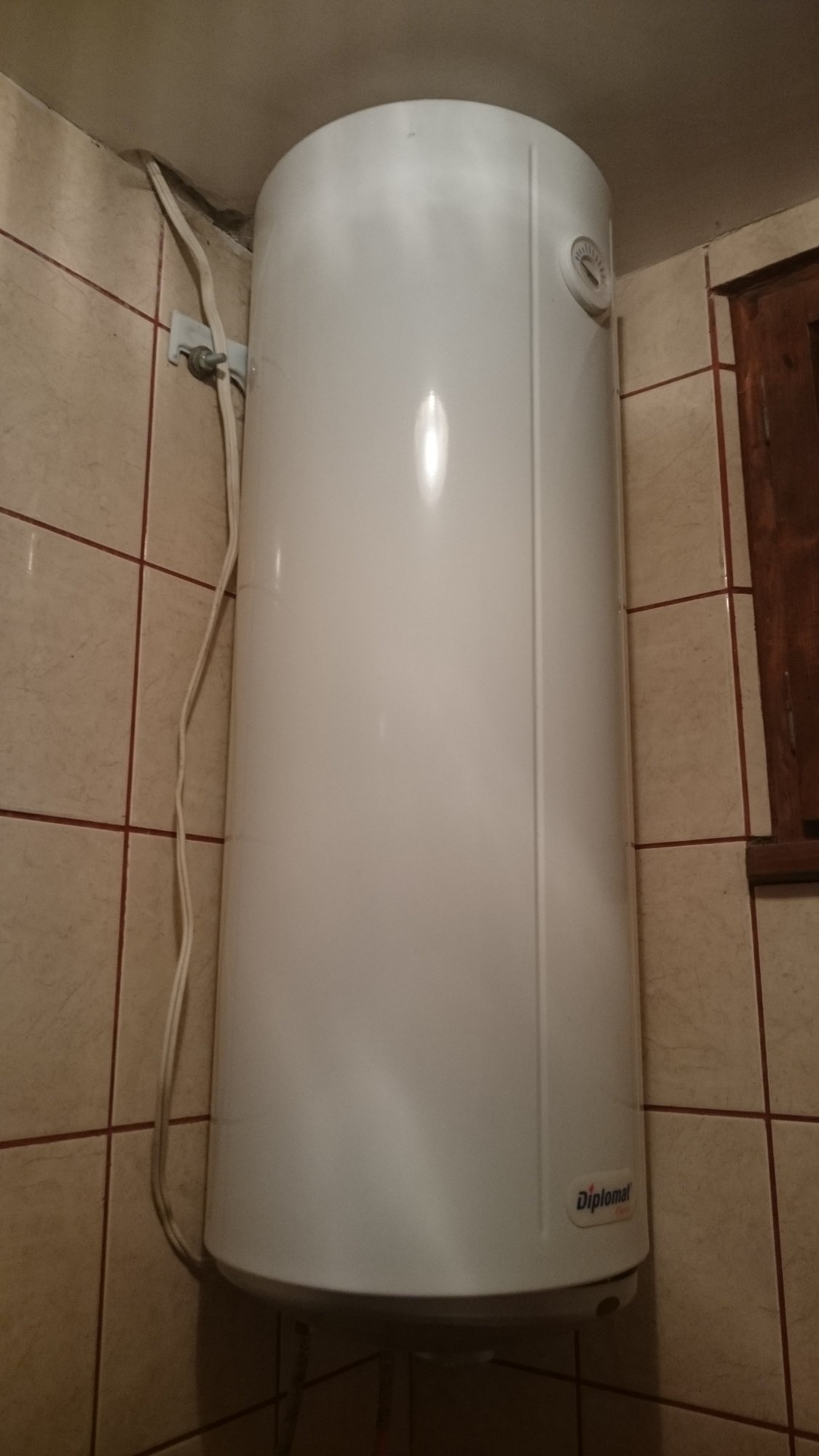

Hi,
I intend to install an EV (expansion vessel) to my cold water line as I'm having problems with pressure affecting my water heater and taps. When the water gets really hot, the safety relief valve is triggered and drips. I never understood why this happened until it occurred to me that this is an unvented system with no EV present, therefore no means for expansion. I have never fitted one of these before so I just wanted to check whether I'm installing at the correct place on the line. To demonstrate, I have provided a PNG image to show the layout of my plumbing lines and fittings etc.
Some things I'm not sure about:
Why is the EV installed on the cold line (before water heater) and not the hot (after water heater)? I always assumed that the EV would be installed to take up the expansion of the resulting hot water, not cold prior to it being heated. If someone could explain, that would be appreciated.
Although I've got the PRV (pressure reducing valve so that we're clear) at the cold in at mains, I assume I must install a secondary at the hot out from water heater (as shown) due to raise in pressure after water heated?
Is the check valve in the right place near the EV? Do I just use a simple Tee to incorporate it to the cold line as shown? Or is there a special fitting I would need instead/ additionally?
Lastly, my water heater has a capacity of 80L and I'm unsure of what size EV to buy. Ideally I'd want to use the smallest size possible so I'm thinking a 5L or if I could get away with an even lower capacity please let me know.
So does my diagram look fairly accurate? Basically my work would consist of: teeing off for the EV and putting check valve before the tee (not after otherwise water wouldn't be able to back siphon into the EV if I'm right in assuming) and fitting PRV after water heater if necessary. Please note, Y filters not shown but would be installed.
I'm aiming to maintain 60 PSI pressure throughout to prevent damage to fittings.
Many thanks for any advice :)
Please note, this is a Bulgarian installation, but the procedure should be identical to UK practices.

Hi Gasguru, many thanks for your reply. The water byelaws are very likely to not be as stringent as UK standards. Whilst there may be 'plumbers' (I'll use that term loosely) in the city, there certainly aren't any available where I am and chances of them commuting to a village are extremely unlikely.
I have been under the impression that such work can be carried out by a competent DIYer, hence the various articles I've read
https://www.thespruce.com/water-heater-expansion-tank-information-2719063
and videos I've watched (plumber parts).
If you look again at the last picture on my previous post, there is a safety relief valve (what the village plumber cow boy fitted with protruding horse hair and was still leaking around the thread!). Notice the green lever? That's the relief valve. But I replaced this boiler with a newer Bosch and did all the work myself. Sadly I don't have pics. I also installed a new pressure relief valve with PTFE.
All if most plumbing in BG is carried out by the home owner, probably because a lot of people can't afford to hire.
What could possibly be the worst case scenario of an ill fitted expansion tank (10L)? I've heard that they can practically explode if not installed correctly? Surely a 10L tank fitted alongside an 80L water heater is not going to cause that much of a risk? Are they really that unsafe? I can't understand why there are claims that these can be fitted by a DIYer, yet forum users (elsewhere) are claiming that it's too risky and dangerous?

Gasguru, I appreciate your input and I hope you don't feel as though I'm trying to undermine what you're telling me; I'm simply just trying to share my views. Besides, it could be invaluable to other readers also which is a plus. The water heaters in BG are very basic. It's literally a cold feed in, hot feed out with a safety relief on the cold in which is imperative to have installed as we know in the event that the thermostat fails and as a means (but by far not very practical) escape for excess expanded water. There is a little dial to control temperature and an LED if you're lucky. There are no bells and whistles like here in the UK. That's as basic as an £80 heater gets. There's not a lot of pipework involved either as shown on the schematic. The water lines serve the ground floor only and the ceilings are all solid 12" concrete.
I've been looking again and yes there are flaws which I've just worked out with the help of myself:
No isolating valves between the WH & the EV & safety valve.
pressure reducing valve on the cold in not hot out.
This is simply the sort of info I'm in need of otherwise I'm not going to make much progress :(
But i know for sure that I can fit one of those little expansion vessels myself on such a simple system. Obviously I wouldn't attempt in the UK and lets face it why would anyone when you can just call a plumber out?
You might want to check if there's an overheat thermostat in series with the element.
If I lived there I'd be fitting a cylinder with UK spec safety.
Yes I believe so as I recall from the manual provided.
You can only buy what's available though. However, it's Bosch, so it should be pretty decent.

I don't know how the topic has deviated to unvented cylinders when I asked whether an expansion vessel could explode.
What you have IS an unvented cylinder.
Have you found the manufacturer’s instructions for the cylinder? They are normally available online.
I’m not certain that I’ve understood what you’re saying in these quotes so I’ll try to be unambiguous:
It’s correct to have the pressure reducing valve on the cold inlet to the cylinder. This is to protect the cylinder from too-high pressure on the cold mains.
no isolating valve between the water heater and the safety valve
It’s correct to have no isolating valve between the water heater and the safety (pressure relief) valve. (If you did have a valve there you could close it, and then the cylinder would explode rather than vent through the pressure relief valve!)
Beware of overconfidence!
P.S. I an not a plumber, let alone one with the right paperwork to work on unvented cylinders!
But if you really are in Bulgaria with no competent plumbers available, I think we should try to at least make sure you don’t make your system any more dangerus than it already is!
