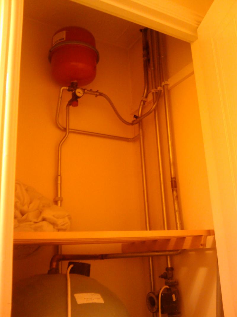

Hi,
We've recently purchased a property and noticed it has an 8 litre BOSS Expansion Vessel. Unfortunately, we didn't receive any paperwork about it, so we know very little.
Therefore, I was hoping someone here would be able to advise what pressure the vessel should be set at, or any other general user comments?
Thanks.

if it looks anything like this....
View media item 18779
your boiler has been converted to a sealed system, and exp vessel should be 0.8 to 1 bar
if you have an unvented hot water cylinder, refer to manufacturers instructions

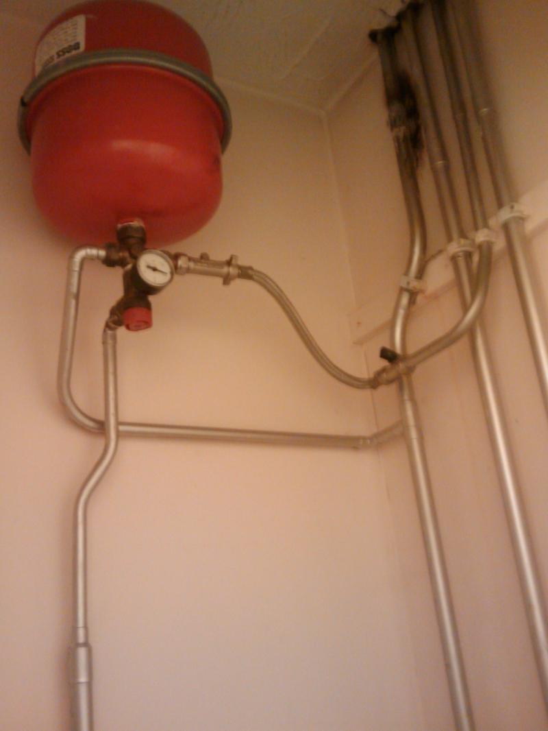

That looks like it, but I believe it's an 8 litre model.
How can I tell if it's an unvented hot water cylinder?
Thanks.
the gauge underneath the exp vessel should read between 1 and 1.5 bar cold
to the right of the gauge is a silver braided hose. follow the hose and it comes to a 1/4 turn black handled valve. this is mains water. you would turn the valve slowly until gauge reads between 1 and 1.5 bar
this water is being added to your central heating system (rads and pipework and cylinder htg coil as it is now pressurised. whatever comes out (air from bleeding rads and any small leaks and weeps) must be topped back up
if when central htg is running and the gauge pressure rises above 3 bar
a safety valve will lift and dump excess water to outside. if it does this the expansion vessel may need recharged using a bicycle pump to 0.8 bar
check all the FAQS at the top of the page for a detailed run through of how to do this

I think it's set to just below 1 bar now, so will increase it to about 1.25 bar and monitor it from there.
