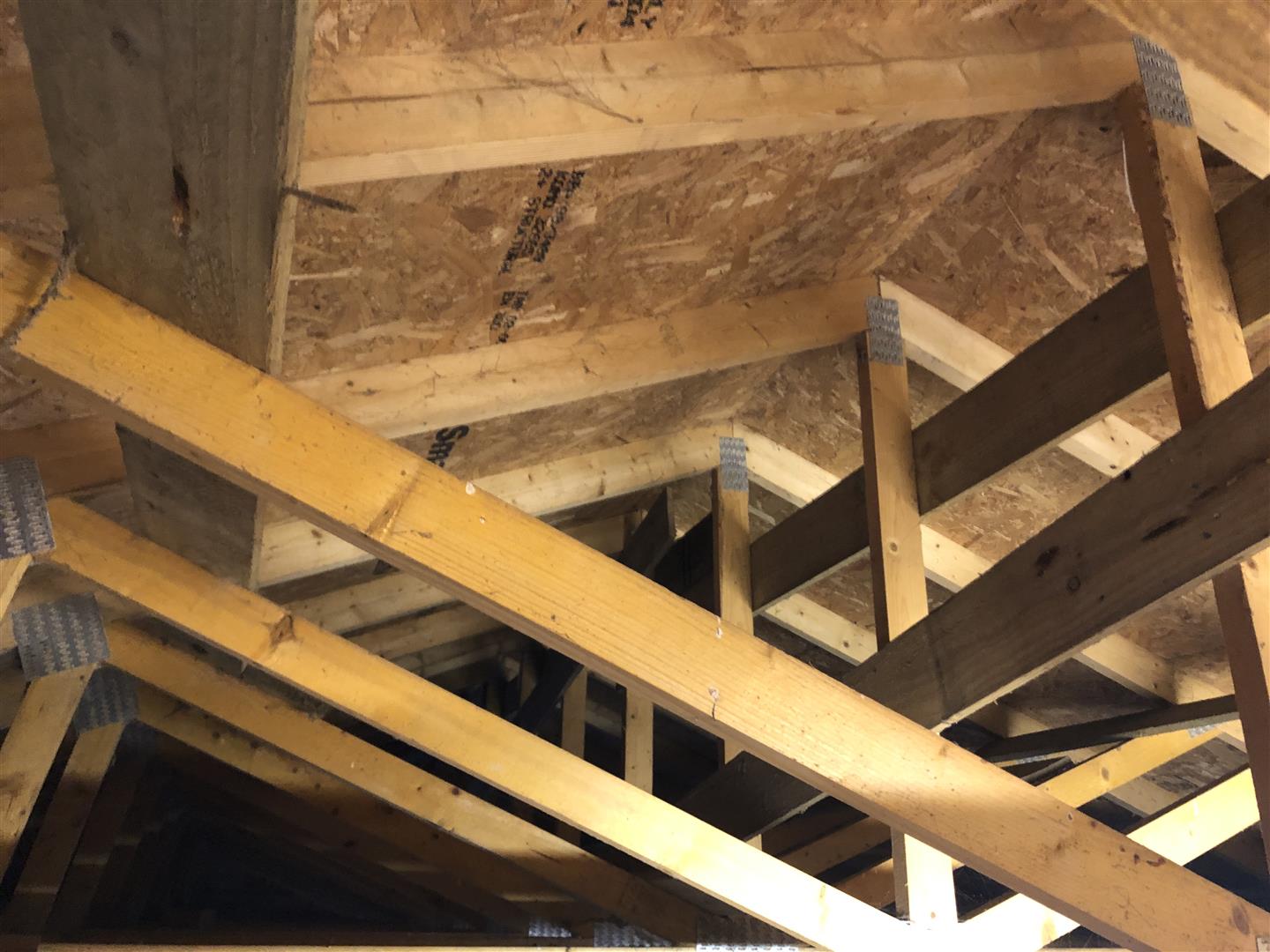

I have an disused outbuilding (approx 10m x 3m) which I'd like to turn into something useful like a workshop/office/gym/etc. The building has a truss roof and currently there is no internal ceiling i.e. the trusses are all exposed.
I could put a regular flat ceiling in, but the height would be pretty low and it would make the place feel cramped and boxy. So ideally I would like to leave the trusses exposed as a feature and fit plasterboard around them to create a vaulted ceiling effect.

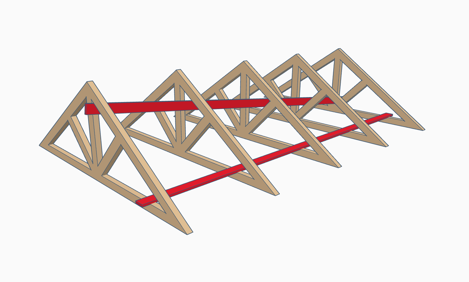

However, currently the trusses are strapped together (as they should be) with diagonal and longitudinal braces like this:
These braces would obviously get in the way of any attempts to create a nice vaulted ceiling, and they are very ugly to boot.
My question is: is it structurally safe to remove the braces if they are replaced by another rigid frame between the trusses?
Could I add sheets of OSB (or even regular framing timbers) between the trusses? Would this be enough to keep them rigid without the braces?

That's the way it's done in the USA. When trussed rafters started being used here they didn't realise the problem with racking without the boards. Early roofs didn't have the diagonal bracing.

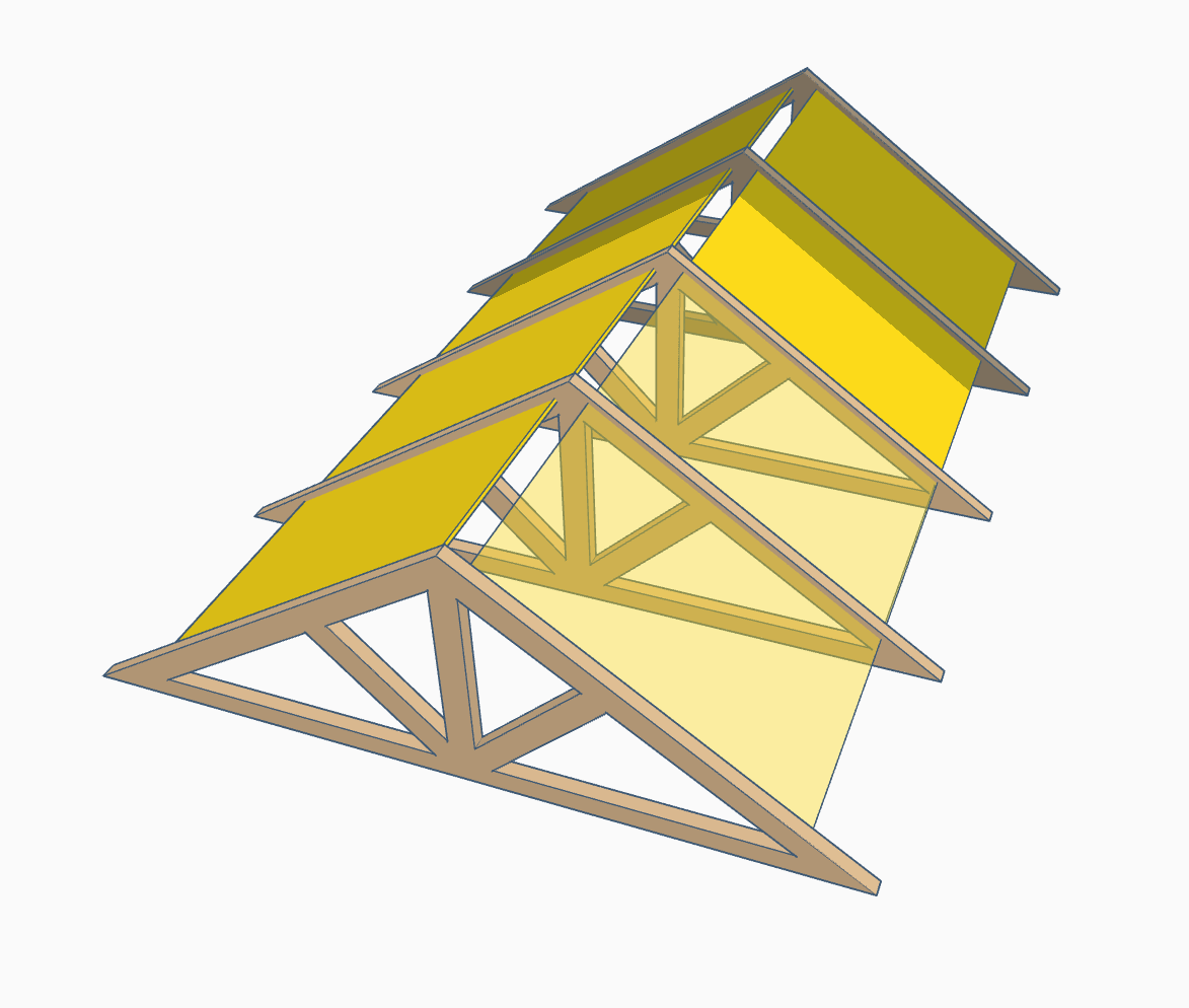

Edit: just found a relevant section in the NHBC standards:
  • diagonal and longitudinal bracing should be provided at rafter level (this may be omitted where rigid sarking boards are used, e.g. chipboard, plywood or OSB, which are fixed to each trussed rafter with 3mm x 50mm galvanised round wire nails at 200mm spacing)

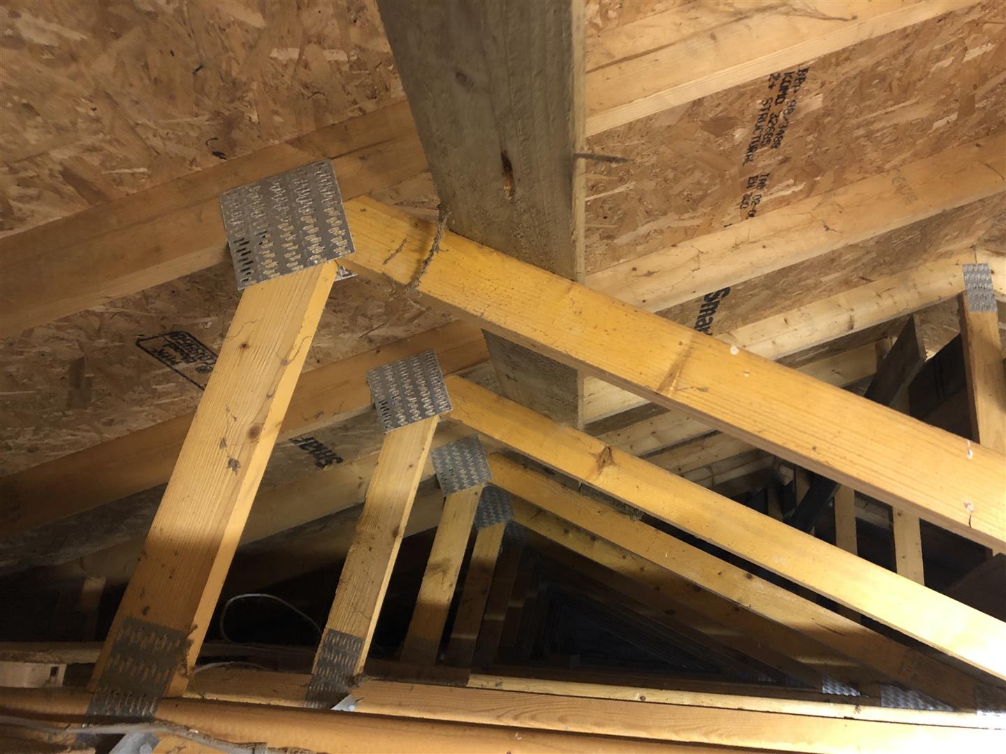

So it looks like OSB can be used instead of bracing, although presumably they would normally be fitted on the outside face of the trusses as per the discussion above. In my case, i.e. with an existing roof, I guess I'd have to find an equally strong way of securing boards between the trusses internally on the side faces of each truss, i.e. here:
Angle iron? Angle brackets? Some kind of channel fixing?
I'll consult a structural engineer if I decide to go ahead.
The concept is sound, but I doubt OSB can self support 1200mm

I wondered if I'd get away with self-supporting spans of OSB because it won't be under any real load since it's not supporting roof tiles etc. but you're probably right in that it's too much of a distance.
Instead of OSB could I use framing timbers beween the trusses to provide rigidity and then fix the plasterboard ceiling directly to those?
A roofer told me that the bracing is only needed during construction. Once the roof is smothered with battens, and especially if there are gable walls, it can't go anywhere.
No. There are many system builds from the 60s and 70s with no bracing and the whole roof moves sideways, opening the tile spacing, increasing/reducing the verge projection and pushing the gable out of plumb.

It would be the same principle for the plasterboard you proposed - that would need support battens.
So perhaps if you fitted a suitable number of say 4x2s that would support the plasterboard, they would also deal with bracing the trusses.
