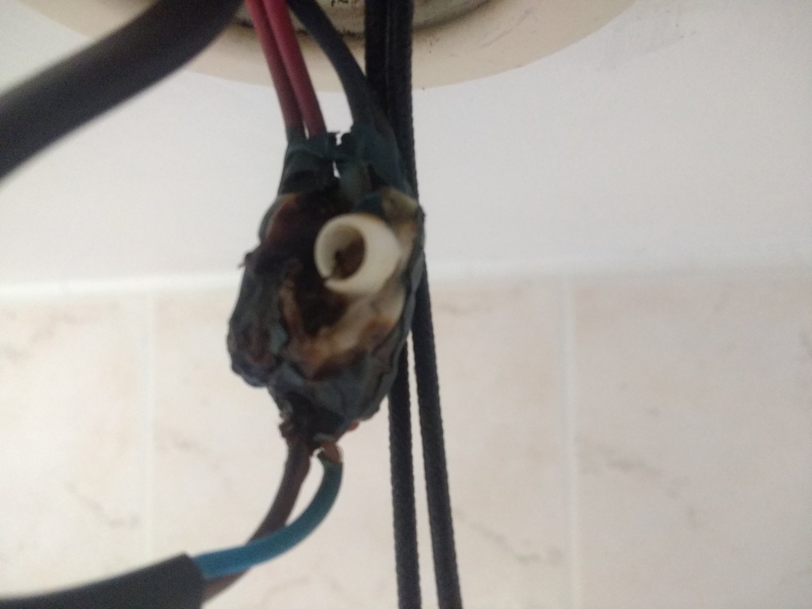

Finally got round to replacing a downlight in the bathroom! I noticed scorch marks on the bulb and on closer inspection it looks like there's exposed wires in the fitting which run in to a sticky blob that I presume is electrical tape. I can't get into the loft just now, but assuming I need to replace the faulty section of wire could I cut out the burnt section and rejoin using a connector strip or spliceline?

Those connectors could be used, but so could other types.
They all need to be inside an enclosure, and you should not have loft insulation piled over the light either.

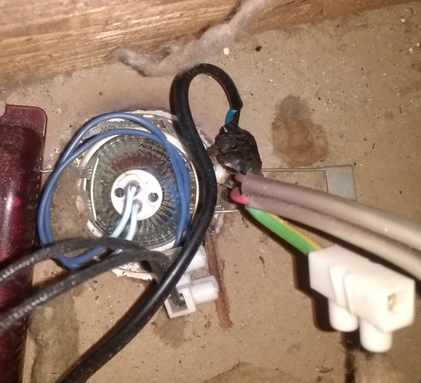

I got into the loft, looks like it's just an issue with this light, the rest look ok. For some reason only this lights terminal had electrical tape on it, which has melted.
Annoying l couldn't find an enclosed chocbox in b&q yesterday (only had 15amp ones left), wanted 30amp to be on safe side. Hopefully get one tomorrow and sort it, for now I'm not using the lights!

I already told you your light takes less than 10 amps and you have a 10 amp one. The wires will be too small to fit a 30 amp one safely.
As you can tell I'm no spark
I saw your comment about 10amp, but having read up some now I understand. The lights are 50v (6amp) so as you say, 10 amp should be fine.
