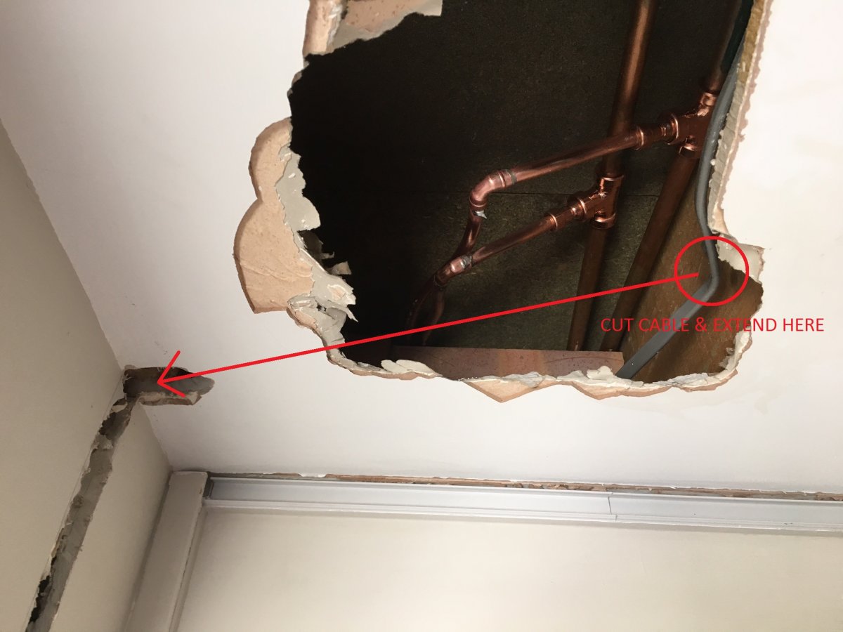

Hi,
I am having my internal kitchen/dining room wall removed and on either side there are plug sockets. I am going to remove the sockets and add one to part of the wall that will remain.
The only problem is the cables are not long enough. Am I OK to extend the cables using SpliceLine connectors and then place into a Wagobox? I have knocked holes into the kitchen ceiling to work on the cables. I have chipboard covering the floor upstairs making the cable joins inaccessible.
Please advise if this is the correct method for joining cables.
See the attached image. The joining cables will be moved well away from the copper pipe joints for safety.
Thanks in Advance.
A few of questions:
Are extending the ring final circuit to extend the ring keeping the integrity of it.Or just extending as a spur?
Are the joints you using compliant with that of an MF standard?
Can you as an alternative either extend the RFC from an exiting outlet or install one where the joint is going o be made?
Are you are aware of the requirements of cable routing and RCD protection?

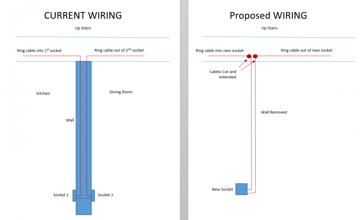

Thanks for the reply.
1) This will not be a spur but an extension of cable on the main ring. I currently have two sockets and will be moving to one
2) I believe SpliceLine connectors are the new method of connecting cables rather crimping so assume they are MF standard
3) Not really
4) Yes, it will be protected by a 32amp RCD in the fuse box
I have attached an image of the current wiring and what I am proposing. This is a view from the side
Do you have the BS of the connector you intend to use or a link to it? As this will confirm whether it does comply to BS 5733-MF.
Alternatively you could use the 222 and 773 Wago Series connectors, as I believe they do comply to the standards required.
I assume you mean the circuit is protected by 30mA RCD?
Also as the joint is going in to the wall and you are removing/relocating existing socket outlets, the existing and the new cable must still stay/be installed in the permitted safe zones.
//www.diynot.com/wiki/Electrics:walls
Also be aware that the extending of the circuit does still require a degree of inspection and testing and at least a minor works certificate to be issued.
Regrettably the product standard does not have the BS5733 mark, so I personally would not use it as an MF connector.
