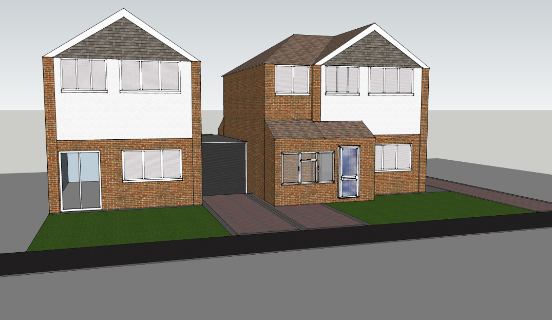

Pictures paint a thousand words (ours, after proposed extension, on the right):
Have you actually looked at your council's policies yet?
That design had no significant front set back either, and the new ridge line is not lower than the existing. These are common requirements.
And you are losing a garage and don't look to have enough room on the drive for a car. Off road parking is a planning issue.
I had originally planned a set back and a ridge line drop, however looking at the other houses that have extended on the street (the last one was 2011), none of them have set theirs back or even dropped the ridge line. I was surprised at this, as I'd read online these things usually cause refusals.
I've had another (better!) look online and I managed to find our council's 'residential design supplementary planning document' buried in their website ( http://www.tameside.gov.uk/planning/rds/spd/spd.pdf ). It's quite large, just going through it now. It has a long section on home extension policy - just what I was looking for I think.
I see what you mean about parking - that would only leave 4 metres of driveway, and the Mrs wouldn't want to convert the front garden into a car park. Might have to scale back or completely remove the front single storey extension.
