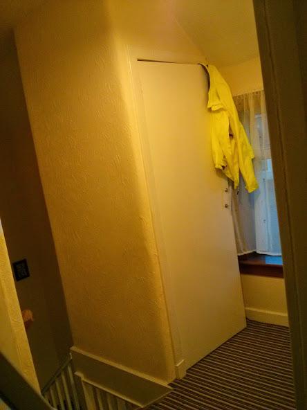

I've got a cupboard in the upstairs hall that I'd like to turn into a small bathroom. I'm planning on knocking away the wall (more just a door surround) with the door and then extend the remaining wall to run across the hall and incorporate a door frame.
What's the best way to do this... I can't really find much info or previous examples. Would it be better using bricks could I add a stud wall, given that space is at a premium here I could really do without widening the wall.
Here's a pic of it as it is now to make things clearer:
Bathroom? :eek:
You can re-model using stud walls, yes. I take it the walls in view are not doing any work in the loft space?
Well, shower room, not bathroom. I've had a fitter look at it who is going to do the actual work but was going to prepare the space myself to save some money - how do you tie a stud wall in to the brick work, would it not be wider than the original wall?
