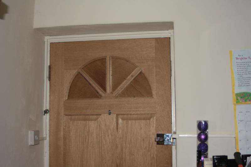

hi everyone,
We need to move our hall switch about 1m towards the door. This switch also controls the landing light too.
Now looking at the cables i have the following
Cable 1 Red, Black (got red tape on it), Earth
Cable 2 Red, Red, Black (again red tape)
Now one of the red cables of cable 2 is infact the earth cable and the put red sleeving over it.
Cable 2 then goes up to the landing light switch.
Now got the floorboards up and found the 2 light cables that go into the hall light switch
Normally if i was extending a light i would just use a JB and extend the cable to where i would need it.
But is using another piece of t&e as a switch cable acceptable of do i need to go and buy couple meters of lighting cable, or 3 core and earth?
And if i need 3 core and earth what is the best way to wire this up?
http://www.tlc-direct.co.uk/Products/CA1BR.html
any advice would be great
Whoever did that was a ***t; it is not allowed.
So you really should replace this misused length of T&E with some 3-core & E between the 2 switches. That's doubled the job nicely!
If you extend cables with Junction boxes, they must be accessible, and hidden under floorboards isn't accessible, so it may be better to replace the cable between the luminaire and the hallway switch as well so you don't have to join cables.
You must also make sure that buried cables remain in safe zones defined by the new switch position, so no 'L' shapes allowed: always better to run the cables vertically to the switches.

Please supply a picture of the wiring behind the switch
echoes is right, the cpc (the uninsulated conductor in the middle) must only ever be used as an earth connection. Never, ever as a live conductor.
You'll need to pull in a whole length of 3 core & earth to wherever that cable goes to.
To add to the comments above. The three core and earth cable - it doesn't matter which terminal they go in as long as they are the same at each switch. For example I always put the brown in the common, the grey (with brown sleeving) to L1 and the black (with brown sleeving) to L2.
Check out how the upstairs switch is wired since I am assuming that the power is fed to this switch and then on strappers to the downstairs hall switch.
Normally switches are wired red to common and black to L1 for single way situations - for the two way(upstairs landing switch) I move the red to L1 and the black (with red sleeving) to L2
Don't forget the cpcs.
Thanks everyone.
Will now replace the whole length of cable from switch to switch with 3 core & e.
