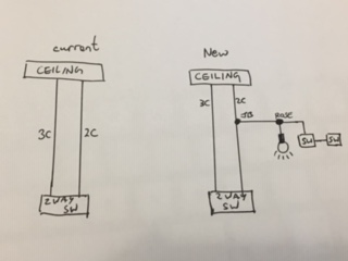

Hi,
I'd like to add a new 2-way ceiling light underneath where a RSJ is installed and double plasterboarded.
i need to form a new junction box from a cable connecting to a 2 way switch because of concrete ceiling. Current lighring circuit has no CPC, how should I go about it with with new cable? remove CPC from new cable? or connects CPC to another CPC in nearest socket?
No CPC = cannot be extended.
How old is the existing circuit, and are you 100% sure it has no CPC? What type of wiring is it?
Oh bummer! really!? :(
It really has no CPC. It was done in the 1966 when the building was built, and the wiring was red (live) and white (presumably neutral) for the lighting circuit.
Look like I'm gonna have to spur off from a socket. Is that the same as fused spur forming a new socket?
On second thought, Can I run a new cable to CU? I had an EICR done and the existing cables are all fine. I'm having a new CU in few month time, if that's ok then I can just lay the cable first.
