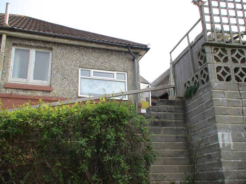

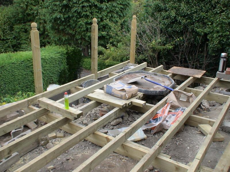

Last year I built a L shaped decking, 20 feet has a width of 10ft and other 10ft is 13 feet wide.
My garden's level is 7ft lower than the decking.
I want to extend the narrow part to make the whole deck 13ft wide. the garden end of the Beams are sitting(fixed) on the wall made of conrete blocks.
My question is can I rest the new beam on brackets made of 4"x2" which would be bolted to the wall in 3ft intervals in order to support the joists which have to be extended by at least 3ft?

if im reading this right your going to extends the decking out into mid air from where it is at the moment? are you looking to do this without vertical posts to support it at the edge?
I was thinking of using 4 brackets (horizontal par3' 6" and the perpendicular part 5' fixed to the wall and then use a timber to connect the ends by aid of steel plates). One end of the beam will rest on the wall and the other end on one of the above brackets. I can use a post to increase the support on the end bracket. Then I will extend the joists to sit on the beam. Do you think it will work?
can you do a sketch? to be honest wether i think it will work is not the point, it needs to, so it might be best to get an engineer to look at it
Sounds like a right pavlova, compared to just getting some 4x4 posts concreted in down below, then braced at all angles.
The best advice you've been given thus far is to get an engineer to take a look.
Due to the height of the decking surface and the fact that you are not proposing to use posts in the more usual way you need someone to do loading calculations for you based on your proposed solution.
