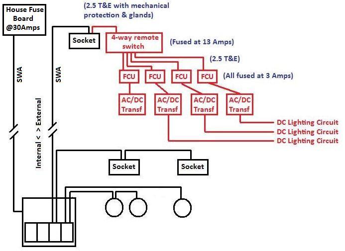

Sorry for the delay in getting back to you. Managed to take a look at the garage circuitry which is attached in the diagram.
What I don't know is exactly how (or where) the SWA to the external socket is joined with the 2.5 T&E internal garage circuit. I only know that they run off the same breaker, and I'm reluctant to go poking around or taking the board off the wall unless necessary.
The red sections represent my proposed extension to the circuit.

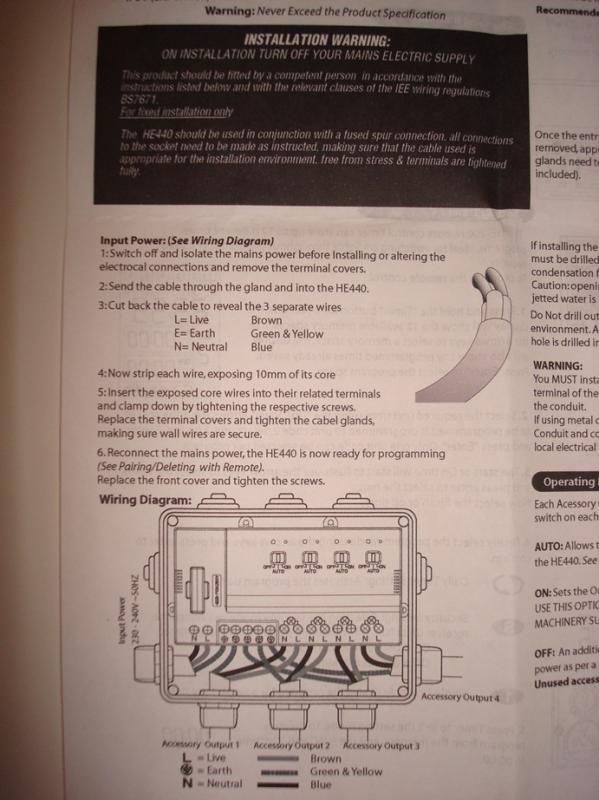

That's what I had assumed when I bought the product, however, looking at the instructions, it seems to indicate that there is merely a single fuse (at 13A) which I assume is there to protect the switching device, rather than any connected accessories.
The instructions suggest that the device should be used in conjunction with a fused spur connection (see black box in picture), but does not indicate anything more than that.
I am therefore assuming that each connected accessory (in this case AC/DC transformers) should be protected with an FCU rated to the accessory's requirements. All of that would be protected in the same IP-rated enclosure. Each DC circuit will not exceed 150w if using traditional lamps, 50w if using LEDs.
Is what I'm proposing correct (although I suspect I might be panned for the mechanical protection)?

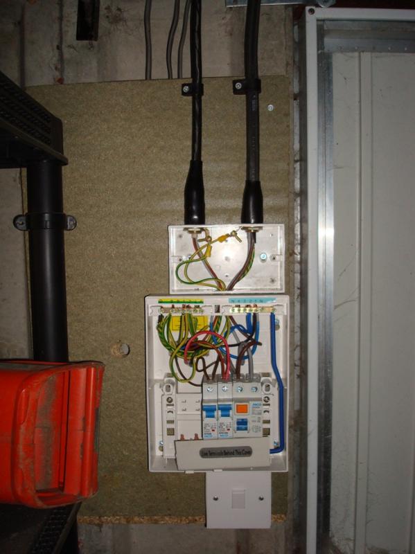

I would assume the SWA is connected via one of the socket outlets in the garage. If you power down the circuit, you could investigate within the outlets.

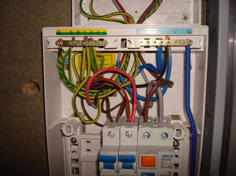

Nope, just powered down the whole house and took the breaker box apart.
SWA to external socket is connected to the same terminal in the breaker box as the garage sockets circuit. Pictures should explain.
SWA on left of shot is to external socket. SWA on right of shot is from house fuse box.
Sockets circuit is the right-hand breaker. Lighting circuit is left-hand breaker. Oh, there's actually two 1.5 T&E that feed different lights. One feeds the internal fluorescent strips, and the other a low-wattage security light (so my diagram was wrong on the lighting circuit (amended the diagram to be correct)).

Based on the socket circuit diagram I've provided, will it merely be a case of taking a short feed in conduit and glands from the socket to the switch box?
Thanks,
W
So fit a 16A mcb in the third slot in the breaker box (essentially giving a dedicated external circuit) and keep the internal sockets on the existing mcb?
