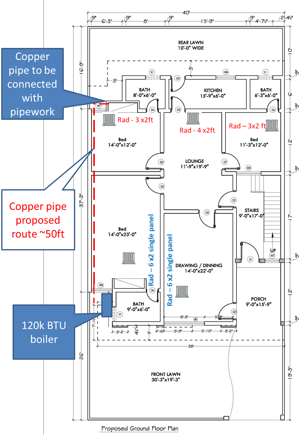

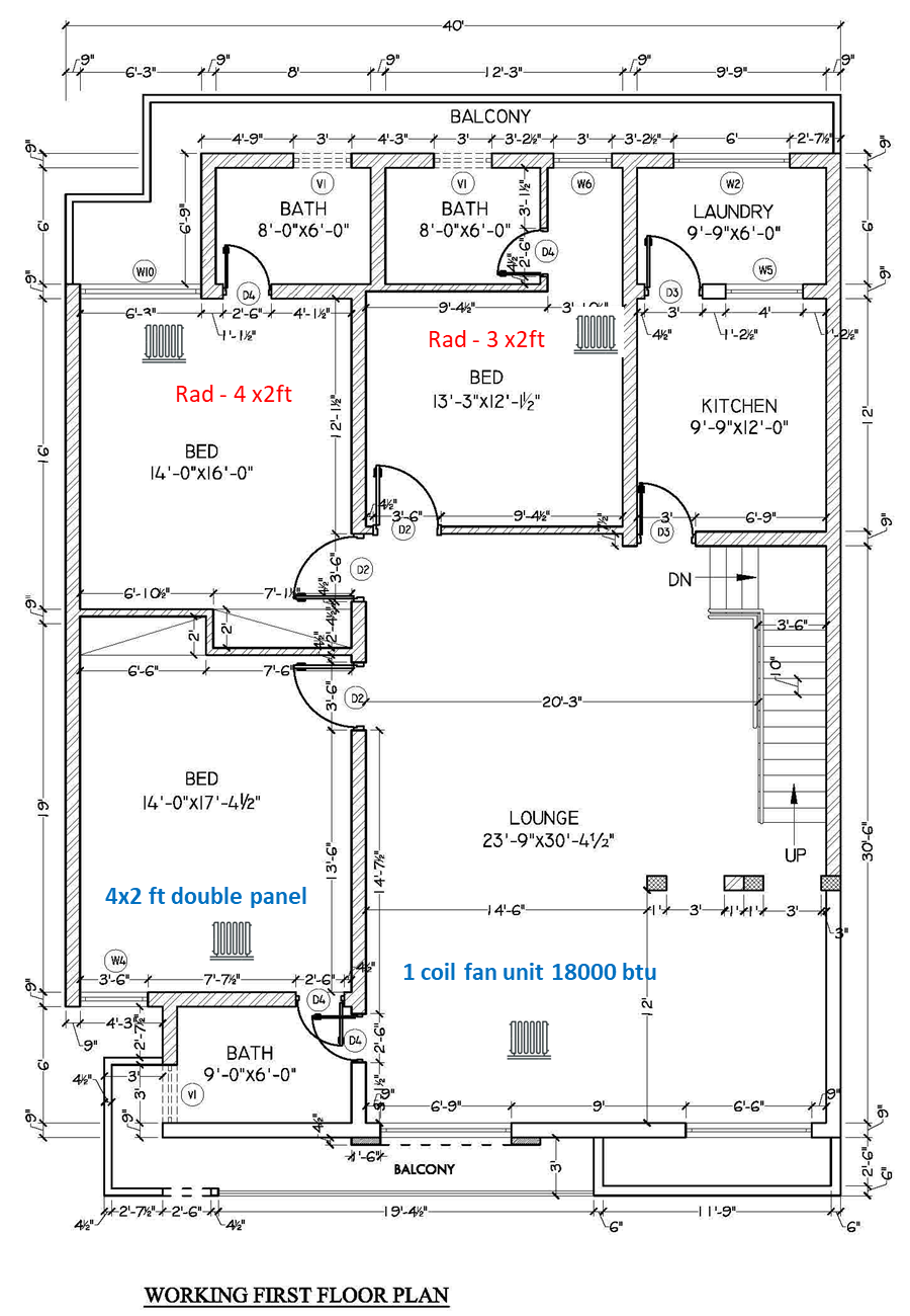

See attached files; Picture 1 - Ground floor layout, Picture 2 - First floor layout:
1. Location of boiler on Ground floor
2. Proposed pipework extension - 50ft length copper pipe on ground floor
3. Radiators in (red font) to be served after extending proposed pipework; Radiators (in blue font) are being served by bigger boiler which is heavily undersized.
4. 3 radiators on ground floor with sizes (red font); similar setup on First floor (smaller radiators)
5. After extending pipework 1 boiler will cater for whole house comprising of 11 radiators.
I have calculated the required btu output of 11 radiators and is within range of boiler.
The work will be carried out by a plumber but I need to plan this properly as skilled folks are difficult to find where I live. Thanks for all your help and guidance.

Under your avatar it says you are in Pakistan. I'm just intrigued about what the climate is like and the construction of your house. Naively, I've always imagined it being very hot, but I've just read that there are extremes.
P.S. Did you mean 3200 sq ft in your OP?

I have used him on some other plumbing work elsewhere and he seems reasonable. He will insulate the proposed 22mm pipes.
No zoning or other control gear, no TRVs installed. Its a simple 'plain vanilla' system with no bells and whistle of modern heating.
I inherited the system and I am fine tuning it after recent gas price hikes. Thanks again for your guidance and help.
