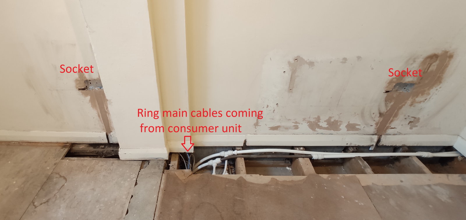

Hi all,
Trying to add two new sockets and having hard time deciding from where to extend the ring main. There is a socket to the right but I can't quite find where it goes and there is no real way to check without ripping into the wall and there is nothing underneath so it means it runs up which would be a huge pain to run the cable down again.
Can I cut directly into the ring main cables coming from the consumer unit and extend the ring main using 30 amp junction boxes?
Cheers.

Yes assuming you're competent to do the work and ideally test the circuit before and after. The junction boxes you mention would need to be Maintenance Free ones not just those basic screw terminal ones as they come loose over time. They need to be rated a minimum of 20A.
Keep an eye on the overall ring length if its a big house it might be close to the limit.
To extend the ring final start point is at centre of ring measure the loop impedance, the loop impedance is what often limits a ring final length, the other is volt drop, we get the figure of 106 meters of 2.5 mm² cable but that is depending on design figures used, close to the consumer unit one can over load a ring final.
In theory you can break in where ever you want as long as either accessible or using maintenance free JB. It is important to test and inspect it is so easy for a ring to be in error split into two radials and since it would still work, but could be over loaded, testing is required. Traditionally 1.44Ω was limit, now 1.37Ω but the cheap plug in testers with loop test normally have lowest pass point at 1.5Ω so to test means test gear costing £100 plus so in real terms not work doing as DIY.

A better option would be to remove one of the existing cables from the consumer unit and route that to one of the new sockets, then add a cable from there to the other socket, and another piece from there back to the consumer unit. No junction boxes required.

Did you not see the pic John where the backboxes are already fitted.
Whoops - looked too quickly and thought the grooves were plaster.
He could break into both ring cables locally and add one spur to a socket to each side of the loop - assuming both cables are there. It's then effectively still a loop.
As flameport has said, the only proper way to do this is to pull back one of the legs and actually extend the ring. Junction boxes should be avoided unless there really is no other option. Spurs are also not good especially as you’ve got the opportunity to do the job properly.
Also whoever cut through your skirting board to install those socket boxes wants to be taken outside and shot.

As the photo identifies a wire to the consumer unit suggesting no connections off it the OP may be able to use it to pull a new length cable through. Might be a better option to attach something like this to it and pull that through first. ;) The screwfix equiv didn't google but I assume they have similar First test would be that the cable can be pulled a little at each end without loosing it.

Thank you everyone for your responses, really useful tips and information. I think I'll go with the removing one of the ends from consumer unit and taking it to the socket and then returning the other end from the other socket to the unit after. This way no cutting out junction boxes would be required :)
