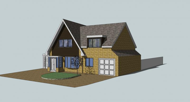

To give you some idea, this is my house now and we were planning on demolishing the garage and building the extension there:
View media item 50058
And this is the kind of extension I had imagined:
View media item 62480
Cheers
Andy

Here is a quick image of a similar thing I did quite a few years ago. The two pitches were different, and the front wall was taken up as you suggest, to cill height. I went for a cut roof and there was a steel ridge beam.
Hi Woody,
Yes that's the type of thing that's been designed - but with a 17 degree pitch on the roof.
Ok I see, the roof wouldn't actually be made of trusses but purlins and a ridge beam - I wasn't aware of that sort of configuration before.
I guess that this type of work is again going to increase the costs over trusses because I assume the ridge beam RSJ is going to have to extend all the way across the ridge of the extension and half the width of the original house in order to meet up with the original ridge line (around 9m) and I assume that a gable wall is going to have to be build on top of the existing outside wall of the original house in order to provide support to the rsj and roof.

You do not need a steel ridge beam on a cut roof if the base of the triangle is formed by the ceiling/floor joists. I have just done an extension and the difference in cost between trusses or cut is negligible. (there is less timber in a cut roof). The only problem for either type is that if hips or valleys are involved then you may have a problem finding a carpenter to cut it.
True, but the point is that the masonry is one and a half storeys, so the rafters would be high above the first floor joists, and there would only be nominal tying from the ceiling joists.
It should be possible to rest the ridge beam on the existing gable wall. It's possible further steel might be desirable to support dormer walls, or what would otherwise be very long joist spans.
Thanks Maltaron, there are hips on the roof and as Roony mentions the floor joists are separated from the roof by about a metre of masonary.
As the ridge beam of the extension would be at 90 degrees to the existing roof there isn't an existing gable wall where the extension meets the house.
I appreciate you're at a disadvantage as you can't see the drawings, but I don't think it's right for me to post them publicly without permission.
You could still support a ridge beam off a post supported on the flank wall.
The ridge beam doesn't need to go all the way to the existing roof, as the rest of the rafters could be supported on valley boards with a ridge board at the apex.
