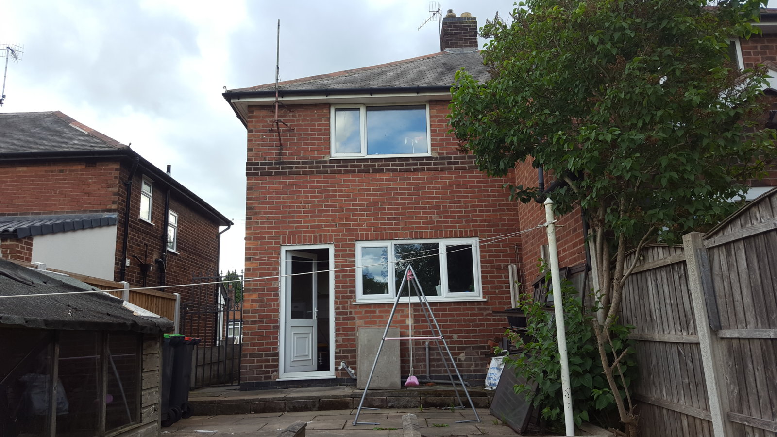

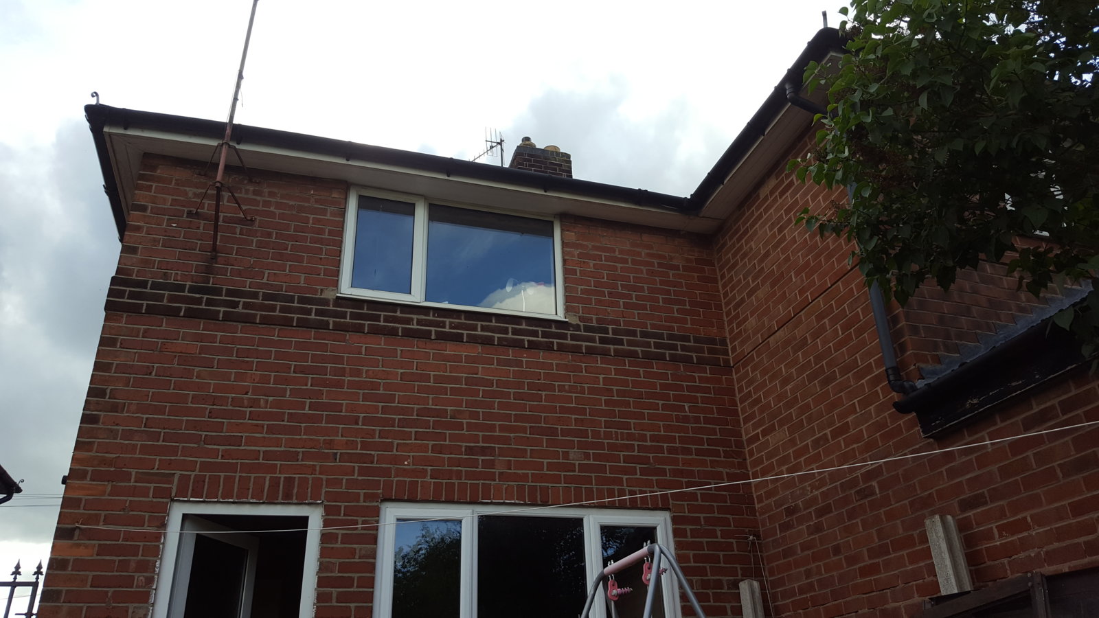

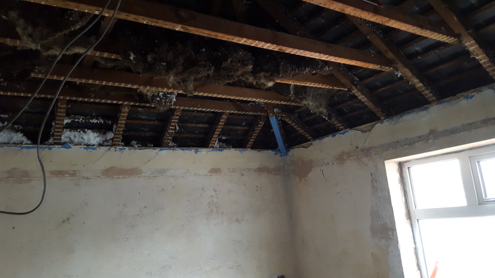

I am looking to extend my 1930 semi detached house and I'm just deciding to either extend single storey or double. The reason is that the roof of the existing house is causing the dilemma. Basically the existing house has a hipped roof and the last part of the roof cuts into the top bedroom where it meets the eaves (see picture attached as i do not know the name of this type of roof where it essentially cuts into the room). This lowers the ceiling height from 2.4m to 2.05m. So if we added in a doorframe to lead into the new extension on the first floor it would look strange (as the top of the doorframe would be almost at ceiling height).

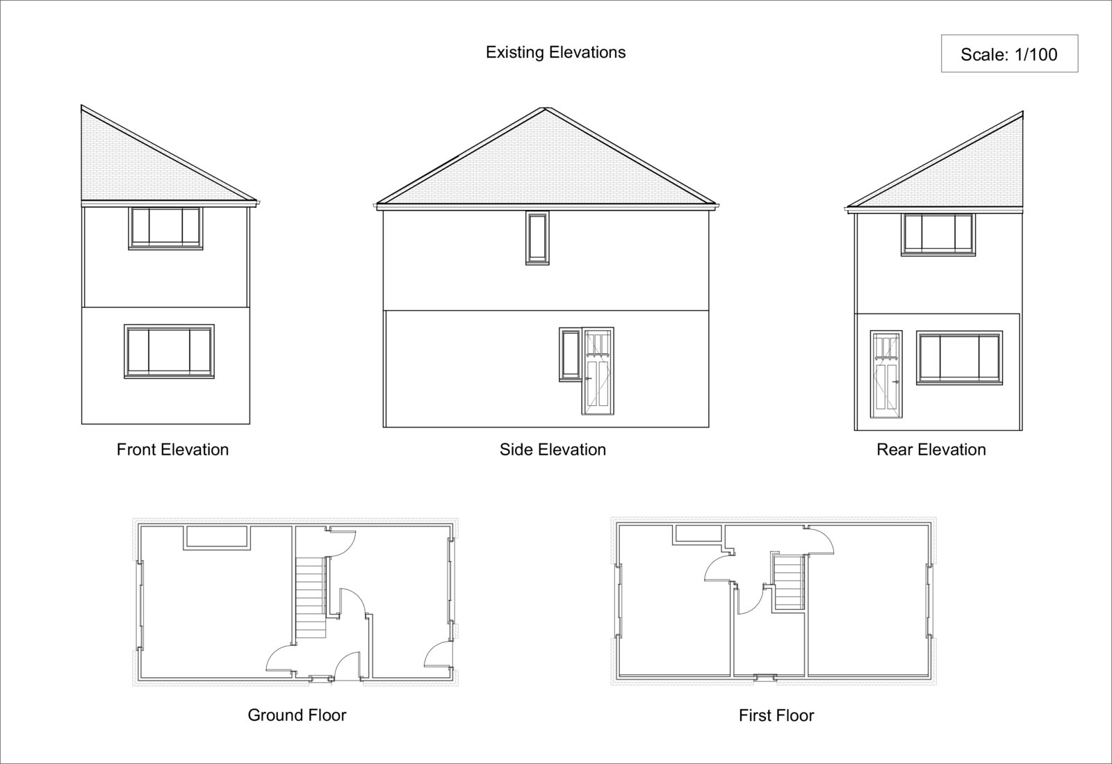

Existing plan

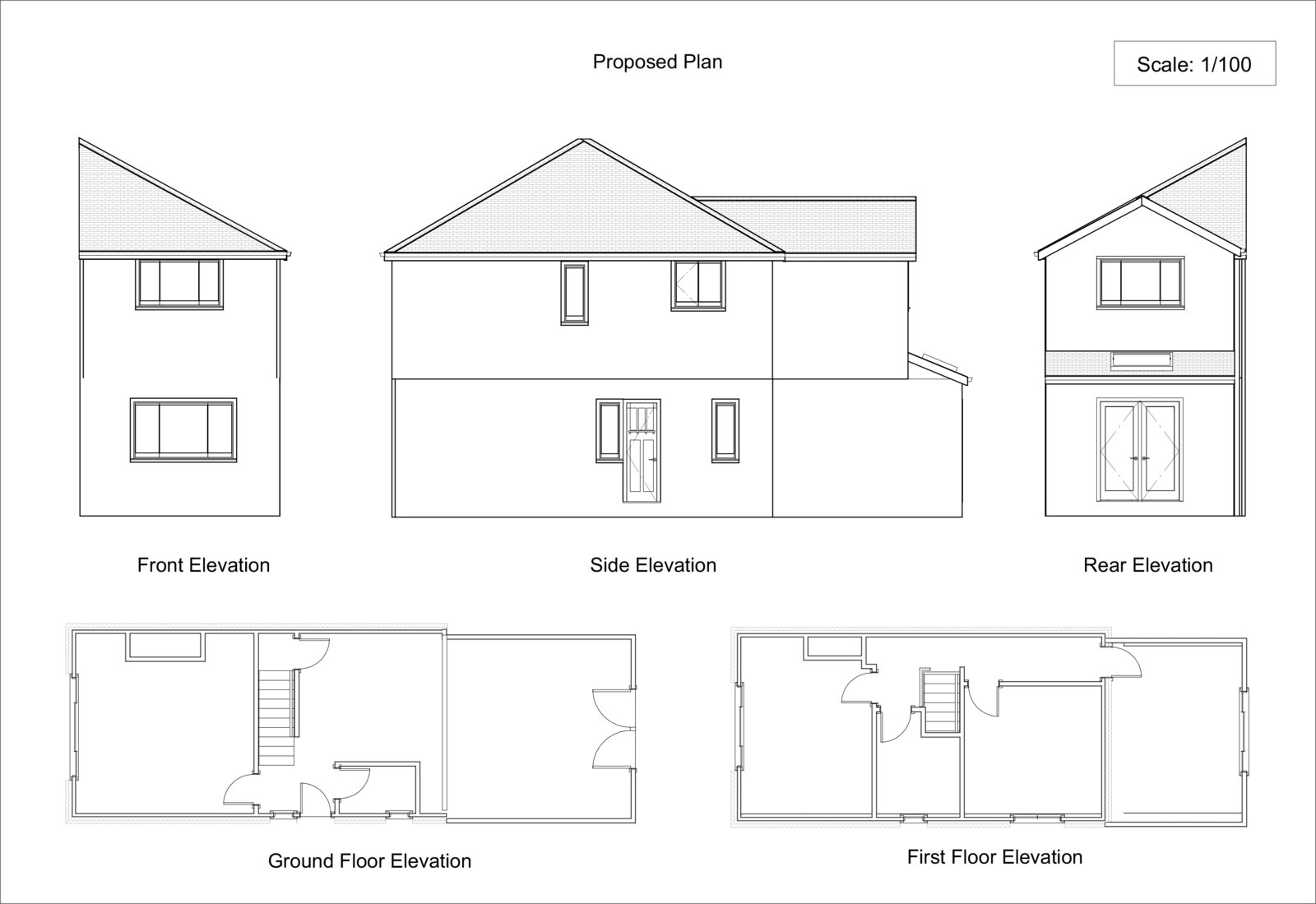

proposed idea 1

If you carried the roof over as it was then you could have a full height door anywhere but in the corners buy building the wall up. You might build it up anyway to hold your new ridge beam.
You're confused? So am I.
Just mimick the existing lines and levels, and put the extension ceiling higher than the wall plate. You will find that the new walls are thicker so the wall plate is higher anyway, so you get less of the angled ceiling. Bear in lind the roof timber sections will be deeper than the existing ones so this could affect the plate height too
Draw a section view of both walls (existing and new) at the eaves and you will see. The reference point will be the top of the rafters, so adjsut the plate and ceiling height accordingly.
You most certainly wont get your detached roof idea through planning, but its not necessary anyway.

thanks for the replies, I assume that the plan i have is probably the best option. I was just thinking that the roof seemed very large for just a small extension. I'll go an draw the section view of both walls at the eaves and from this estimate the cost etc.
