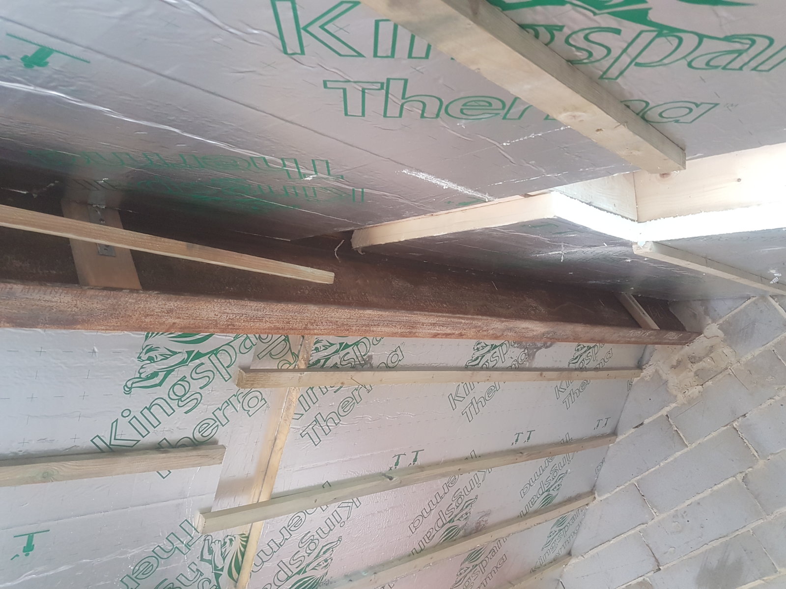

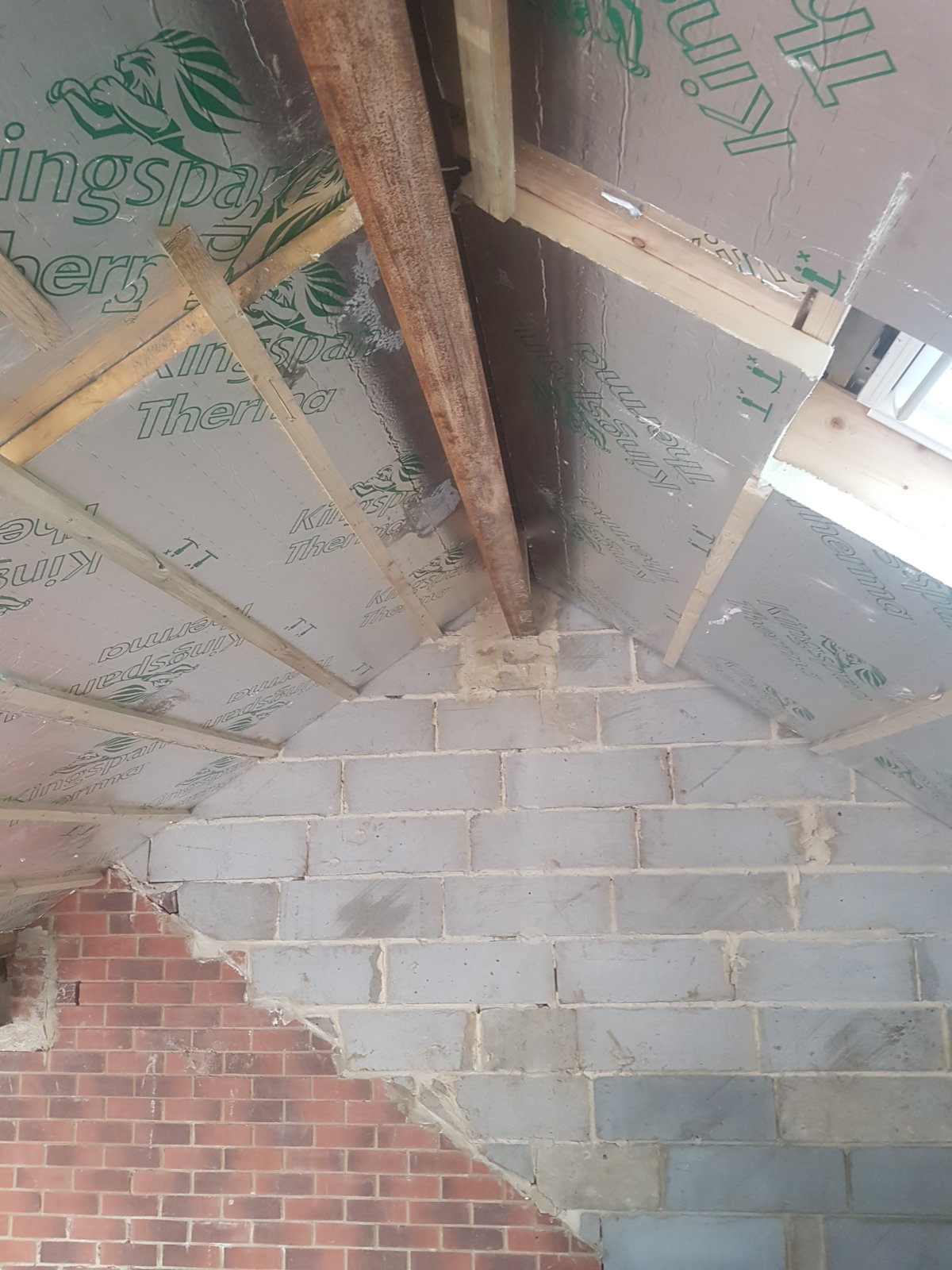

I am about to screed my extension floor and need some lighting for the long days ahead.
It has a high vaulted ceiling I was thinking of running the cable through where the steel beam is and then dropping down.
I have put wooden battens across to attach plasterboard at some point. Would I just run the cable up the wall edge and saw some batten off or just run under batten and cover later? What best way?
When I dropping light cables from steel beam would I need to just notch out some batten as cable with be perpendicular to batten
Attach pics for idea. Just looking for best practice so it doesn't need redoing later.
Joiner has put some 4" x 2" in between the steel to attach straps to. Should I clip to this?

Thanks for the response. Right so build the work is notifiable under building control. I am basically doing what I can until I can get builders back for some joinery and electrical work. Screeding the floor is a job I am doing next. It will involve working late into the night so I was wanting to add some lights so i can see what im doing and get things level! The lights will be temporary really but rather than just lash in the cable i thought if it was done some where near right the person doing the work will not have to redo it and I won't have made a mess.
The steel beam is the big Brown thing in the picture at the top that the trusses sit on.
Maybe I'll just clip some wire where i can and it can be removed afterwards. It's just two or three lights.

I have a similar roof, I made a wood batten frame around the beam and covered in two layers of plasterboard.
Light cables were running along the beam and simply dropped down where it was needed.
Top of roof was just under 4m, presume yours is similar.

That's exactly what I was thinking of doing. I will obviously leave PB off until it's been given the OK inspected etc just seemed sensible to use this space and it's sturdy to get clips, galv straps and whatever else is needed.
Yeah roof a bit higher than yours but principle is the same.
