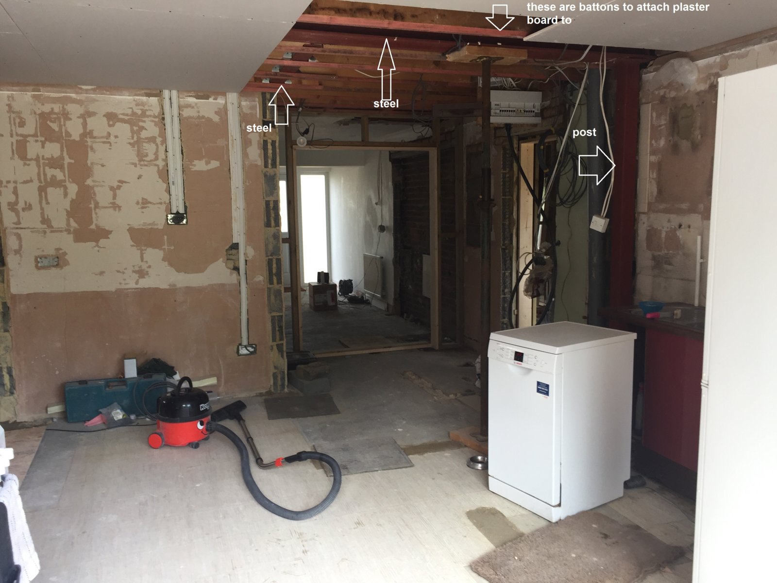

This is area where the steel went in. The floor above this is where it bounces

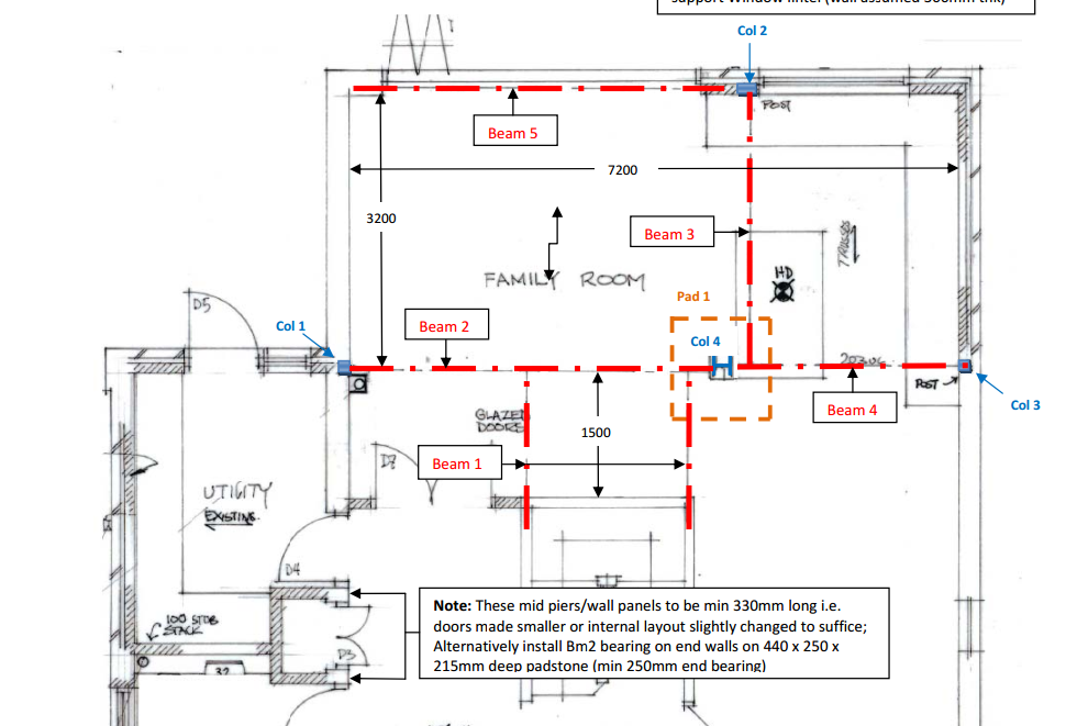

the detail of the steels an joists are not clear.but its now all concealed?
pleasepost more photos showing the sub-floor above the lintelwhere it meets the skirtin.

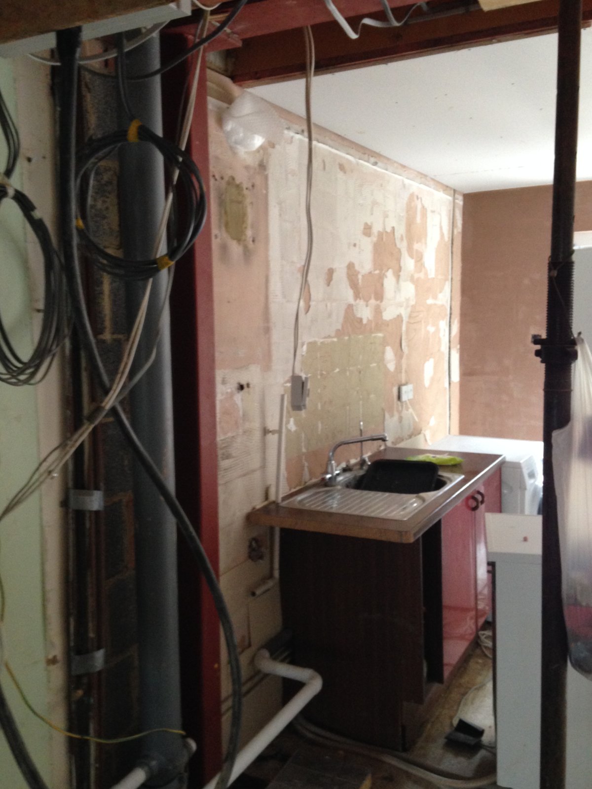

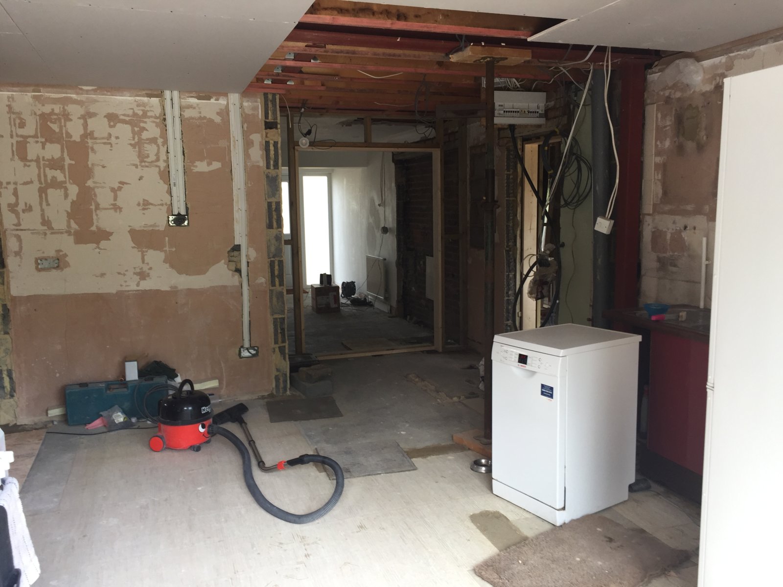

yes everything is now concealed in the kitchen - but we did take some photos just before !
The kitchen photos are attached, its the bedroom area above these steels that seems to bounce.

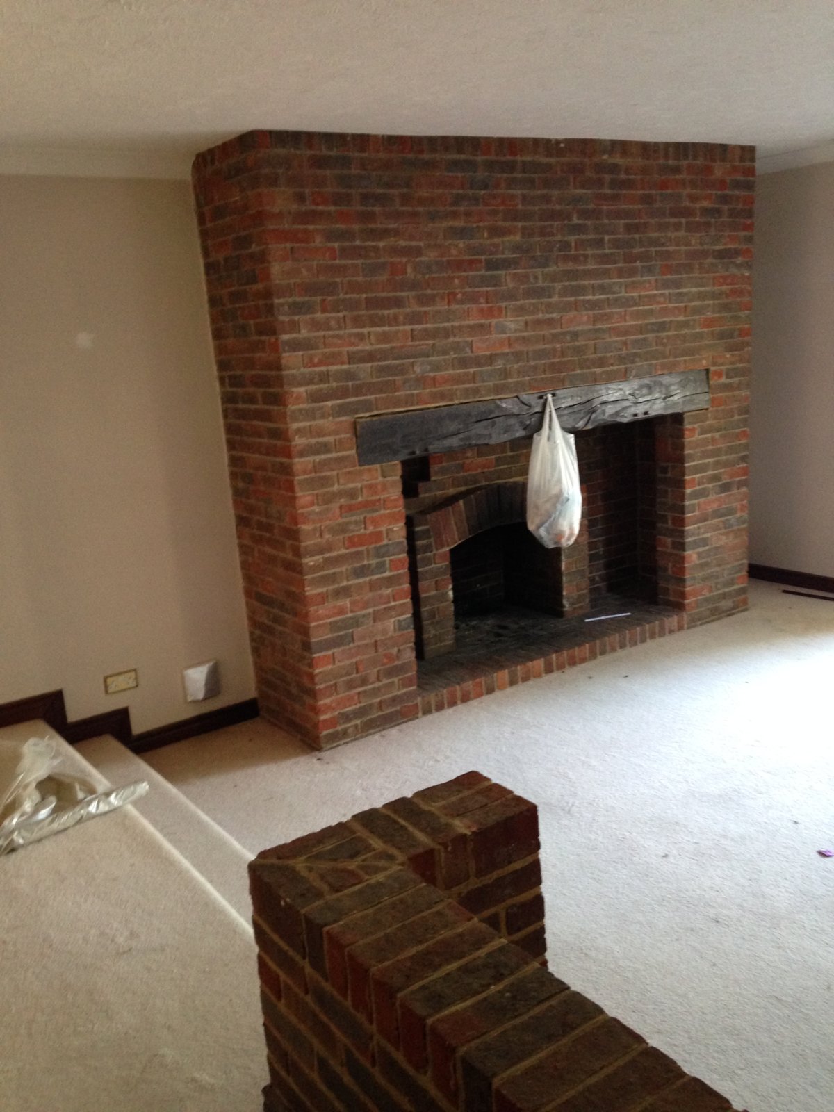

The lounge they inserted what we call strong boys to hold it up while the lintels were removed. They then put a new lintel in, then raised the window and then removed the strong boy. This part of the floor above the window actually seems fine - it was bouncy during the work - but once the lintel went in it went solid. There is one very small fine crack 2 inches max in the plaster just above the skirting board in this bedroom.
Its more the middle of the room above the lounge that now bounces and causes downstairs to rattle. The sunken lounge floor was raised 3 bricks in height using wooden beams and chipboard flooring. This seems ok. The large brick chimney breast was removed but i believe this was decorative only.

Not possible to tell from your pics where the problem lies.
Unfortunately, Building Control are unlikely to be concerned about the floor bouncing (unless the joists are under-sized and the
deflection causes cracking in the ceiling below) as they are only supposed to interpret the Building Regulations in so far as they affect health or safety;
a vibrating/bouncing floor is not generally dangerous - though agreed it will be very annoying.
Thanks for the reply Tony. I agree building control will says its safe but we cant live with the annoyance and i think would be hard to resell! The builder thinks its just the span of the joists as the wall below was removed and nothing now supports them. The steels apparnetly pick up walls above and not any help with the joists. They have suggested a fitch beam is put in by chopping out some bricks and sliding it in. Not sure how this is done but thinks this will fix the problem. They can do this from above / outside without taking down the ceiling.
