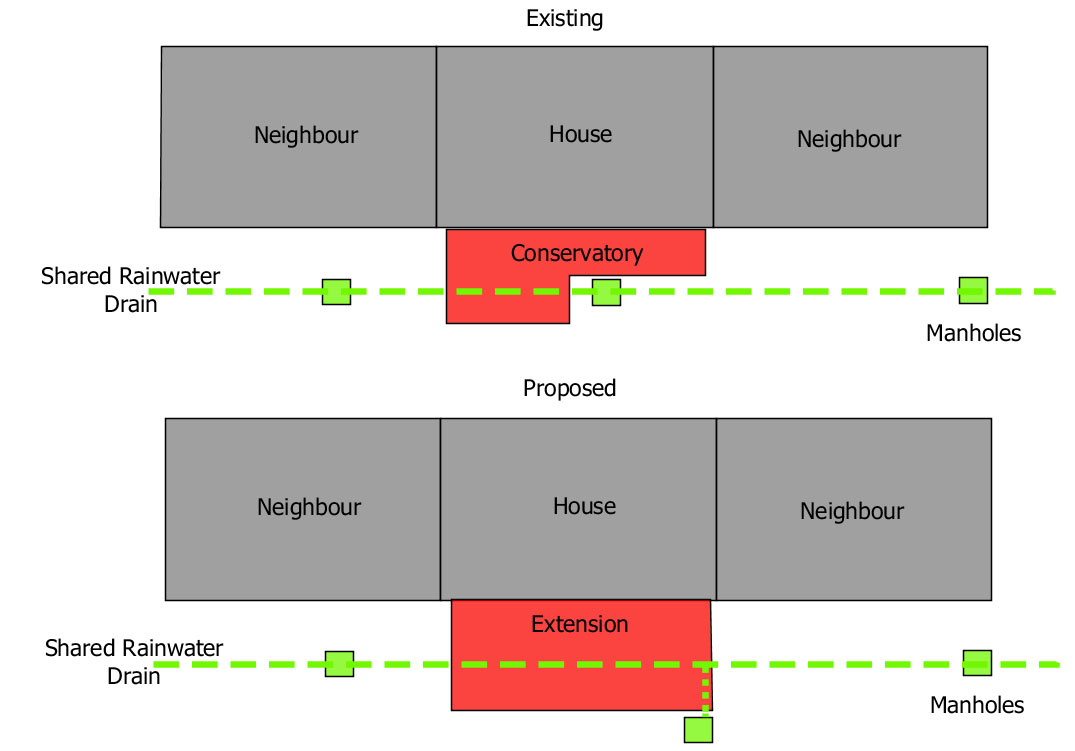

Hi,
I'm thinking of changing my conservatory into an extension.
To do this the rainwater drains/manhole at the back of the property would be covered. I have attached some sketches to show their location now and when covered.
The water authority have no knowledge of these drains (conversation on phone), but they are communal as two houses upstream use them too.
Am I going to be able to build over these drains or am I wasting my time with an extension? Will building control still insist on a build over agreement even with the drains unregistered?
I'm thinking total removal of current manhole and join pipe together. Relocate house and extension gutter drain to the right side of the house. Build a new manhole to the right of new extension that feeds back under the foundation into the existing drain. Neighbours manholes are approx 10m each way if rodding is required....
Yes building control will insist on a buikd over agreement. Anyway the risks of building over an adopted drain are not worth it......you could be forced to remove extension. Or if you sell....you will beed a build over that may not be granted.
Yds you should get a build over agreement in your situation. Check with your water authority to find out costs. I reckon its worth getting tge buildover agreement before paying out for building regs drawings -although a good architect should be able to advise on possibilities.

You can aplly for a build over fir your new extension -you can do it yourself, although you will need to put the correct technical info on the drawing.
Bear in mind foundation will need to 150mm deeper than invert level -so if your drain is 1500mm down, founds will be 1650mm
Looking at the image drawing, what exactly is that new IC location supposed to be doing? You do realise that the reason the IC is there presently is so that the connections from your house onto the sewer are roddable?
I assumed it would be needed so the connection from my house to the drain would still be roddable? There will be nothing connected to the original manhole once its covered over..
Currently the rainwater drain from the roof comes down and over the conservatory at the middle of the house via a downpipe - I would move it so its over the right hand side, either via a downpipe or pours onto the extension roof?
Yes, but putting an IC in that position isn't going to achieve diddly. You will either need to leave the IC where it is and fit a double seal screw down lid, allow for a rodding eye further upstream but still on your property or do away with the IC altogether (re-hash the IC into a 'y' connection) and then rely upon your neighbours access for rodding (contentious).
I would make the current IC into a straight pipe as nothing needs to get into it, then have a Y connection further down with an IC outside the footings for rodding my connection to the drain and downstream?
If I go full width on my extension there will be no room for a rodding eye unfortunately ... im sure the neighbours upstream would be OK with it being rodded from their houses as if its blocked it will effect them not me? Or does this sound totally unreasonable?
It's not up the building contol, its up to the water authority, and you need to speak with them first as each will have their own specific policies.
You certainly wont be permitted to do what you have drawn in that proposed sketch.

So after some research southern water do not allow a manhole to be inside the floorplan.
I will probably need to make the extension smaller on one side to accommodate an access point and run the extension and house roof water in.
So the question is how much room do I need to leave? Will I require a full sized manhole or just an inspection chamber/rod point?
Normal practice is for you to concrete over existing manhole and have an inspection chamber outside (that is roddable).
I'm doing the same thing after getting a Thames Water Agreement, they too stated no manhole inside.
'southern water do not allow a manhole to be inside the floorplan' They all say this, but somehow or other, there are lots of manholes inside properties.
The law changed in 2011, before this it was allowed.
