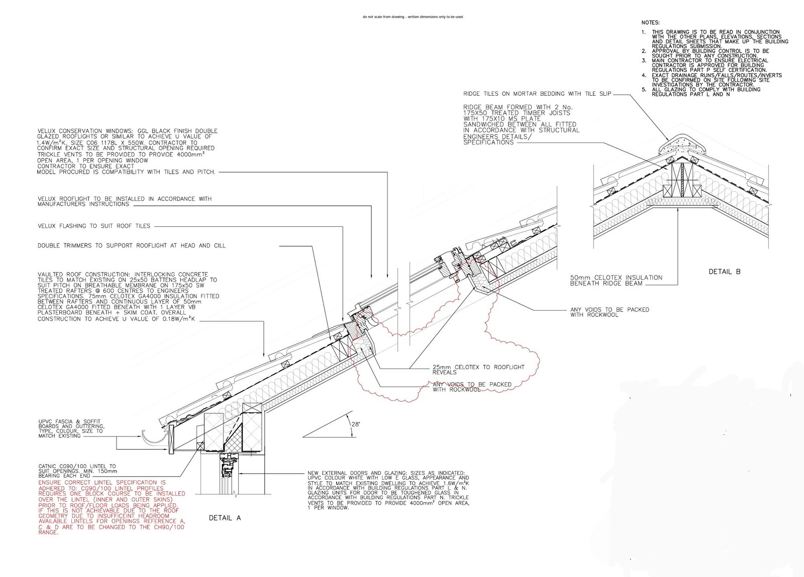

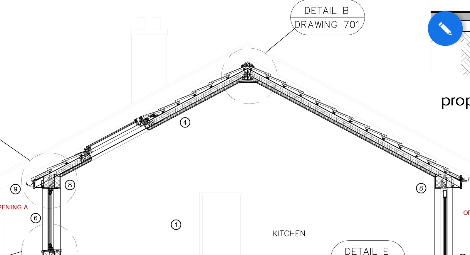

Hi all, we are planning on adding a pitched roof to an extension we want to build with Marley concrete tiles on it and two roof lights in it.
The total span will be about 5.5 metres.
31 degrees pitch.
Which leaves the rafters length at 3430mm and the rise 1646mm
What I wanted to ask is if we could away with no purlins and to plasterboard directly under the rafters.
Any alternatives?
Any help appreciated thanks in advance
