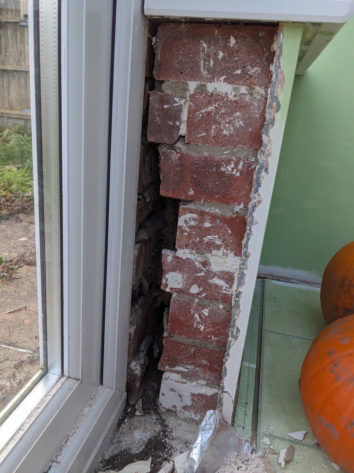

Hi, new here but hoping someone can help. Opened up the cavity on one side of our conservatory door to inspect some bad damp that we had there. Pulled out all the old fibreglass insulation which was soaked through and home to an ants nest, but now I need to decide whether to insulate again or keep the cavity open, and how to install a cavity closer with the door in place. The cavity also isn't one width all the way up so it would be tricky to cut the cavity closer to size to get a good fit. It was previously just plasterboard and plaster.

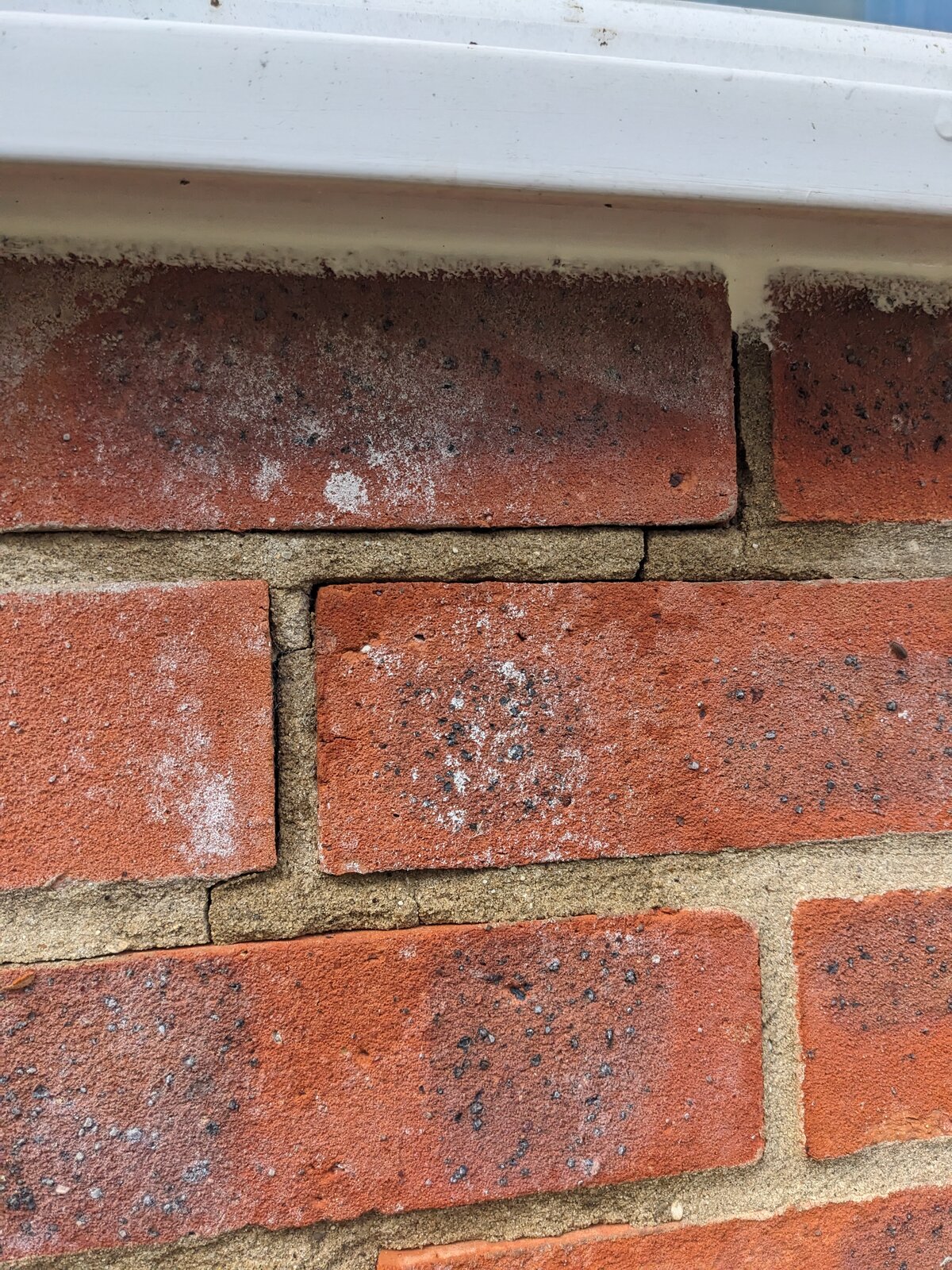

We've determined that the eroded mortar to the exterior is most likely the cause of the damp, and I will be repointing before sealing the cavity back up to make sure the issue is resolved.

Open cavity.

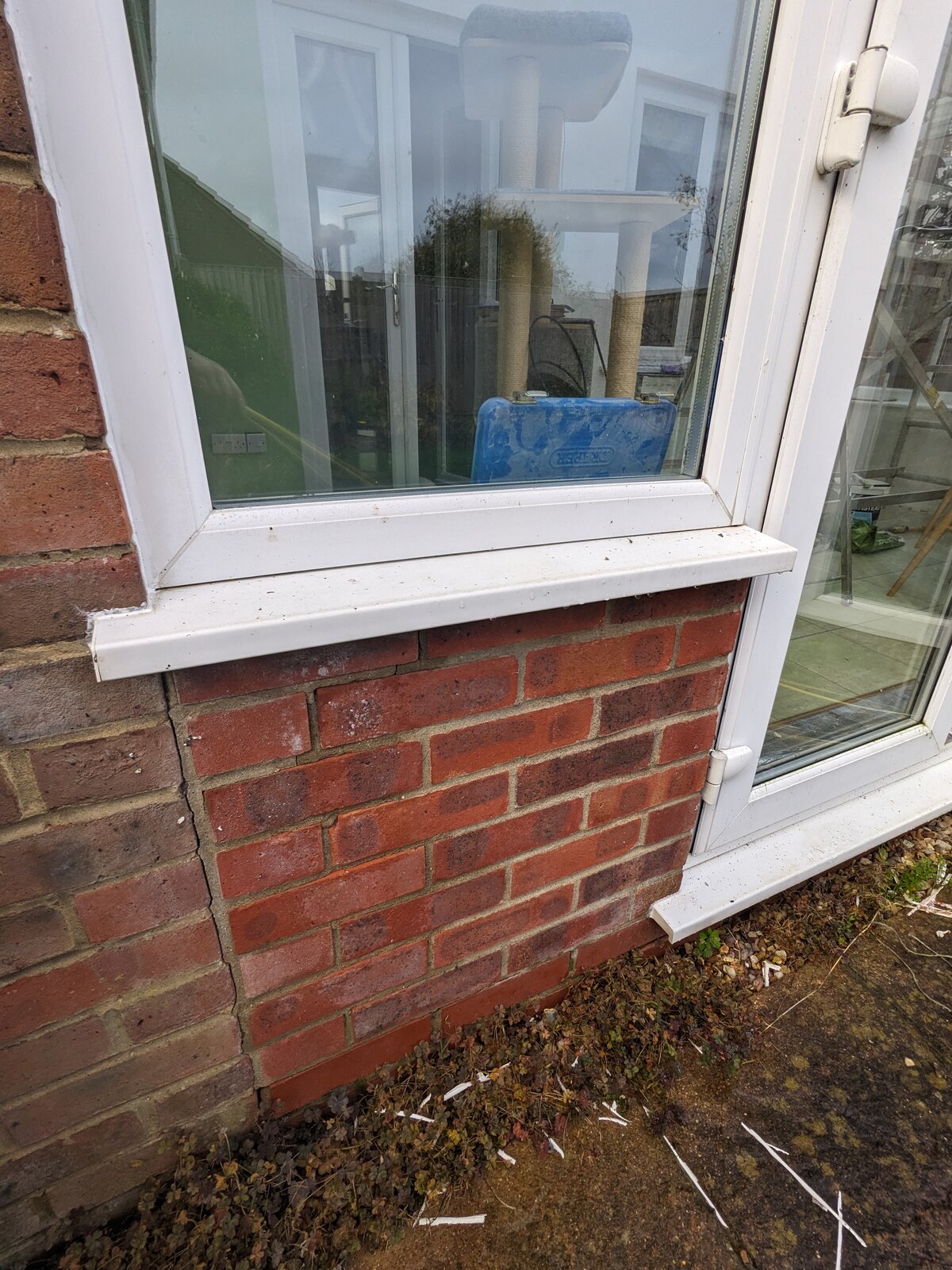

Ext. view.
Damage to mortar towards top of wall just below window sill.

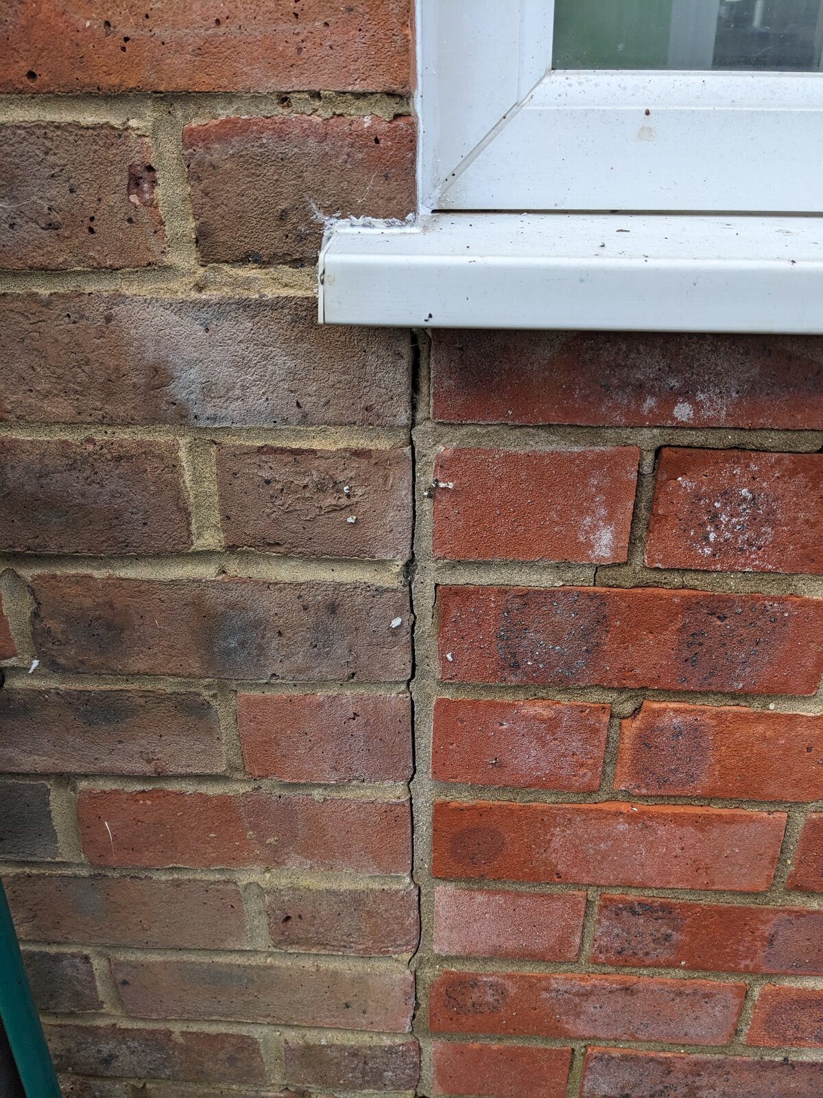

Gap formed between conservatory brickwork and garage. Clearly wasn't tied in properly when the conservatory was added. Do I retrofit wall ties or just repair the mortar??

The brickwork below the window looks decidedly wet. Where is the frame draining to?
Loft insulation can get wet, but the fibreglass CWI in my house is treated, I think with silicone wax, and repels water, you can't wet it. I think yours has the wrong stuff
You could perhaps poke closed-cell foam board into the gap instead, but you need first to work out where the water is coming from and correct it.
Look into the cavity with a torch while someone sprays a hose onto the wall, the cill, the sides, the head of the frame, and then above the window and on the gutter and roof. They must start at the bottom, or it will run down the outside and you won't know where it's getting in. You can also use a selfie stick to look in the caviy.

To me, it looks like the dampness follows that crack in the mortar and that vertical joint. Seal the cracks and see what happens.
Slide some DPC into the reveal and then close the cavity with some expanding foam.
If the rest of the cavity is insulated, then yes put insulation back in. When that damp fibreglass dries out, you can use that.
Yes, it definitely looks like the cracked mortar is to blame, I'll be sorting that this week. I'll probably replace the insulation since it's full of soil and ants as there was a nest in there, yuck! Thanks for the advice!
Thanks for the idea with the hose. Would be a good way to see where the water is coming from. I'll replace the old insulation with the proper stuff.
