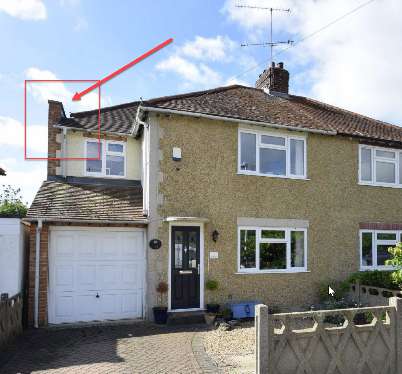

We're buying a house with a 2nd story extension above the garage.
The wall of the extension protrudes above the roof which is odd as other properties in the road have had a similar extension without the wall protruding above the roof line.
Does anyone have any idea why the wall has been made higher than the roof line?
Here is a link to see it on google maps: https://goo.gl/maps/XTFeQzRnxTtFq4uw7
if the roof was finished any differently it would hang over the neighbours.. not unusual.
Parrapet wall, Can cause issues if not sealed correctly , had frequent leaks caused by mine until it was removed.
I,m guessing its a cock up in the fist place and that was a solution, I dough't think anyone would build like that on purpose.
Won't win any design awards but ,as others say, it will most likely have been built as a parapet wall to avoid the eaves and gutter overhanging the boundary.
