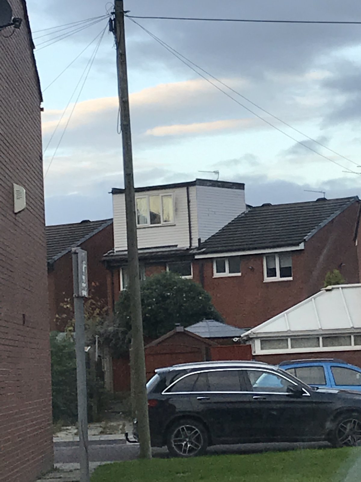

I got the EuroCell Durasid stuff and it’s bowed slightly. I’d use the Cedral Weatherlap stuff if I did it again.
Photo by noseall looks like what Tony said planners don't like to me :!:
what the rules are intended to avoid are people putting such materials as white PVC cladding on dormers, which usually stand out like a sore thumb.
The Cedral looks infinitely better than the cheap white plastic rubbish you see, adorning many a dormer, especially when you are able to compare with a next door neighbour.
There are darker colours available.
I think Tony meant this, my favourite former near me:
Fair enough.
