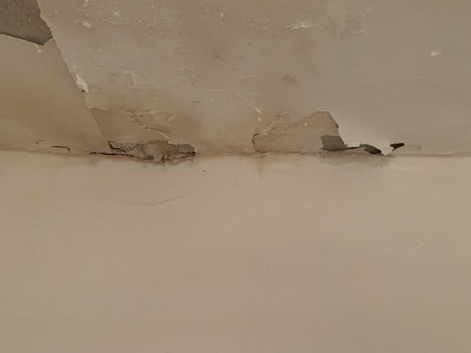

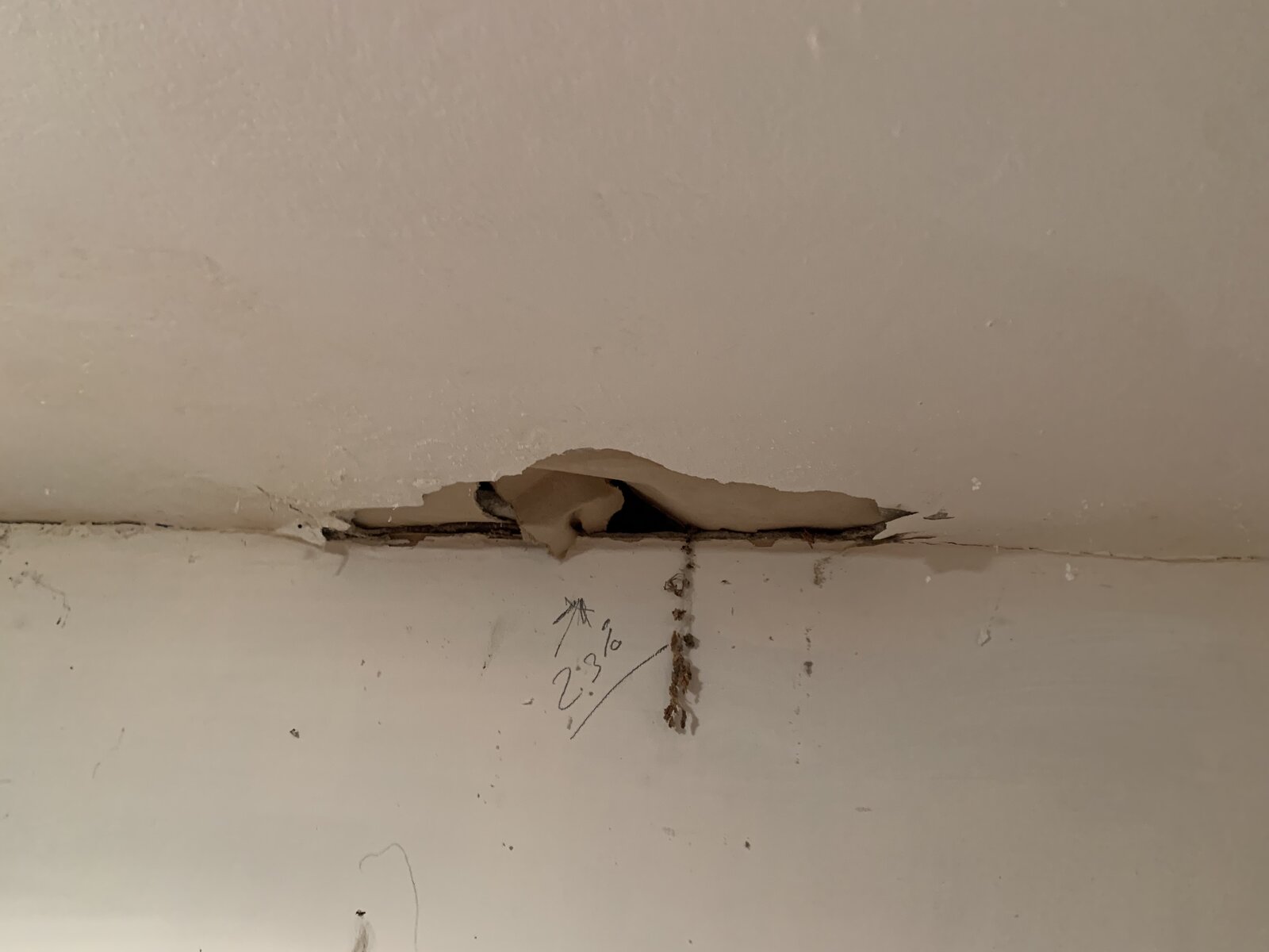

Can anyone help please? Water slowly seeping through base of 200 year old terrace house into the basement ceiling over several years. Rogue builder tried repairing by just putting in cement/sand in places a couple years ago. Leaks continued in various places and affecting where basement wall meets basement ceiling. Now got two widely varying quotes to fix exterior (stop seepage). Do the below steps sound right please?

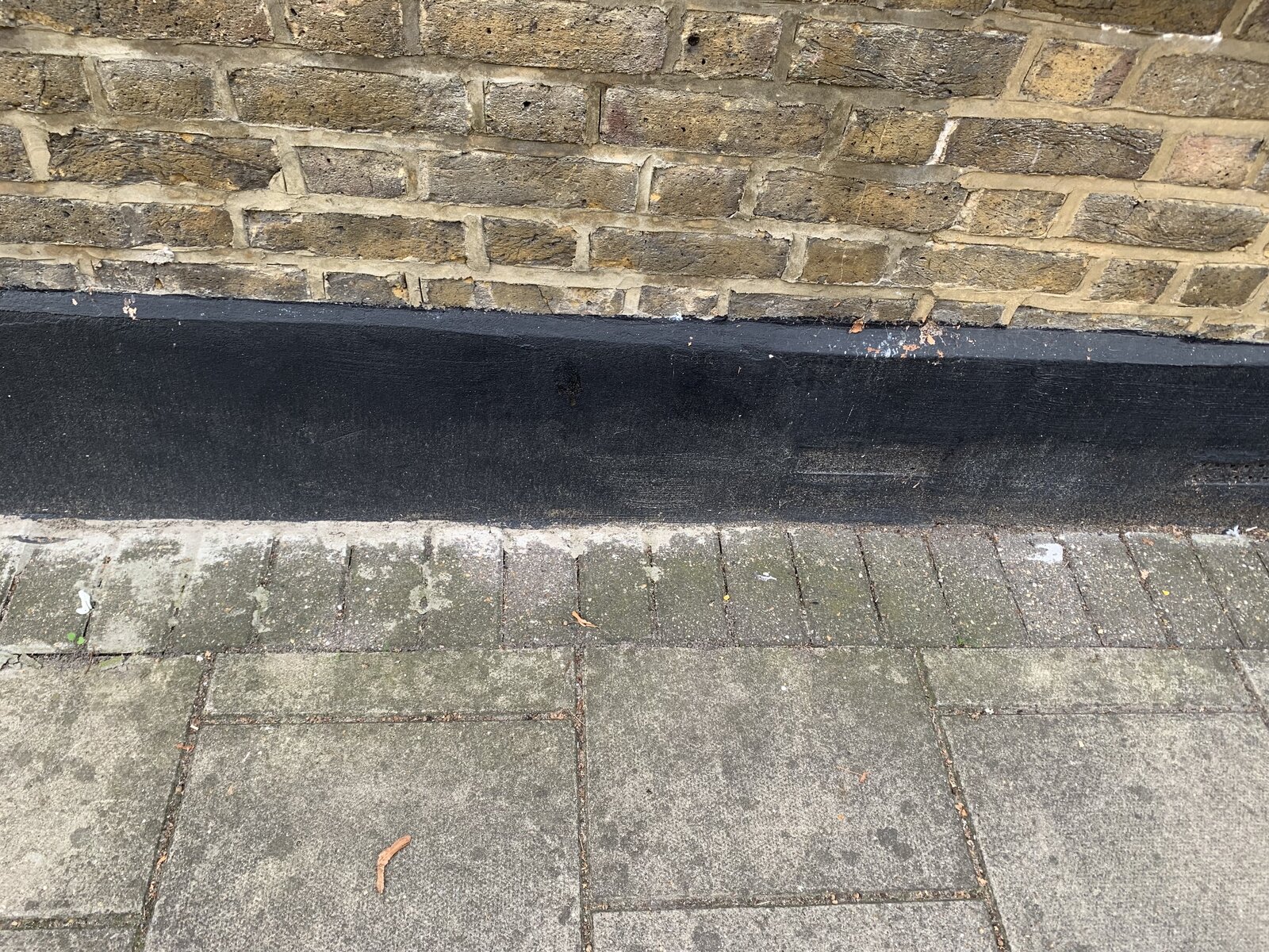

7. Waterproof plinth by applying (a) primer, (b) 2 coats of black damp course membrane paint

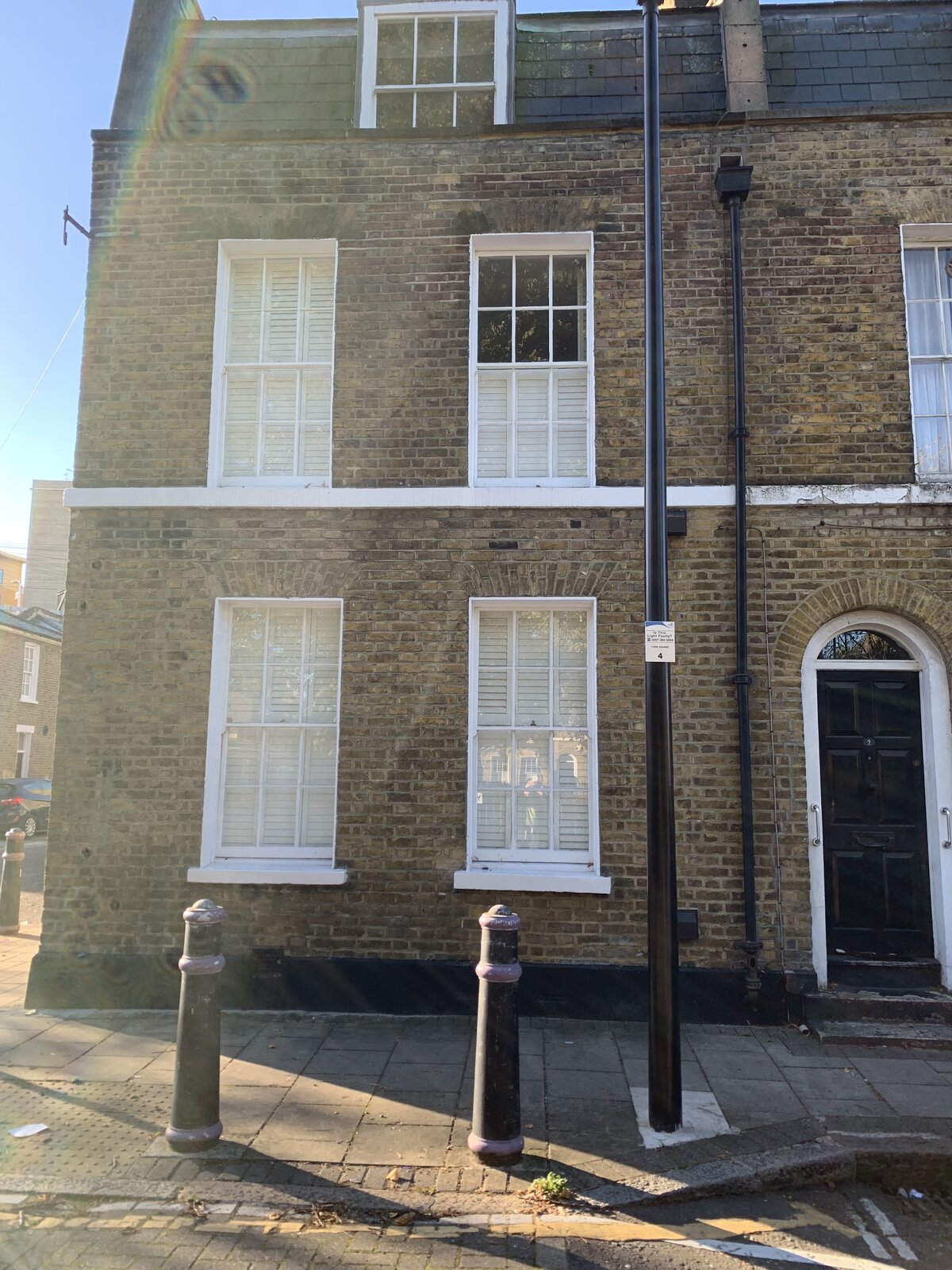

Looking at your pictures of the internal walls, and the height of the vents in the outside wall, I'm guessing we're talking about surface water finding its way through the walls, rather than ground water penetrating the walls and causing damp.
Your quote seems to address the latter, rather than the former.
It is the former, ie surface/ground water finding its way through the wall. What steps would address that?
Who does the paving belong to? Which way does it slope?
Stand back and take a much wider pic of the entire side of the house, from the roof to the paving. Include all gutters, downpipes and drains.
Hi John D -
The bricks immediately touching and perpendicular to the house belongs to me.
The rest of the pavement is public and belongs to the council.
I think there is a very slight slope away from the front of the house towards the bollard.
thanks
Is it possible to discuss with the council and explaining the problem to them, of you creating a surface water barrier a little away from your wall?
It seems to me that you want to prevent water running along your wall, so it can't find it's way into your house.

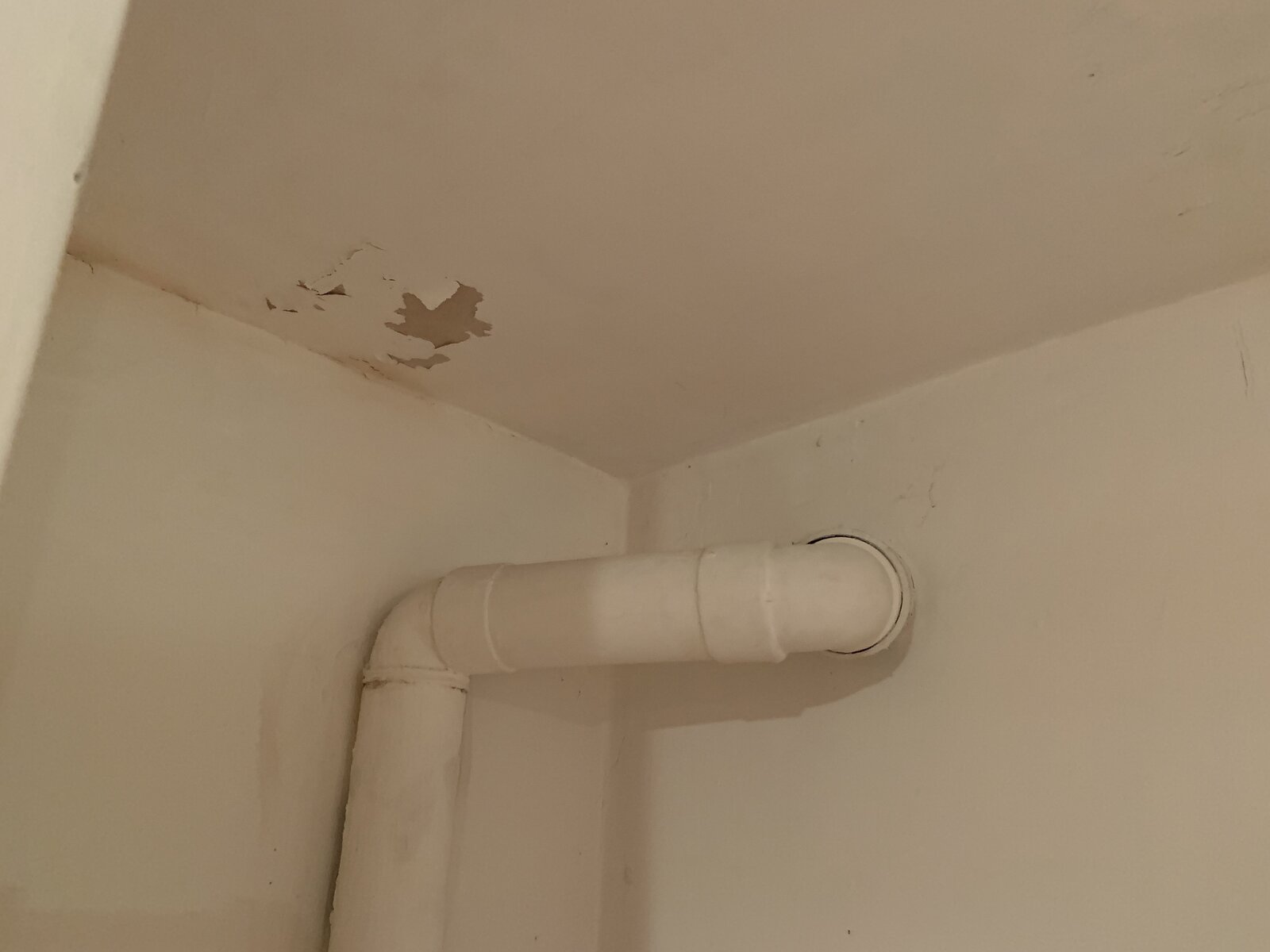

Where does this discharge? Looks like it's going into the wall?
Could that be the culprit
Pat - the council have been unhelpful. Its also grade 2 listed so that makes it even harder. But yes I want to prevent water running along the wall.
Jacko - the pipe goes through the basement (see attached) but doesn't seem to be the culprit as the seepage and water damage look to be where at the ceiling join (so I'm guessing its surface water seeping through).

I'd still suspect / inspect that pipe a bit further, especially the join of metal to plastic, that I'm guessing is buried in the wall. I had a very similar setup (although going underground into soakaway, that was silted up). With heavy rain, the volume of water / pressure was enough to eat the concrete and dig a new channel...
