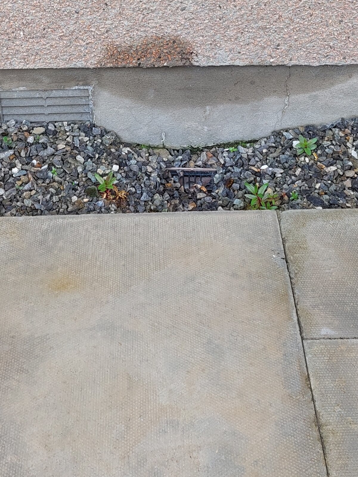

Hope someone can help. I have a wet area on the exterior wall of the house.
It is there every day. Dries a bit in the sun but will just come back or not dry properly etc if not a hot day. Same area every day. I have searched all the pipe work, looked under the flooring etc and can't find any leaks anywhere.
It's a cavity wall - so the exterior of the cavity. No insulation in the cavity wall.
It hasn't rained for about 2-3 weeks now and is still there. It doesn't come from the ground up.
Any help would be great.
Is it coincidence that the damp patch is positioned next to a gully? A gully that appears to have a 40mm spigot inlet (sink waste?) entering into the back?

I forgot i had this. This was it btw at the start of May after some rain overnight.
Better pic, thanks.
Is there a weeping water pipe on the inside?
Is it cavity or solid brick wall?
Is there a joint in the gutter above the damp patch on the pebble dashing (could be dripping down)?

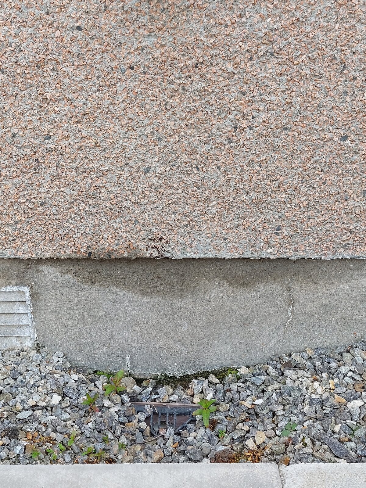

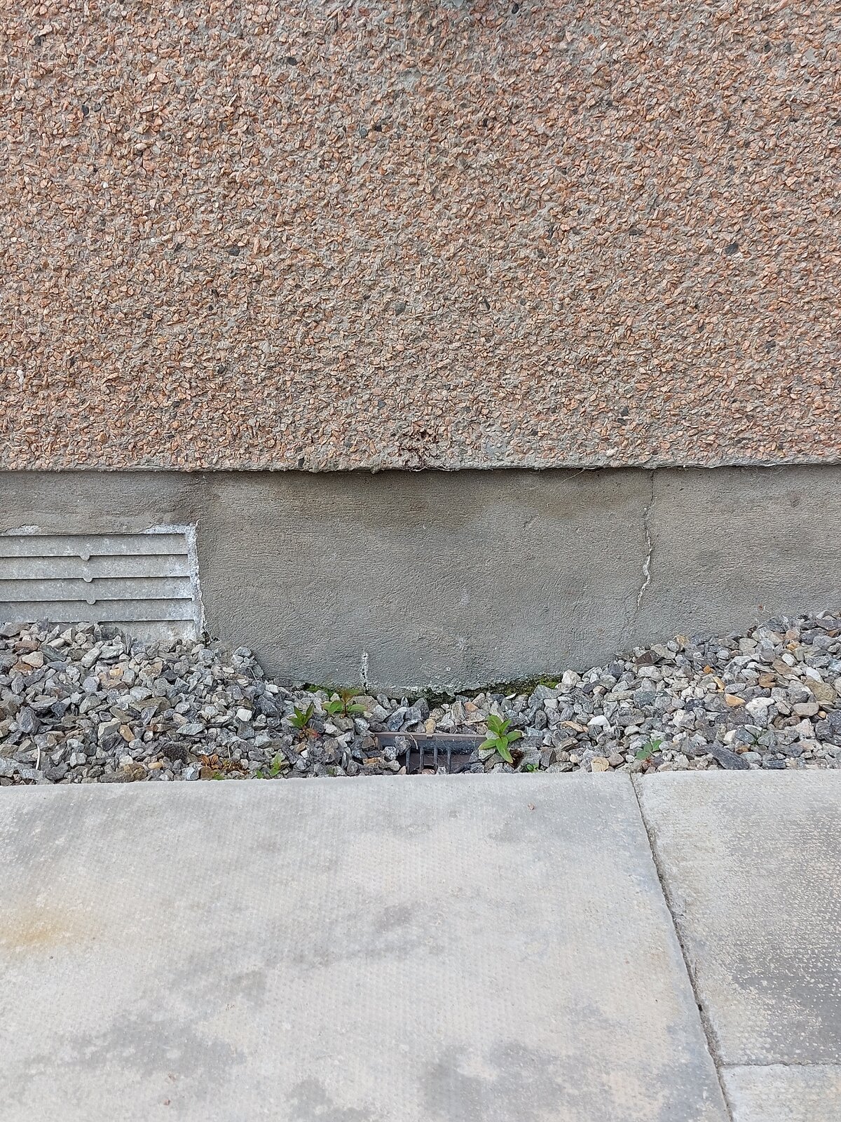

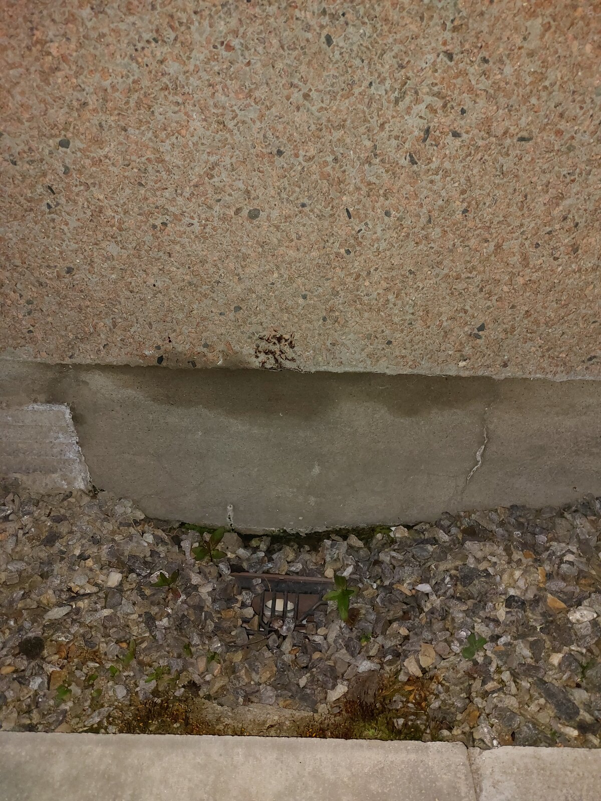

This was this morning. Again, no rain for some time. Would it still be like this if it was damp? Second picture is last night around 6pm after day of sun in the back garden etc.
Is it my imagination or can you see the outline of a circle in the render just above the joint line and right in the centre of the damp patch. Was the waste outlet moved when it was rendered. Might be imagining it.

Hi, if you mean the brownish area just on the bottom of the render? That's dried stain that's dropped from painting soffits above.
I'd dig around the gully (easy & free) and have a good look, perhaps something not connected properly, perhaps full of gravel and partially blocked.
Rainwater might not be in same drain as your sink waste.
How far down does the render go?
Thanks. Would an issue with that drain cause the damp patch to be as high as that (sorry not massively knowledgeable of these things).
They've cemented around it - in other words, if you remove the stones you see, a few inches under is cemented areas.
Depends on what bricks you have down there. Engineering bricks don't absorb water like old bricks might do.
If you explored around the concrete around the drain, is the soil really wet (perhaps drain leak) or just normal dampness?
Perhaps take some photos of the inside if you can, the eagle-eyed amongst us may see something.
