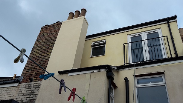

Hi All,
I have an odd situation where my loft waste pipe for the toilet runs close to the roof as it exits the wall. I need to do this so the toilet isn't too high in the loft. Because of this I can't get a branch over the eave in order to run the pipe above the roof line. I have sketched up a run using 90's but then breaking into the horizontal section and adding an air admittance valve.
Can anyone advise if the proposed sketch below is suitable?
Not to scale, all minimum falls assumed, admittance valve noted but not sketched in.
Thank you.

Can you not run the pipe up further from the branch and have an open vent instead of the AAV?
Also best not to drop that basin waste into the branch like that!
You should really boss it into a vertical stack.

Thanks for all the replies guys. Am please no-one has taken excepting to putting a branch in the horizontal. I could extend the vertical above the roof line but will have to negotiate the guttering with more bends. I quite like the clean look with the air admittance valve. I could extend the new vertical stack and run the basin waste horizontally.
Picture below of the dormer in question.

I would put a vent/stack up directly above the existing stack at 1st floor and bend it backwards towards wall of dormer and upwards to roofline and terminate as normal with vent cap.
Branch off to wc outlet along the wall with clips. Keep it off the 1st floor roof as it looks neater and stops leaves etc being trapped behind. Then run basin waste parallel to soil branch and boss it into vertical vent pipe above soil branch - use a boss connector rather than a strap on.

Thanks for that. Unfortunately what I didn’t make abundantly clear in the cartoon is that the horizontal WC pipe needs to run tight the tiles because of the floor height inside the loft. If I raise the pan I will need a step or plinth to get onto it.
With the horizontal WC pipe along the tiles I won’t get a branch under it as you suggest, that’s why I went with all 90° bends and then a branch along the way. Although not a usual setup is it acceptable?

Can you post a photo taken from above? From the balcony along to the wc outlet would be useful!
It's ok but I'd still extend the branch pipework to an open vent above the gutter. The AAV should be above the spill level of the basin so you'll be a good bit up the wall anyway.
