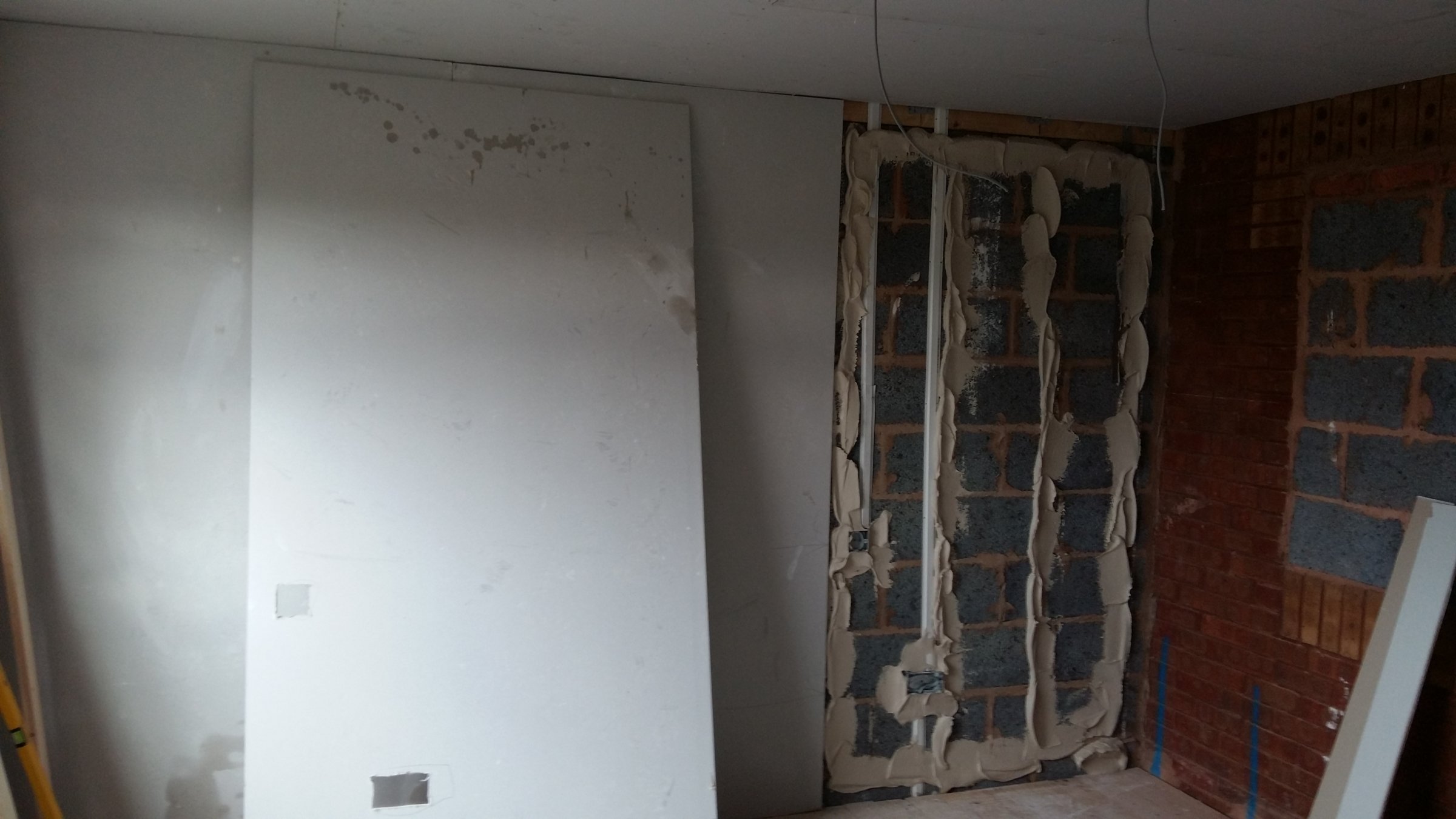

Hi all,
In the bathroom I have just ripped the tiles off the external wall. Unlike the other walls, this was boarded with plasterboard and now I have ripped that off all I can see is the breeze block.
The plasterboard was just glued to the wall. Is that normal?
I will be re-tiling it eventually.
To get it ready should I just re board it with plaster board then tile? Or should I render it... If so any tips on this?
There is quite a gap between window sill and breeze block as you can see!
Here are some pics
Thanks everyone!
Yes. Plasterboards are adhered to the wall using board ahesive. Some 'dabbers' are better than others.
Buy yourself a moisture resistant plasterboard and a bag of dry wall adhesive and stick it back on the wall - plumb.....
What a gent. Thanks ever so much. The pictures really help to see how to put the board adhesive on. Thanks very much!
Getting it nice and plum could be the tricky bit!
The getting it plumb bit- you may find it easier if you fix some spacers (batten or shims or anything) to the wall at the top edge so that when the board is pressed onto them it is square to the cill and in the correct vertical plane to line up with the rest of the room- gives you a guide as to how thick to dab and gives you a fixed plane to level to.
Use adhesive foam, its quicker and easier. Fill any deep holes and joints first
