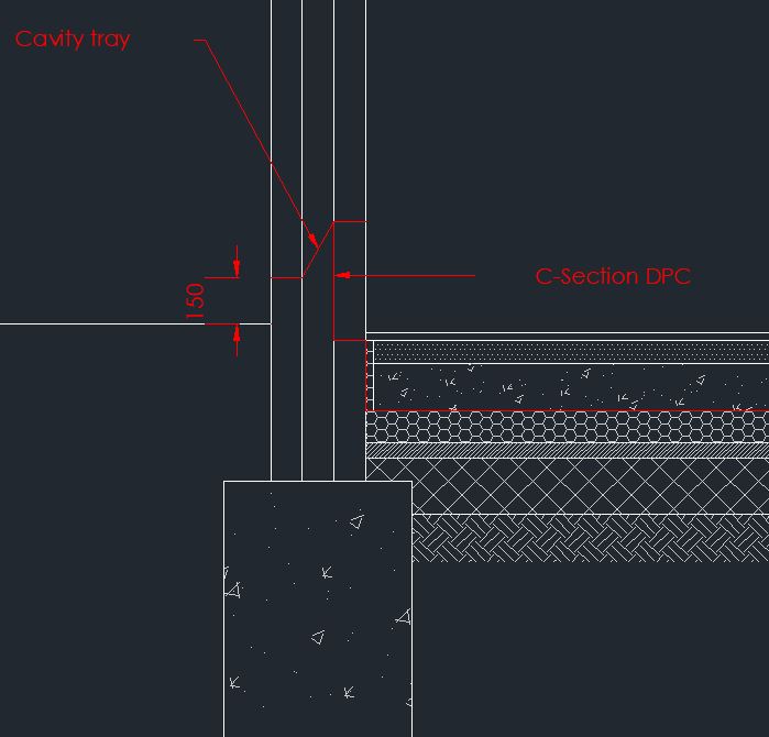

Hi, I am currently building an outbuilding and the ground level on the side elevations is approx 50-100mm higher than internal floor level. I have attached a detail with a DPC wrapped to the inner leaf outer face. Would this work or is there a more simpler version to this?
