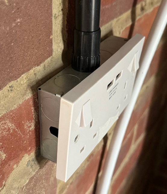

Almost at the end of adding plug sockets and lights in my garage. However, the backboxes I bought from Screwfix don't cover the lightswitches/plug sockets fully. I assume these are not safe to use as they are and I haven't connected anything to mains yet.
I've tried googling and checking Screwfix/Toolstation but can't seem to find metal backboxes with suitable dimensions.
The first two pictures are what I've added (not connected to mains yet so nothing operational):
And this is what I'm trying to achieve:
Can anyone point me to the right type of backboxes please?

Yes as above.

Are the plastic pattress boxes ok for garage use?

Thanks very much everyone. Will be getting plastic back boxes.
If I recall correctly you used to be able to get metal backboxes designed to take plastic fronts. they had "ears" on each corner such that it matched the corners of the front plate.
but as pete says use the conduit pattress boxes

Be sure to get the PVC ones, and not the regular plastic ones. The regular plastic ones do not have any means to fit 20mm conduit, and would shatter if you tried.
I did not think of this. Will recheck what I've ordered.
