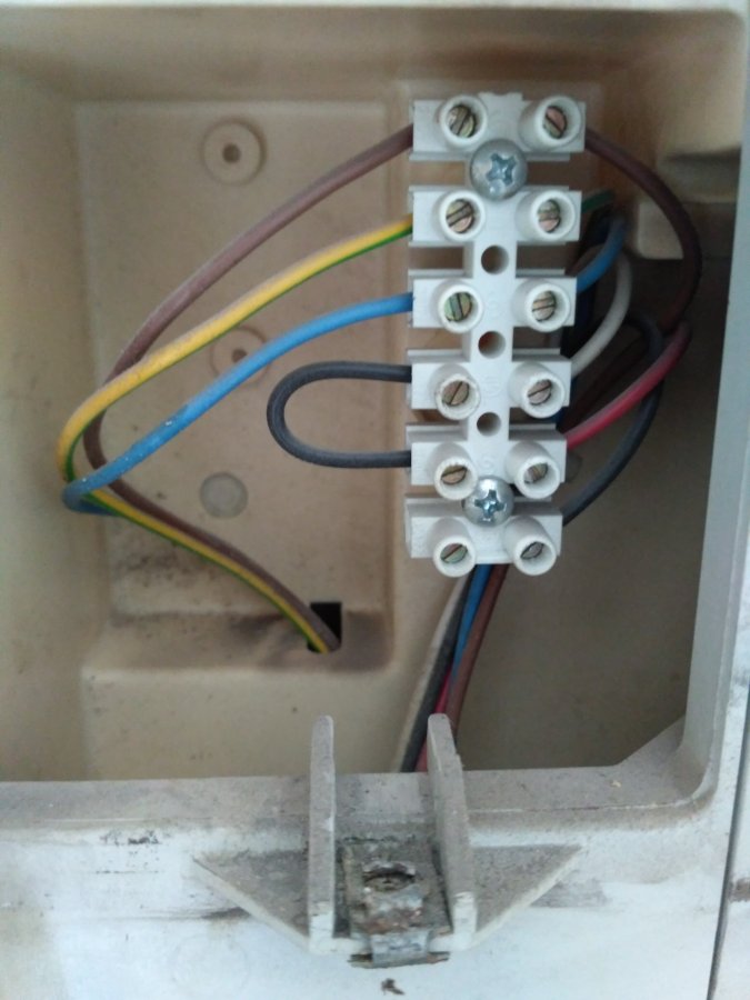

You need a programmable room thermostat, with volt-free connections. If you are looking for good value, go for wired, not wireless. Cheap wireless models are a mistake.
Connect the 2 switching wires from stat to terminals 1 and 3 on the connector block that's next to the mains supply block at back of boiler's control panel.

Hi there , i am planning to install a room thermostat to biasi 24s boiler . However the loop/link in my boiler is connected at terminal 2 & 3.
1 Black - Neutral coming from boiler timer
2 Red - going to circuit
3 White - coming from boiler timer
4 Neutral - Live mains
5 Earth mains
6 Phase - Live mains
The 2 & 3 are connected by black wire.
Can anyone please tell me do i need to connect stat to 2 &3 or 1 & 3 ? ?
The stat is Salus Rt500Rf. Thanks
Image attached
