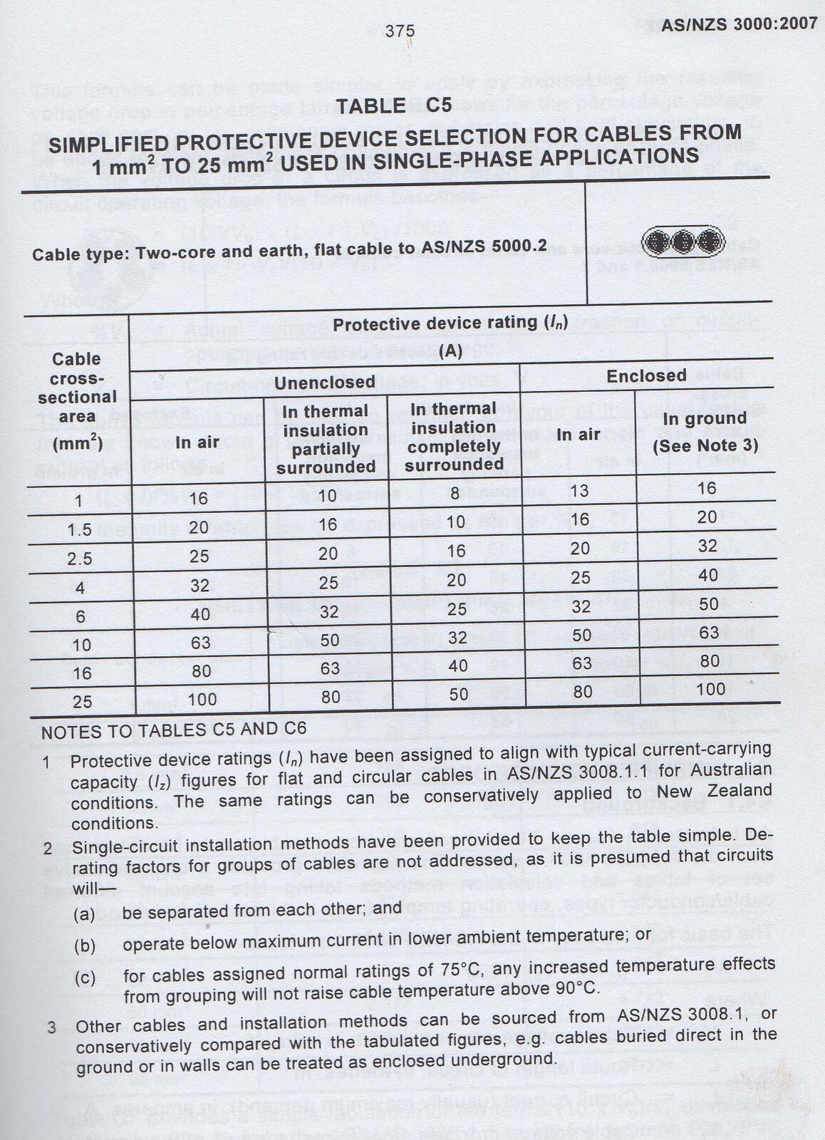

Thank you all for your "responses".
It is "interesting" that the "Current Carrying Capacity" of conductors is determined to be different under various "administrations".
It seems that, under some circumstances,
"2.5mm² T&E has a CCC of 27A." - in the UK.
However,
the following table shows that,
under AS/NZS 3000,
2.5mm² T&E is rated at only 20A "In thermal insulation partially surrounded"
but
is rated at 32 A "In Ground" !
(I doubt if one could describe an 'In Wall" situation as being "In Air".)
(Of course, it is from that that I based my previous comments - being "ignorant" of UK "specifications". [Mea Culpa])
It is also "interesting" that the US "National Electric Code" (NEC ) does not rate conductors up to 20 A until #12 AWG,
which has a CSA (Cross Sectional Area) of 3.31 mm².
(See https://en.wikipedia.org/wiki/American_wire_gauge )
The NEC seems to be much more "conservative" than the EU, UK or Australia/NZ.
