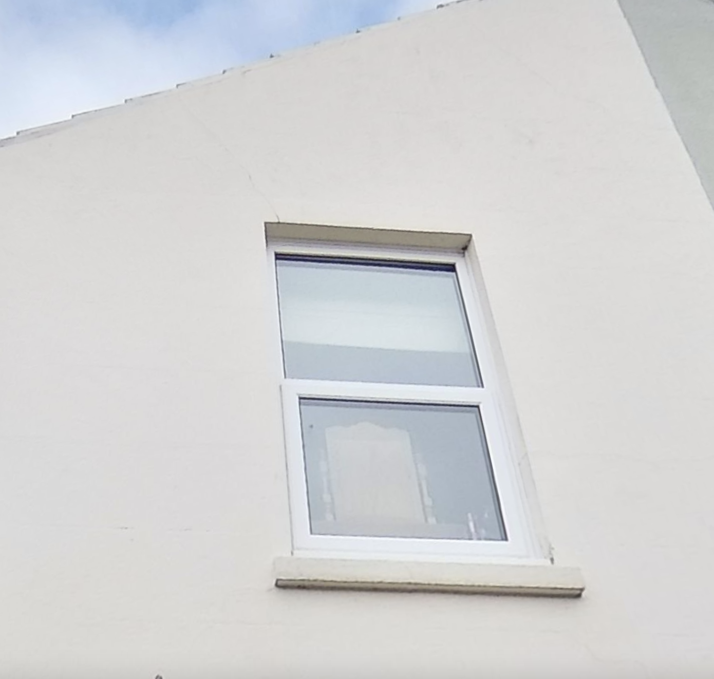

Hello, we are looking to buy a house and noticed a diagonal crack above the top floor window. Should we be concerned? Windows did not seem stiff, though we forgot to check the doors! Other things we noticed on the top floor: moving floorboards under carpet, wardrobe leaning forward in one room, and small crack in window pane corner. Any advice would be much appreciated.
I'm not an expert, but I can look out of the window of my Victorian terrace, and see 5 or 6 houses with cracks in exactly the same place.
I'm not saying its definitely not an issue, but around here it is very common at that weak point.
On your next viewing, have a look at other houses down the road, you may be reassured (...or not!) :)
Many thanks, will do that and also planning to get a survey done. Just worried because the previous house we wanted to buy turned out to have huge structural issues, which would have cost a fortune...
It’s pretty common in gable ends - personally I think it’s caused by wind loading on the block work.
it’s not a biggie, not a deal breaker.
Perhaps a survey would be better than uninsured forum posters?

It could have several causes, and it's a common place for movement to show up, but you need to have it not only diagnosed, but also quantified for costs (asking price reduction or budget for post purchase repair), and know what is being committed to.
Very common above windows due to loading stresses and thermal action.
Common in new housing to include bed joint reinforcement above and below openings to mitigate this risk.
Looks very minor and no evidence of a failed lintel or movement elsewhere so most likely not a concern but your surveyor will probably still recommend a structural report.
Thanks so much for all your help, much appreciated! And yes, we will certainly do a Level 3 survey as it is an older property.
