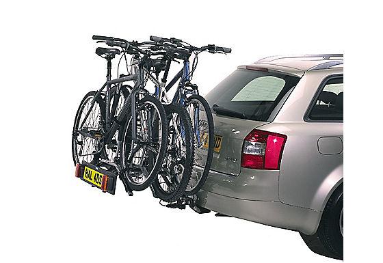

I have a cycle rack that clamps onto the tow bar -it says it should be at a certain torque (90 - I think...need to double check). It comes with a cheap flat spanner -but I'm worried I'm not tightening it enough.
My dad has just given me a torque wrench...
The 'nut' for the cycle rack has a manual screw part on the end - so I'd need a socket 70mm deep (and diameter of 19mm)
GALLERY]
Brief look on line these seem to cost about £90. :eek:
Is there another type of torque spanner??? ...or can you get some sort of adapter.???...or cheaper versions of such deep sockets???

You could use a crow's foot adaptor and amend the torque setting accordingly on the wrench. Or hit ebay for a good quality second hand deep socket
Nozzle
Thank YOU!!! :D :D :D :D :D
Crow's foot adapter is the name I was looking for !!!! Can find hundreds of them now ...and all cheaper than the one I could see!!!!

You use the screw to tighten this clamp to the tow bar ball - you need to tighten by hand whilst holding the rack horizontal and then finish it off with a spanner to the recommended torque (looked up - is 90Nm).
This is the only thing holding it to the car (no wheels!) - it sticks out 3ft ish and weighs 67kg (12kg rack & 45kg of bikes) ...made by Thule - so should be safe ... :confused:

Thule are a recognised manufacturer so I guess there won't be any problems with the design....I'd be quite interested to see a pic with the thing installed on the car though, just for interest!
