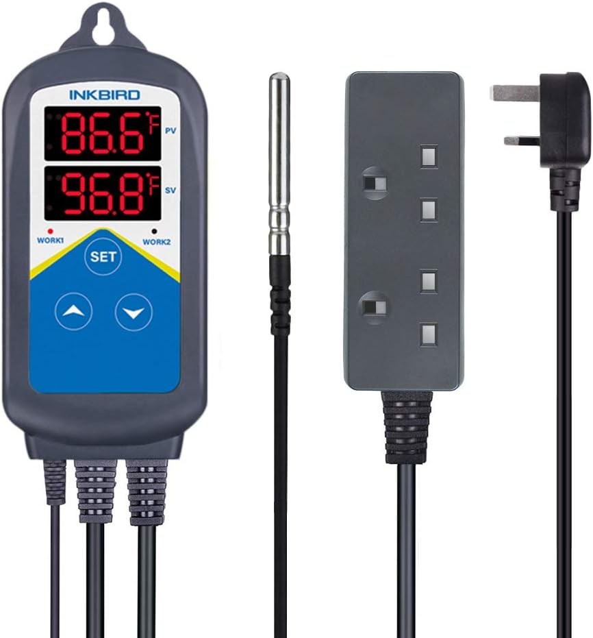

I use a home made version of this 1694297965725.pngInkbird unit, mainly used for brewing but also use it for any other item needing a temporary thermostat, but the one you show would work.
However my heat pump dryer is in a small room and no real problem with over heating, it is the type that use the room air to condense the moisture, the type that use water to condense are OK in a small room, and the vented type are working like an extractor fan to start with.
The thermostat I show has a sensor so you can put it on the AV equipment, but the problem is if you suck air or blow air it has to be replaced some way, air will need to move in both directions.
