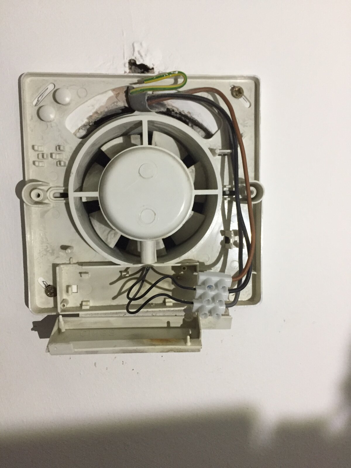

Hi, I have two Primeline PEF4020 extractor fans - Fan 1 has not worked since I moved in a few months ago, and Fan 2 would come on with the light, and then after the light turned off, it ran on timer for a minute.
To test if Fan 1 had something wrong with the circuit board or the fan itself, I swapped the circuit boards of both fans with each other. Neither fans worked with this configuration, so I believe both Fan 1's circuit board and the fan itself are dead. That's fine, I'm happy to buy a quieter one anyway.
The problem started when I put the original circuit board back into Fan 2 - Now the fan is always on, regardless of if the light is on or off. After reading some things on this forum, I swapped the Permanent Live and the Switched Live which caused the fan to turn on and off at the same time as the light.
So question 1 - Does this mean that the timer component somehow got damaged when I swapped the circuit boards and now it continuously runs (when the PL and the SL are in the correct places)?
Edit: I just had a thought that even if the timer had died, would that justify the fact the fan runs even when the light is off?
Question 2 - Is it ok to leave the PL and SL swapped? To be honest I don't mind having the fan only come on with the light if it saves me having to buy another fan, so I just want to make sure it couldn't potentially cause problems.
1 - certainly possible.
2 - if no timer is required, remove the timer board completely and just connect the fan motor wires to L&N using a terminal block.
Probably a dumb question, but does that mean the entire circuit board is there purely for the timer functionality?
Also because I don't have a terminal block lying around, are you implying there is a problem with just leaving the board with the L & SL wires swapped? Or is it simply that a terminal block is a neater solution?
Yes.
The versions with no timer are the same fan, just with no circuit board.
Leaving the circuit board installed will waste energy as they have a large resistor on them which gets hot, wasting away the energy as heat.
The circuit board is usually darkened by the heat after being in use for a few years.
Terminal strip is cheap and plentiful https://www.toolstation.com/connector-strip/p88321
and also removes the possibility of further failure of the already damaged electronics.
Oh that's great to know, thanks for the advice! You're right as both of the circuit boards are darkened. Only one failed so far, but probably for the other it's only a matter of time.
Does it matter which fan motor wire I connect to either the L or N? Both motor wires are the same colour so I would assume it doesn't make a difference, but I thought it's best to ask.
As for the now spare SL wire with nowhere to go, I guess that's best to either put in a terminal block going nowhere (or cover up the end with some electrical insulating tape)
Doesn't matter, it an AC motor.
Spare wires in a terminal block, tape dries out and falls off.
Fan connects to SL and N, L is spare.
If you connect to N&L it will run continuously.
Sorry, yes of course, you're right L is the spare. I've got it it up and running now, and it's definitely SL & N connected to the motor because the fan only turns on with the light. Again, thanks for all the help, I appreciate it.

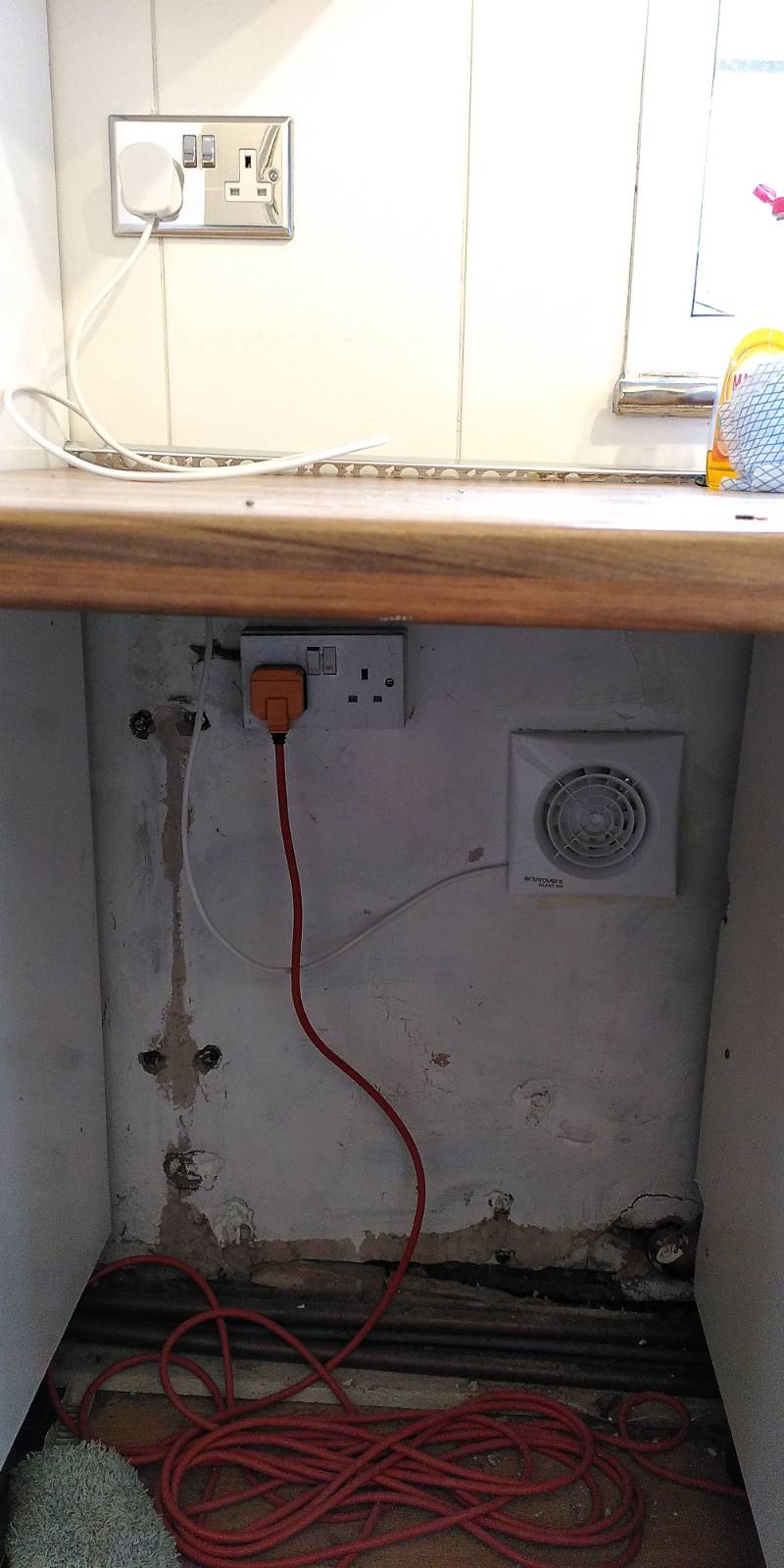

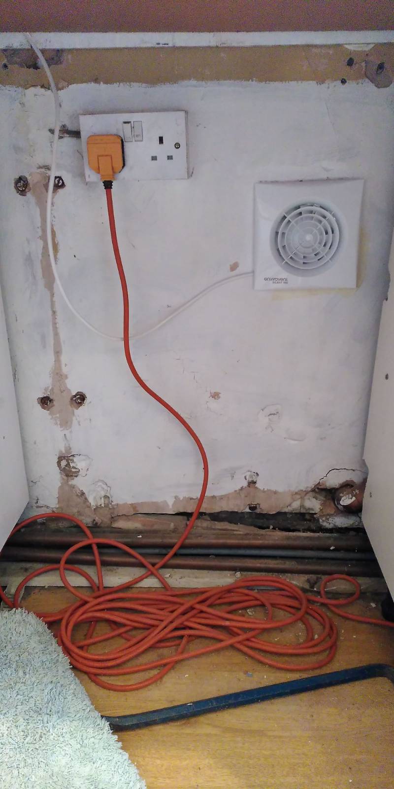

Although it's not really necessary, I thought I'd add some closure to my extension of this post in case it's useful information for anyone in the future:
In the end I bought an Envirovent 100-S for £8 from Facebook Marketplace (100 = mm diameter, S = standard, i.e. basic functionality, no timer or anything, so perfect for my needs). I bought a couple of meters of 0.75mm2 flex and wired the Live and Neutral to the corresponding terminals of both the plug and the extractor fan and done!
I also switched out the 13A fuse that came with the plug for a 3A one because that seems to be the general consensus from similar situations to mine that I've seen in forums (but I'm happy to receive advice on that if it turns out 3A is not appropriate)
The placement in the kitchen is obviously not ideal, and at 95m3/h the power is probably not the best for a kitchen, but for less than £19 I've managed to re-purpose a hole in the wall that was originally for a tumble dryer!
