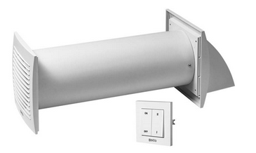

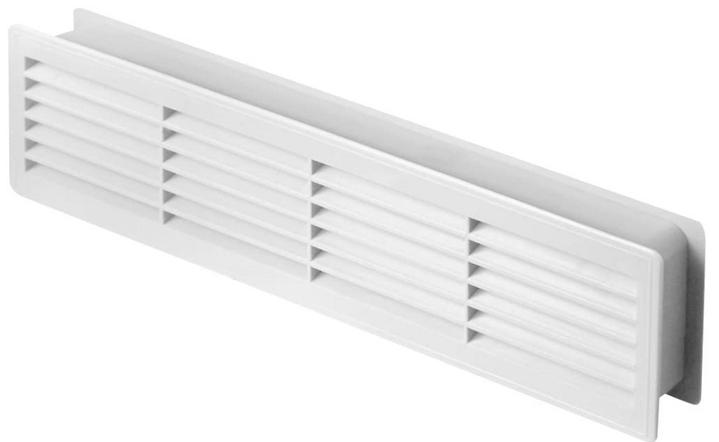

Two reasons for a fan in a bathroom, one smells, the other water vapour, but to work air also needs to enter the bathroom, I have seen vents in the door to allow air in, but it depends on the temperature of the area other side of door, using a heat recovery unit
gets around the problem of replacement air. OK £180, but although a door vent
is far cheaper, may be £9 you need some one to fit it, so looking at cost of job not cost of items used to do the job.
