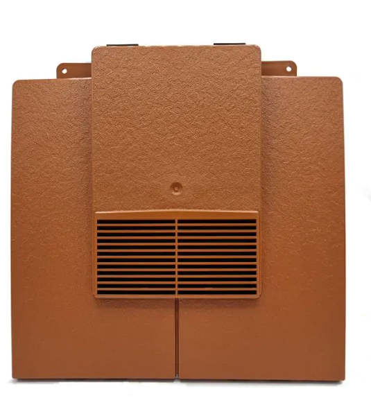

I need to fit an extractor fan in the side of my new dormer, which will be clad in vertical plain tiles of Sandtoft Humber (Tuscan colour). I've only been able to find one place that sells what I think I need but it isn't available.
Sandtoft Humber Tuscan vent terminal
Are they standard fit? For example, my tiles are 265 x 165mm so if I can't get an exact colour match, will any of these do the job?
Harcon plain roof tile vent terminals
Are there any other makes to search for? Thanks

Thanks but I was hoping for something smaller that would blend in a bit more. It’s only a dormer and the black seal alone would be massively disproportionate to the tile size!

I found this locally which the roofer's colleague is happy with. It's Manthorpe GTV PT vent. If I'd had more time I'd probably have gone with Glidevale who will do a colour match, but they're fitting the tiles this week.

That Manthorpe jobby is a roof space vent and not a TVT (tile vent terminal), which has a bulky spigot on the back and usually a cowl on the top.
It does have a bulky oblong spigot adaptor which connects to extractor fan ducting. The description also says it’s suitable for mechanical ventilation but I checked with their technical support too. Some designs have cowls but not all. Am I missing something here?
Manthorpe product details
