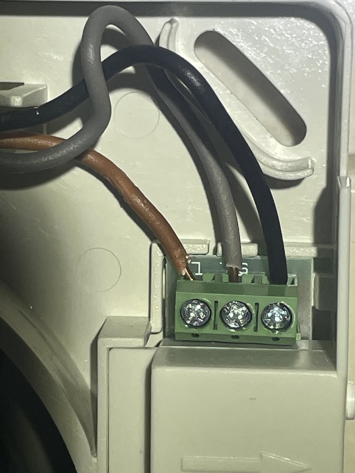

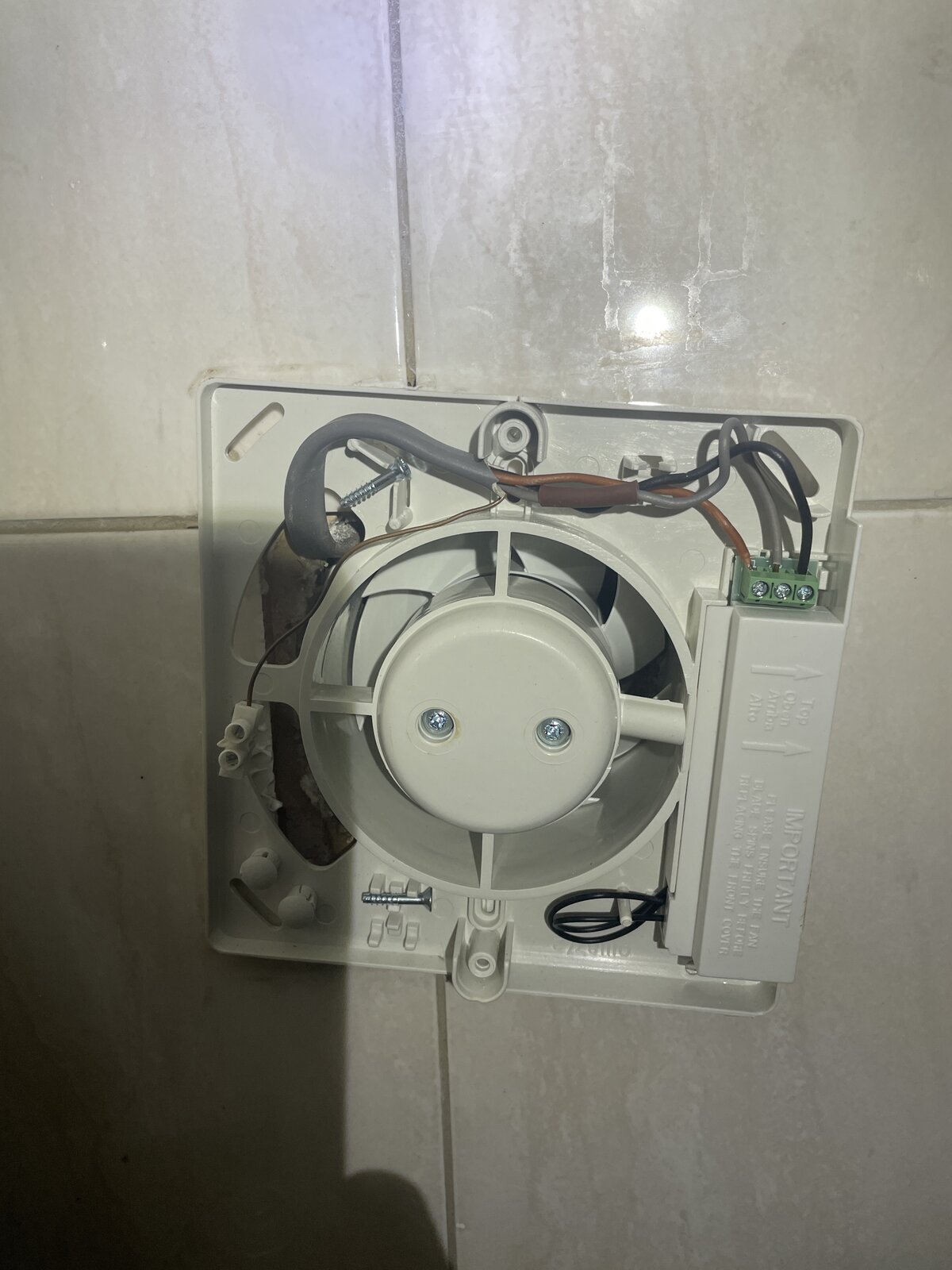

I’m trying to fit a new extractor fan. I’ve put the wires in the following, left to right;
Brown - Live
Grey with brown sleeve - switched live
Black - neutral
There is an uncovered wire, presumably the Earth, which I’ve put in a stopper.
Where have I gone wrong?
Many thanks for your help
Karl

I would think that is correct.
The bare earth should be sleeved with insulation (green & yellow).
Have you an isolator switch and/ or a fused switch anywhere that might be switched off or the fuse blown?

I'm not sure what you mean by 'Where have I gone wrong?'.
Doesn't it work?
If you are saying it doesn't work, possible causes could be that the black is switched live and the grey is neutral; or there is a fan isolator somewhere switched off.
