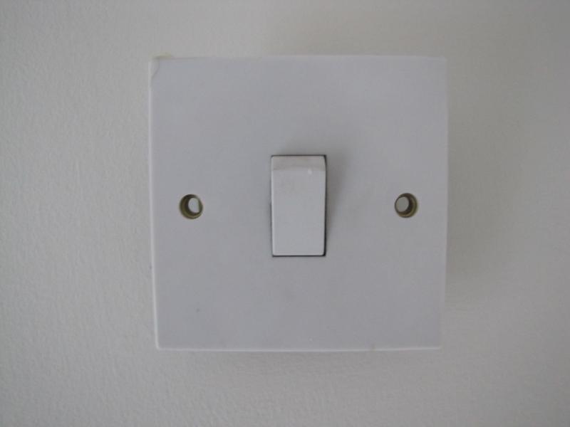

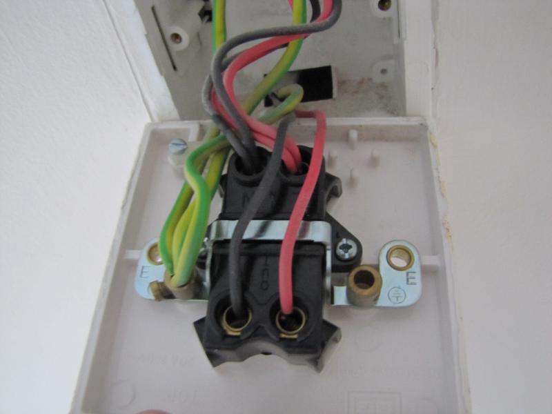

Hi I've got to replace a damaged switch in the hall for the extractor fan in the bathroom on the other side of the wall. The one that's on there at the moment has 2 lives and 2 neutral cables coming into it and 1 of each going out again, plus a couple of earths.
Picked up http://www.diy.com/diy/jsp/bq/nav.j.../specificationsProductType=mk_connection_unit in B&Q earlier but not sure if this is the right one with it being 13A and looking slightly different. Is there another MK one at B&Q that I should be using? Thanks

If you think there is an issue and they may not be of the same type, take a picture and upload and post so we can have look to confirm!

A picture of the inside terminals would also be nice.
Could be a standard switch or a an isolating switch (20 Amp DP Switch)
If you can't take a picture/upload one.
Please explain the terminals inside the switch/isolator.

They are usually quite a low output and normally connected to the lighting circuit. There should be no problem with using either the 20A switch or the Switched FCU just make sure the fuse in the FCU is either the same as the lighting circuit or a little lower. 5A or 3A fuses should be fine.
