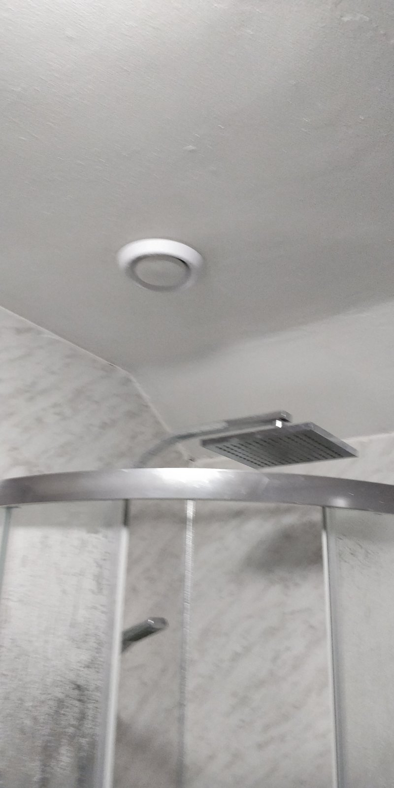

I've put in an inline extractor fan in the cavity loft in the bathroom just above the shower.The steam from the shower does not get sucked in and fills the room.I replaced the fan with a more powerfull fan and its still the same.Im at my wits end with this thing as the walls are dripping wet.Im now thinking it could be the position of the vent ,but surely above the shower is the best position.

If you take off that ceiling mushroom, does it suck better?
Will take a pic tommorow too dark,but there is a proper vent there.There is hardly any suction there with and without it.Ive put a tissue there and i have to put it in the ducting to see the suction.If i put my hand to seal it again hardly any suction.
With a bit more investigating found out that the bach draft flap was installed the wrong way,so it was actually closing when it should have been opening.Glad it was that simple but fuming with the guy that installed it for me.Thanks for your input guys.
