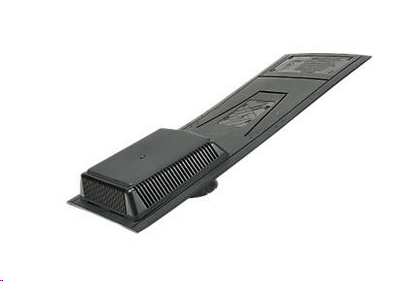

Firstly, is there a vent you can get to do this on a slate roof, I've tried searching and I keep finding loft ventilators, rather than a ventilator that a 100mm pipe can be attached to for extracting.

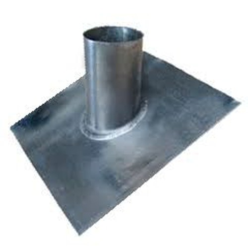

Used to be the pipe went through the roof and a lead vent slate went over the pipe.
if you have a slate roof ,you need to strip out the slates around the area were the pipe is to go through.
Once the pipe is through the roof pop the lead slate over the pipe and reslate around the lead slate.

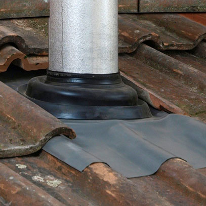

Consider whether the chosen external vent is appropriate. There are tile vents for ventilation, and tile terminals for fitting to extract fans. Use the correct one.

I'm more concerned with getting the roofing part right as this is the part I am less familiar with, having never worked with slate roofs before. I think I will try the part posted previously from screwfix as this has good reviews, but maybe wait until a drier spell in case I have any trouble!
