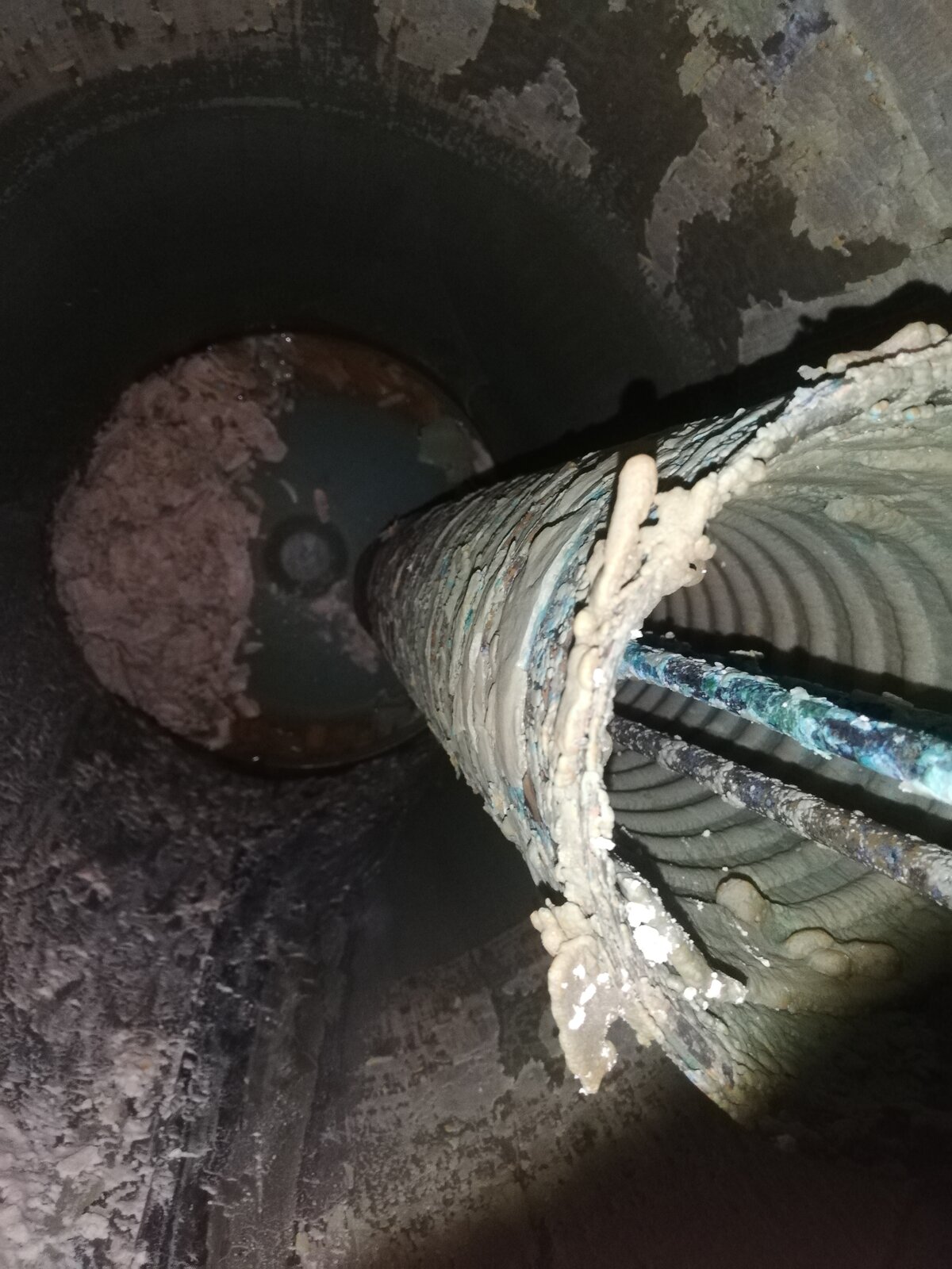

I had a look at the old cylinder last night and you are right, strange coil inside so must be one for gravity. I do believe it was the original one.
Going back with a fresh mind today I noticed the vent pipe was a little low, the top only 25-30 cms above water line in f and E so I raised it up to the 45 cms and all worked fine after.
Solved the problem in the end.
Strange coil ? like a large can with top and bottom open > it's an annulus .Classic old skool heat exchanger for gravity primaries ;)
That's the one..here's a pic.
