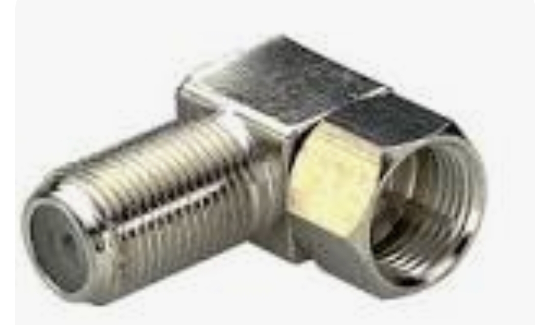

Reading between the lines, and having fitted one or two wall sockets (;)), my guess is that you're concerned about kinking the cable as you try to fit it in the backbox space behind the wall plate.
If making the junction box hole deeper isn't an option, you could try a 90 degree F plug.
You'll still have to deal with the coax tail, but at least it won't be pointing directly at the wall behind the socket.

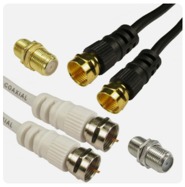

If you mean these sorts of things then I'd be tempted to give them a swerve.
The construction will be similar to the coax fly-leads. That means that the cable is poorly shielded, and the internal joints between the cable's core and the pins is a solder joint (a weak point), and that an acidic component used in the construction tends to eat away at those joints and cause a premature failure.
This is all incidental to the OPs request for help.

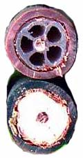

I don't think the quality of the air spaced cable in the house is all that good - cheap brown outer sheath. Certainly no foil screen.

I will give it a go with the suggested connector and probably a right angle adaptor just to be safe
Can't tell quality from that... Take off some of the sheath carefully and look at the braid weave / coverage of the inner. https://www.aerialsandtv.com/knowledge/cable-connectors-and-leads/the-three-main-types-of-coax-cable
Older stuff was much better than some of the modern cheap rubbish.

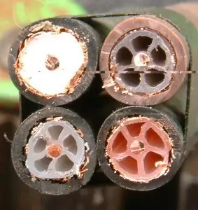

Is that a picture of the actual cables in your house? (I suspect not http://www.wrightsaerials.tv/articles/coax-cable-quality.shtml )
This is a picture of CT100 (top) and WF100 from the old Satcure website. The foil isn't especially visible on the CT100 to my eyes at least! ;)
View attachment 355276 This is a picture of CT100 (top) and WF100 from the old Satcure website. The foil isn't especially visible on the CT100 to my eyes at least! ;)

No, not an image of the actual stuff - should have said that it is similar to the top right - it is similar to the low loss coax in you link. I know that the braid is not as good as the satellite cable.
