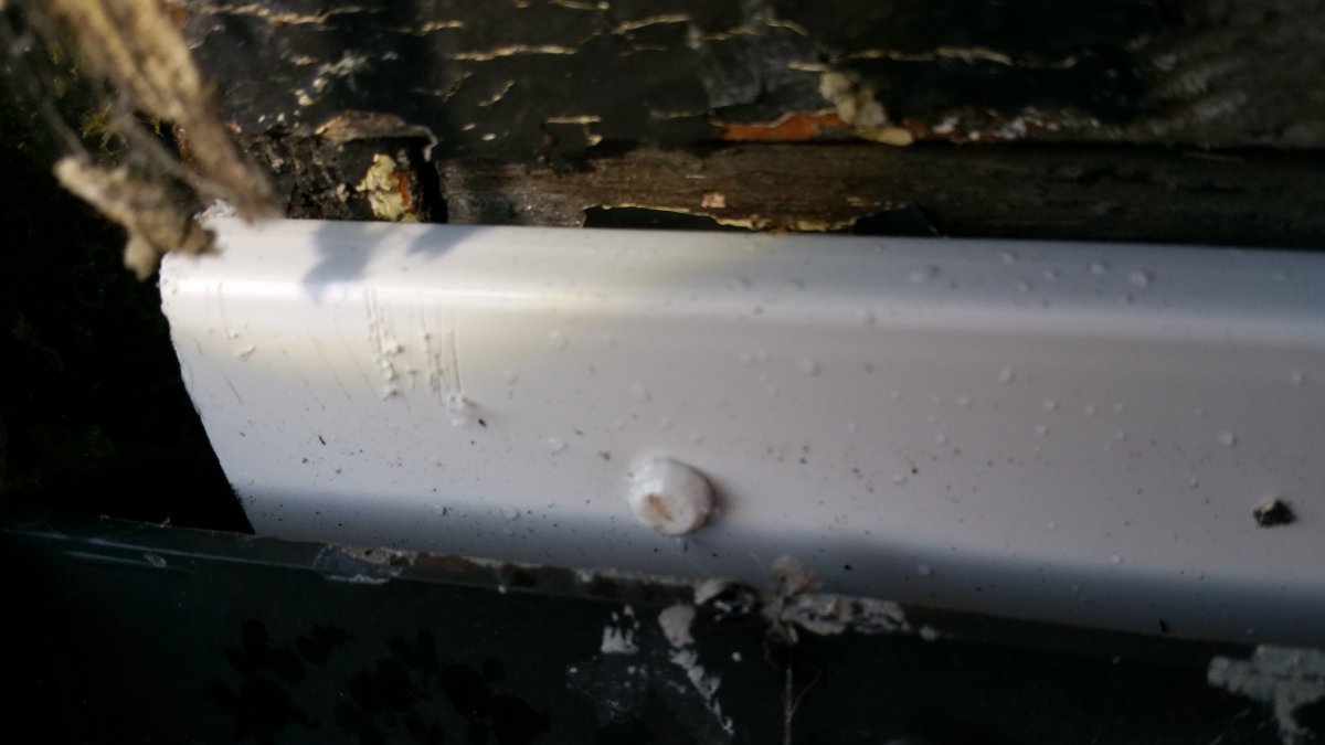

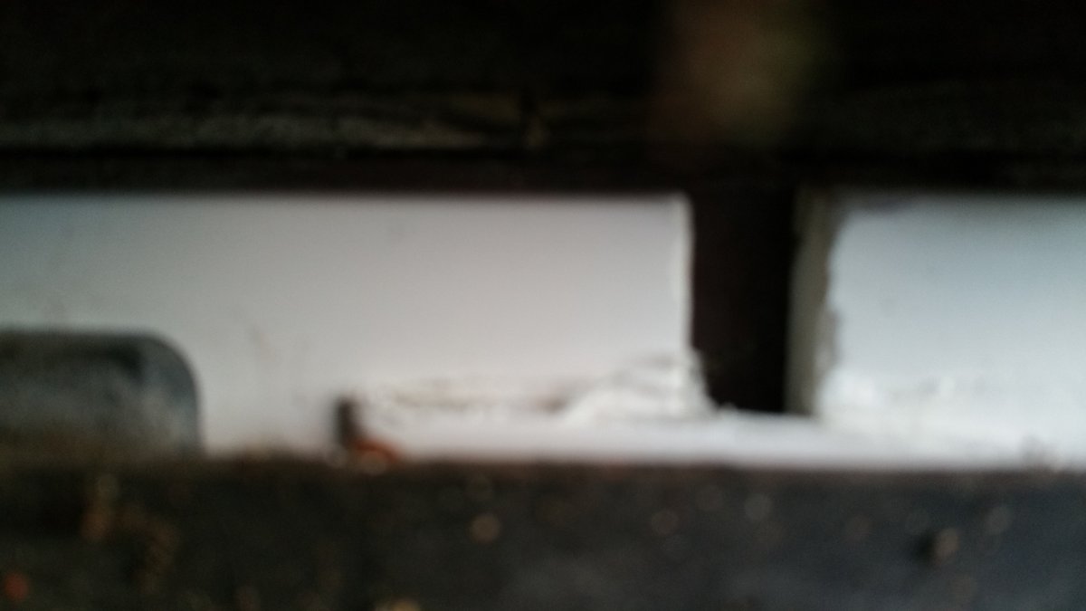

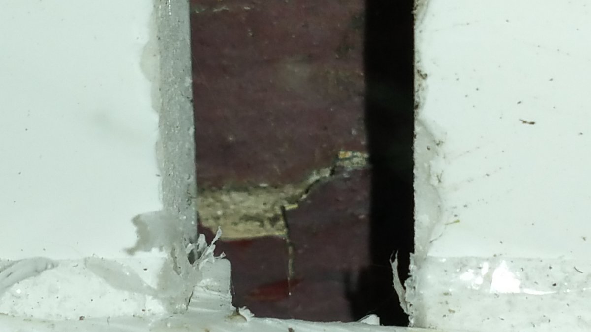

I have attached a few pics. Two show the gap between two plastic covers and the old wood behind and two show the plastic pieces over the facia.

Can't see what's going on from your photos they are too close up, but the plastic fascia will only be as strong as what it's fixed too. The plastic fascia won't hold the tension of an electric cable which will need to be fixed through it to solid timber at the very least.
Take some pictures with a camera, not a microscope.

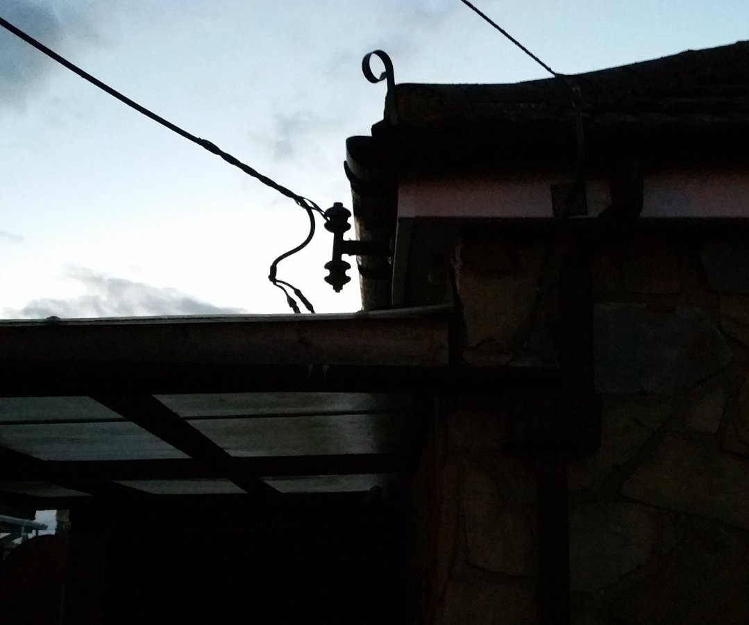

I have attached a picture of the offending bit but it is dark when I leave home in the morning so the distorted bit is not clear.

Can't really see anything from your last photos. Ideally you need to retake the first pictures from further away.

Just out of interest what has he done where the electric cable restraint is currently
He's put 16mm jumbo fascia over the existing rotting wood using 65mm nails. Hard to tell but it looks about an inch too short on the height. He may as well have poured chicken soup over it. Even with that bodge he should have lifted the tiles and located the joists and belted the nails right through to try and hold it in place. Instead your timber fascia is now even heavier with this new fascia nailed over it and your tile overhang has been reduced by 16mm and now water can get in between the plastic fascia and the wood beacause it's not tucked right up under the tiles.

Everything that Mw said and also the cover joints he has used aren't even covering the whole fascia( I was wondering what those gaps were and now realise that the photo is really close up) As Mw alluded to he has used the wrong fascia he should have replaced the wood as requested and used thinner capping fascia.

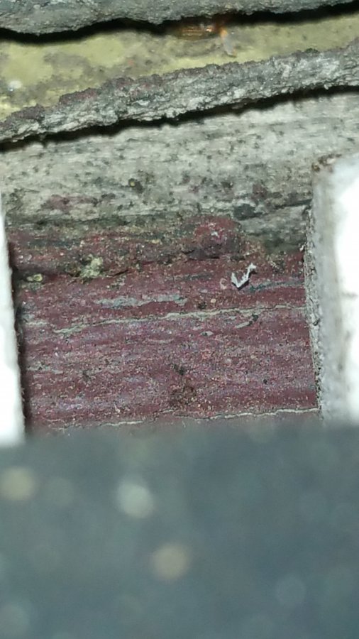

Sorry about the picture quality, I took them as I expected him to try and say he had replaced the facia and wanted a close up of the rotted wood.

But more importantly how can the fascia behind the electricity mounting bracket be replaced with it in place.
What really needs to happen is the electric board come and remove the cable, and whilst they are stringing the new cable the fascia should be changed. so they can reattach to it.
Exactly, there's no Regs (from my limited experience) saying that the connection bracket has to be fixed to a fascia - if anything that is a far more unstable fixing than fixing to brickwork.

The owner has come and said his boys say the fascia wood is sound and if he were to replace it the tiles will drop and he will need to re-cement them in place, this will disturb the roof etc etc.
He has said the exposed bit of wood above the plastic facia cover is the batten the tiles sit on, not the old facia.
He has used 10mm facia cover, not the 18mm cladding as the wood is sound.

Why are you persisting with the fascia business - let the leccy fix it to the wall?
