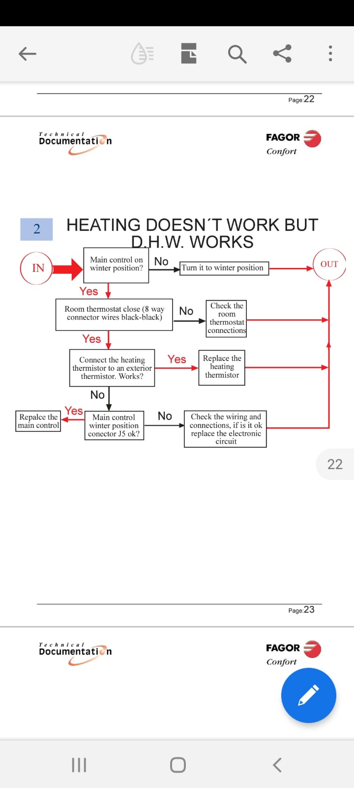

I've attached the schematic from the manual which is what suggested PCB.
I'm aware it's a lazy diagnosis lol

sadly all boiler manus do that, simple if 230V going to pump and it is not running, then the pump is faulty, or seized and needs freed , very common fault on caravan boilers as the CH is not used very often
