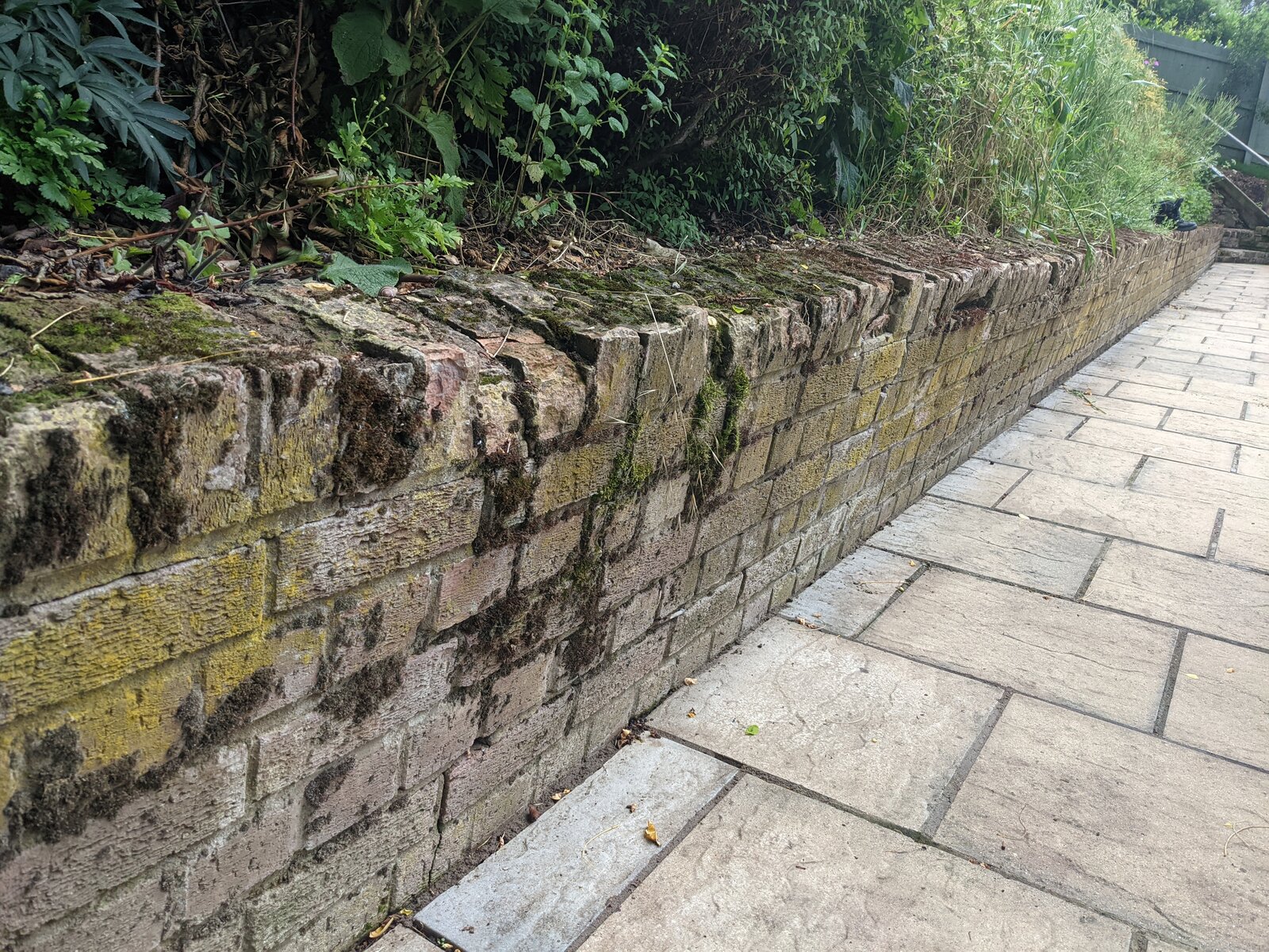

Pictures attached of a retaining wall that has failed in my garden.
I believe that lack of drainage has caused the failure. There is no drainage through the front of the wall or around the sides either. It seems to have failed above the first course of bricks, which themselves are held firmly by the paving.
It's 20m long.
I am planning to DIY replace it.

It doesn't look like the foundation has failed, it's bent rather than tipped, although check for yourself.

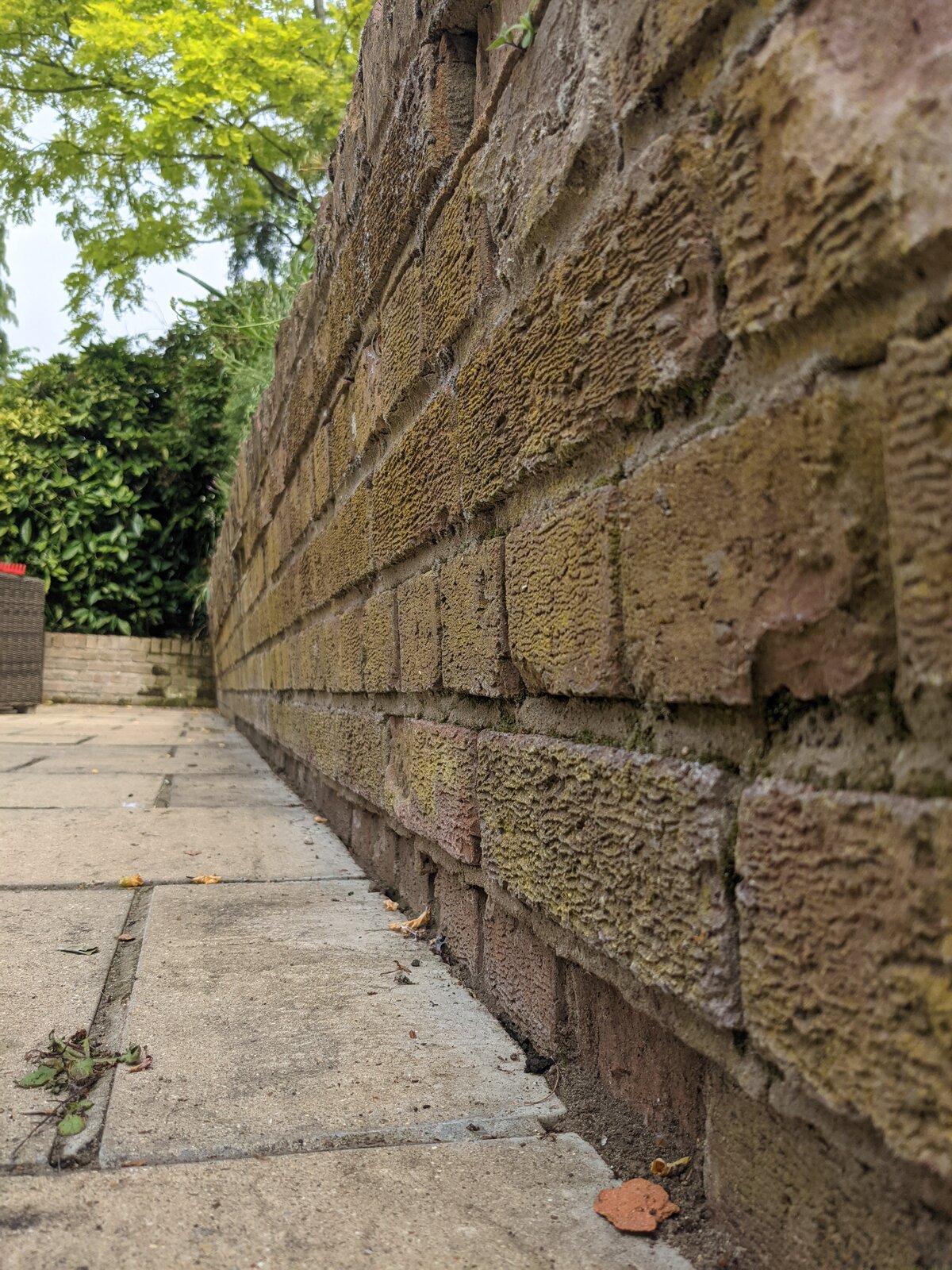

I'd say the design and bonding pattern is absolutely spot on. One issue is that the bricks are not sufficiently frost resistant. Groundwater has wetted them, it's frozen so popped them. A great shame, as it looks great.
I'd replace with something similar, possibly re-using the foundation, just with better bricks. Concrete bricks might be a good option, or clay engineering bricks.
It looks like there may be some substantial roots behind it, if so then perhaps it needs a thicker wall, e.g. a brick wall with a concrete core, or some woodland management.

That damage is nothing to do with drainage, and everything to do with the wrong choice of brick.

Thanks for your replies. The choice of brick is the same as the house, which is why they used it. I can see how frost has popped the textured faces off various bricks (but only the garden wall, not the house, which I thought was due to moisture), but I don't understand how the choice of brick has caused the wall to start tipping over?

Bricks on a house don't get the same exposure as bricks in a garden wall.
Those bricks do not have a sufficient frost rating - the damage has been caused by freezing, not moisture per-se.
I agree, there are two issues. The frost damage is due to it being wetter than the house, and also because it will be colder than the house walls due to the house emitting heat from the heating inside.
Requirements for a garden wall are more demanding than for a house, for these reasons.
The additional issue is that the wall is being tipped over. This is probably not related to the frost damage. Either it's inadequate and/or it's being pushed over by the jungle behind it. You need a thicker wall and/or to remove the rain forest.

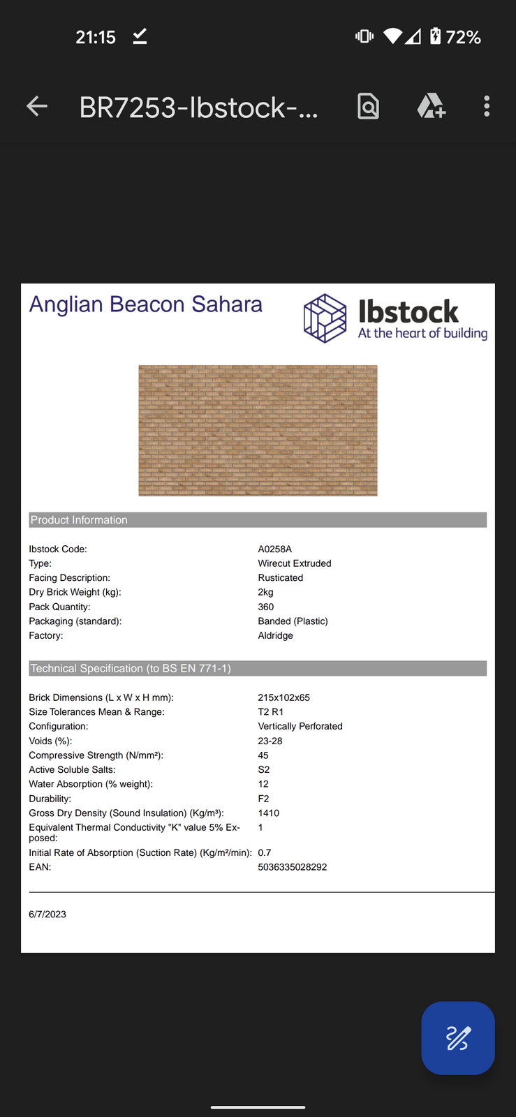

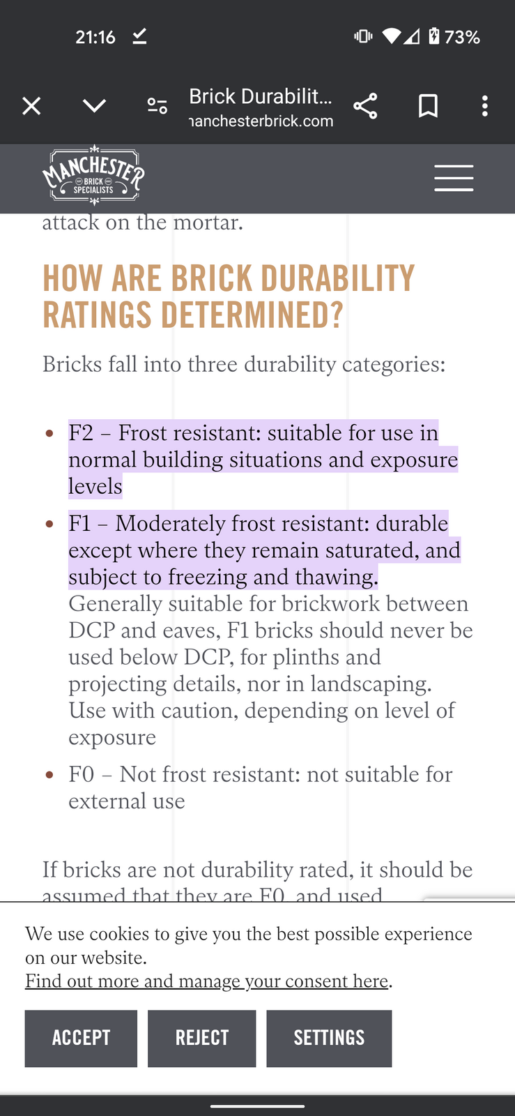

Interestingly, this is the brick datasheet which says F2 for frost rating durability.
Google reckons that's the best rating level..?
There is no way those bricks are suitable for that use - they are soft clay, and that is what happens.
It's very common for some bricks despite a particular rating, to be unsuitable for a particular use.
So if you plan on using a clay brick again then you need to select one suitable for that use, in that location's exposure. You can save the time money and effort in any drainage and spend that on the wall materials instead. TBH, that vegetation is likely dealing with any excess ground moisture by absorbing it.

- On the vegetation, the picture makes it look more significant than it is. It's just annual weed growth, no big roots. I could strim it back to dust in half an hour but I've left it this year because the children have slow worms living in there...and go and check on them every day lol! In winter it's a barren slope.
