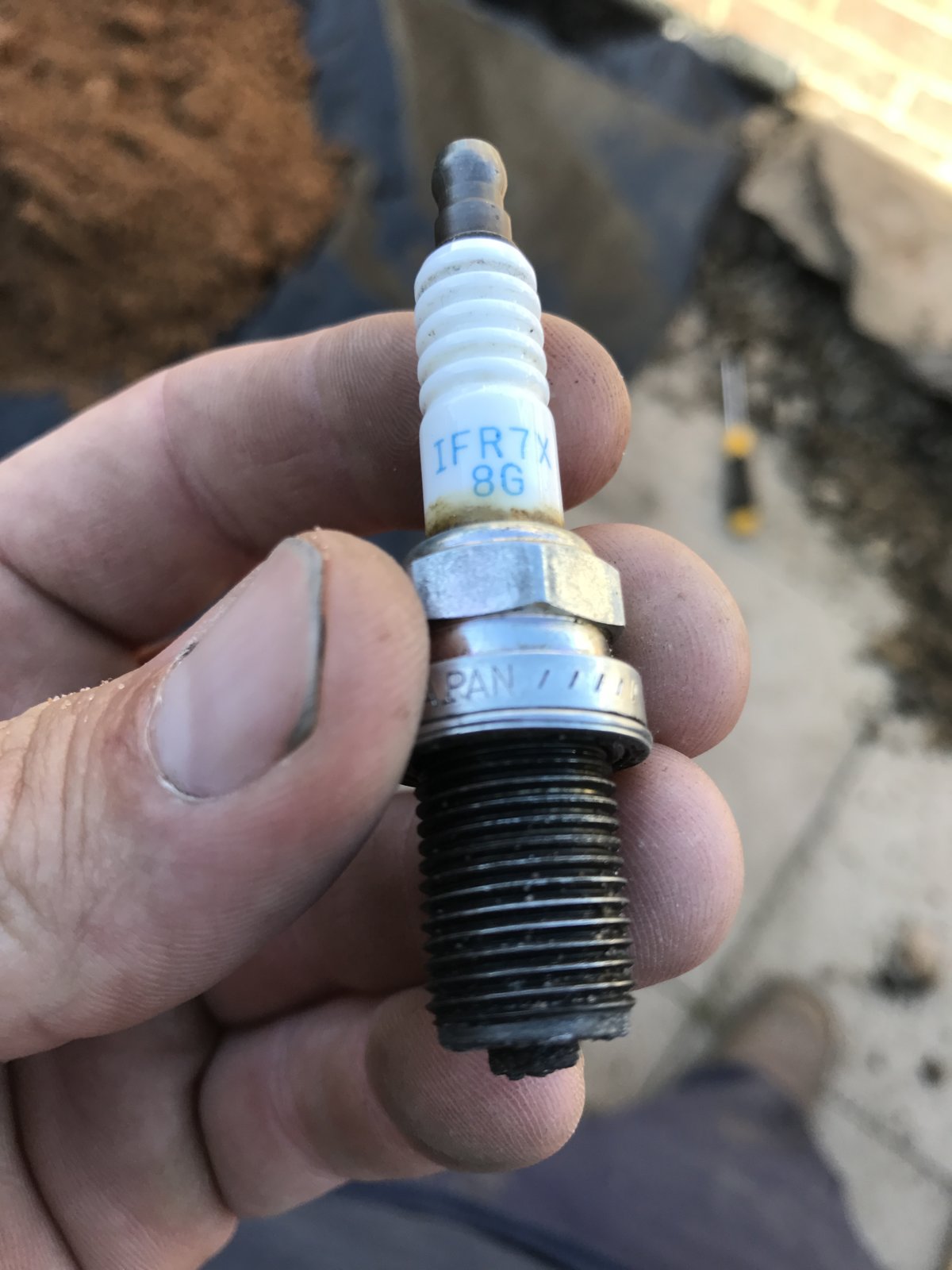

My daughters boyfriend has a Megane RS250 that's just blown up.
A spark plug came out looking like this:
And the piston on the same cylinder looked like it had a chunk out of it.
What could have been the cause?
Oh dear - Iridium plug failure :eek:
In the good old days I would have expected the ignition timing to be too advanced but that's fixed now. I'd suggest incorrect plug for the car or maybe grossly overheated for some reason. Maybe the engine is designed to use high octane petrol?
The tip of the plug has gone, hence the mark on the piston crown.

There was zero compression in that cylinder.
I've had the odd bit of debris bouncing round on the top of the piston.....it was the valves that finally copped it.
With that sort of BHP available, anything can happen!
John :)
Maybe the people who tuned it didn't consider upgrading the spec of the spark plugs.
I think the piston was more a big chip rather than a hole. He fitted those plugs as an upgrade after he had the ECU remapped.
When he bought it it was running very rich due to a poor map so he had it done again. That was about a year ago and it's been fine since.
I'd guess the compression has gone courtesy of the plug electrode getting familiar with a valve.....seen that before.

So you think a spark plug failure was the cause?
For sure, yes.....the plug electrode has melted because it couldn't handle the heat that it was subjected to.
Personally I think it was the wrong plug for the job but that's difficult to prove. Over advanced ignition could also cause this, depending on how the engine was mapped.
