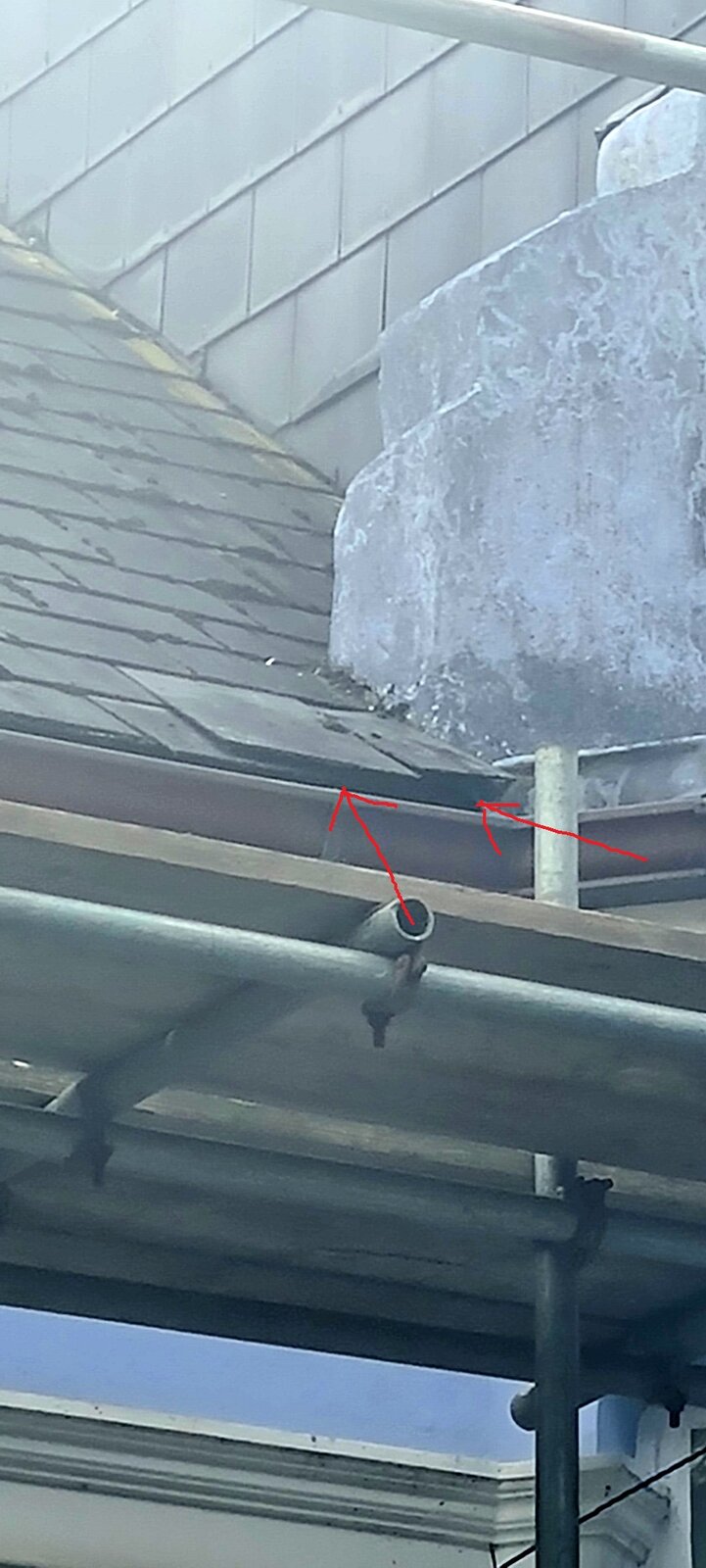

8 Same Acrypol sealing. Something I'm not sure about is the felt sticking out of the edge tiles (red arrow). It would prevent water from leaking from behind the gutter, but it seems such a temporary solution. I think one of them mentioned that you don't want to use edge drips because they lift the these kinds of tiles and could make things worse, but unable to know if they were BSing or what.
Did they supply the scaffolding or subcontract it. That could be a big chunk if it was the latter, if not and there work included erecting the scaffold then it sounds, from what you say, like between the 2 of them they might have spent 30 hours ( including travelling ) on the job. So knock off a couple of hundred for materials and they are charging something like £150 an hour. That is a rip off up here (Northern England) but not sure of rates where you are. How did their quote compare to others. Also I would have thought they should have fitted gutter trays which I cannot see.
Difficult to tell much else from your pics. Is the loose ridge tile yours or next doors and whose is the dormer would have thought it should have had lead flashing but just looks like flash band stuck on.

On the sides of the dormer it seems that they did what they put down, that is "sealing all soakers"
I suggest you post the images on the roofing section of the forum and get opinions from pro roofers
Personally I think that sealing is simply a bodge -apart from just showing theyve "done something" I cant see what it physically achieves, if the lead soakers are failing or incorrectly done, they need redoing
Thanks Notch! It looks like it was moved to the correct forum (apologies). With regard to the "sealing", I have the same feeling, but I don't work with roofs and so I'm not sure I have good intuitions about what works: what is the point of brushing Acrypol over the soakers? If they are failing there is no point, if the are not failing there is no point either. For that price, I would have expected all soakers being redone, assuming they needed to be redone. Somebody else did quote redoing them with code-4 lead soakers, which seems like a serious job. That quotation was less than £4800, but the guy had missed the need to replace the rotting fascia. So, not exactly comparable.

We don't really know what the issue is or was . But to be honest it looks shoddy.
There are damaged slates still on the roof , CDRs missing .
I don't believe these were genuine roofers .

Copper disc rivets .
Some are missing especially in the vertical . And damaged slates along side the dormer. There should be no need for acrypol

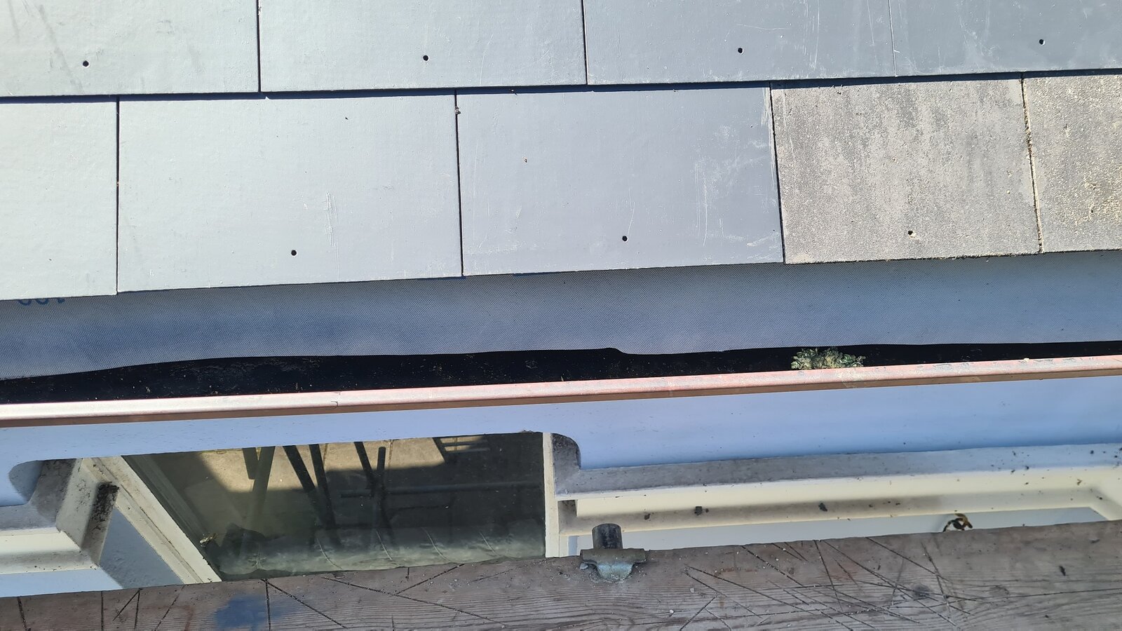

Ah! Yes, I know what you mean now, I've seen those installed a while back. So, for example, are you saying that in picture 1 the black holes should have CDRs in them to prevent the tiles from slipping down or from being lifted by strong winds? Makes sense to me. Also, is it common to have plastic trays (whatever they are called) under the last tile row, to ensure water goes into the gutter rather than behind it? Somebody else used those on the back roof a while back. As it is, there is only felt sticking out from the last row of tiles, but that seems like a cheap hack more tha a durable solution...
The main issue that was causing problems is visible in this picture, I think: Water was getting behind the gutters through that gap. Over time, it had rotted the wooden fascia (which was replaced with a PVC fascia). The felt underneath the first row of tiles was bunched up and old and it was replaced, together with a bunch of tiles (about one meter up from the edge).
