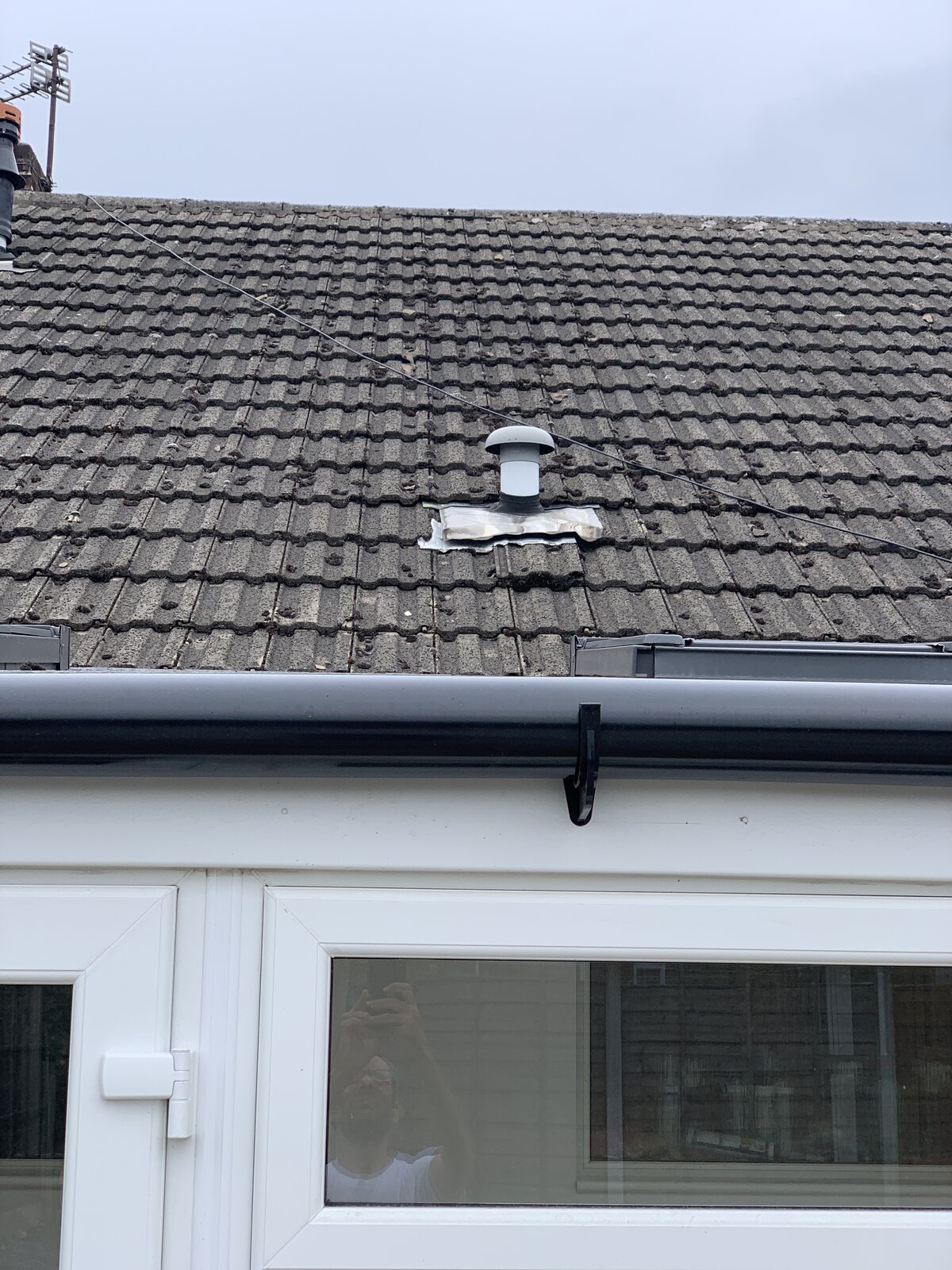

We have a fan extractor that currently goes through the roof tiles.
I am changing the roof next week and I’m wondering if there is an attachment I can plug into the eaves vent so I can connect the fans flexible pipe to it to avoid having a cut on the roofs membrane. Does anything like that exists?
Is that not the soil and vent pipe? Have an internet search for eaves/soffit extractor fan kit.
They usually just have a cage plonked on top as opposed to an expensive mushroom cowl.
True, but obviously not impossible. When I fitted them,I tended to use a cage too.
