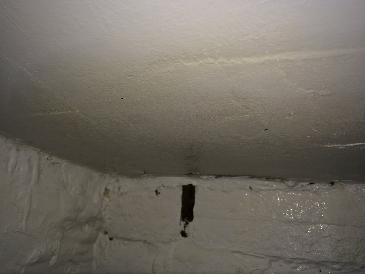

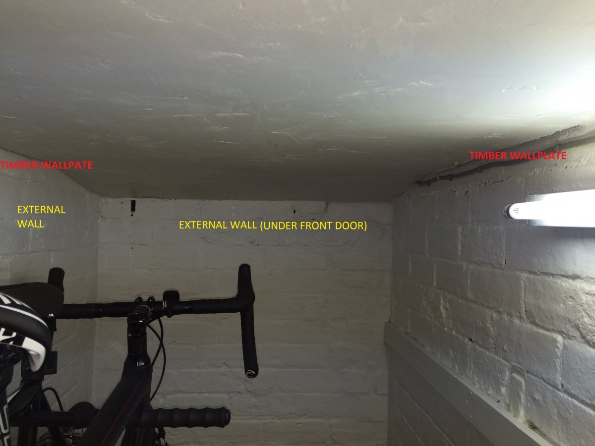

OK. I've attached a couple of photos of at it's worst below:
My cellar is split into 2 "chambers"; the one in the picture is the left hand side, with no window, and is where it seems to be worst. There is no movement of air whatsoever, and hence why I thought of a fan.
The front external wall is slightly damp, but the ceiling above (2nd photo) is covered in water droplets.
Above that front wall is my front door, and there is an airbrick just below it - presumably why the ceiling is sloping at the front, to allow air into the floor void??
Is this cold air above the ceiling, and the warm air in the basement (from radiator) causing the moisture on the ceiling? Or something more sinister?
I've marked the wallplates, the joists run left to right in the picture. They're OK/dry on the other side of the cellar, I've lifted the boards.
As I've said before, I know tanking is the best solution. But there must be something less expensive that I can do to decrease the moisture / increase the airflow?
