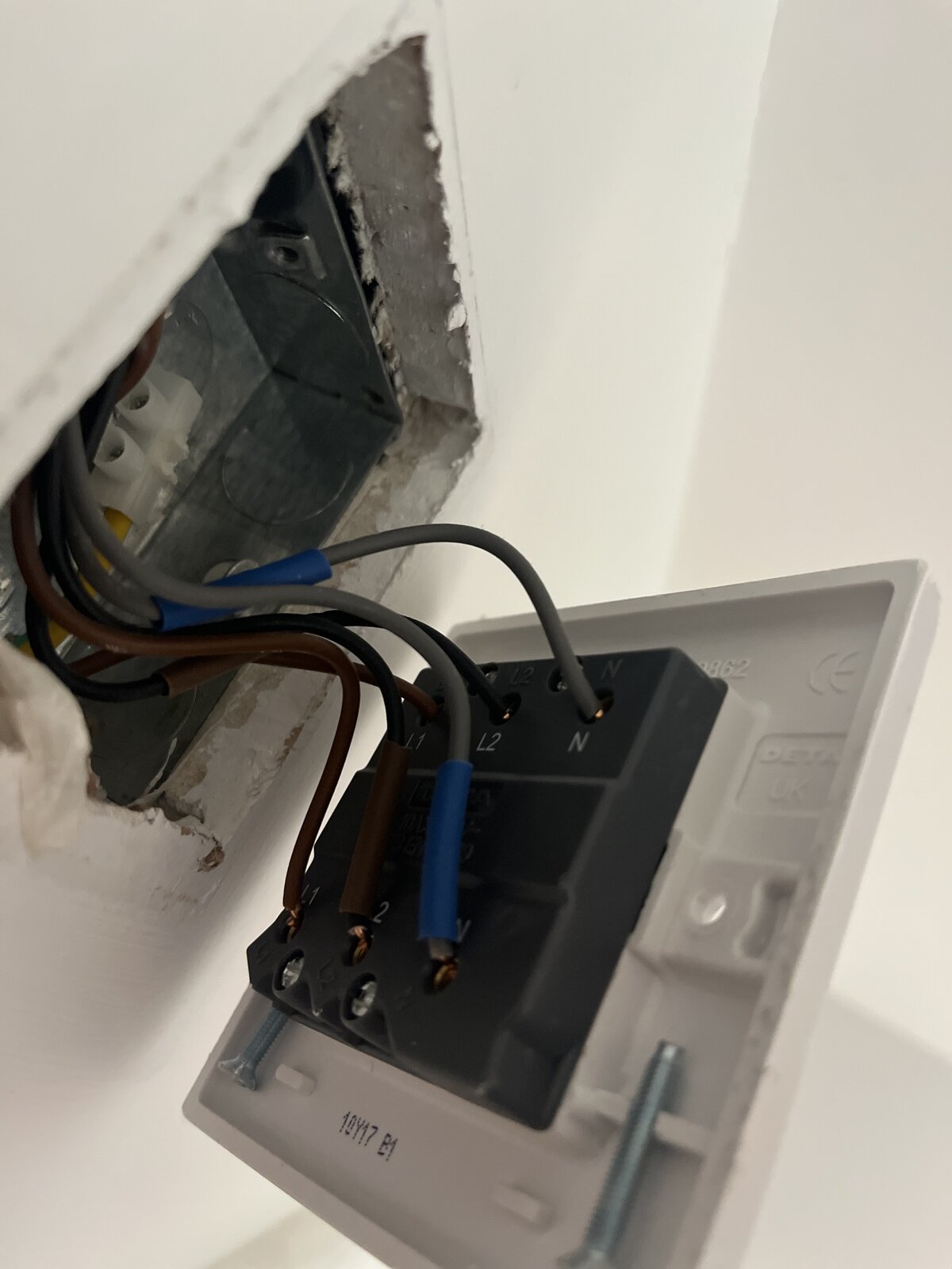

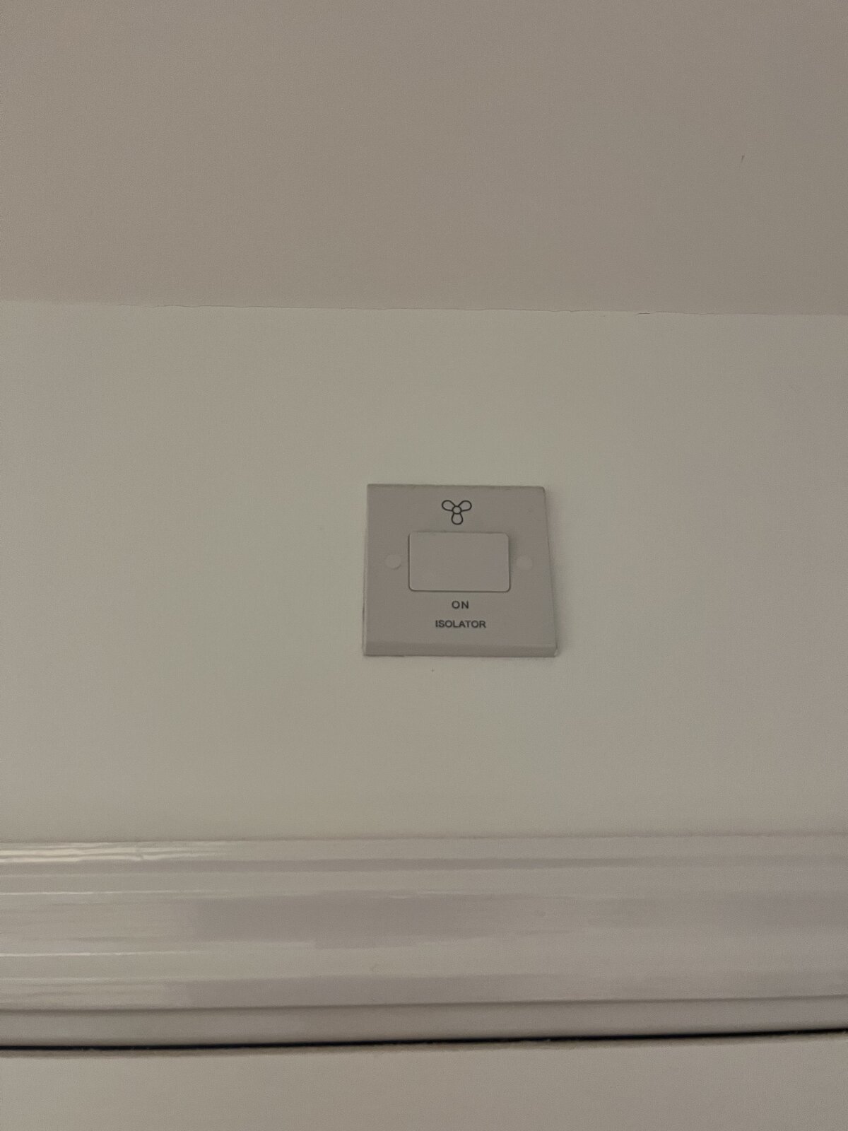

I hope somebody could help. I’m going to be installing 3 soffit lights in the next few days. I’m wanting to get a feed from existing lighting circuit, but all my lights are actually looped at the switch rather than ceiling rose.
Rather than fish to a switch in the bedroom, could I take a feed from this fan switch as it’s quite close to the ceiling and would be a lot easier.

You could, but might be less disruption, breaking into a cable in the loft space. You would really need a separate means to turn the soffit lights on and off, as the cables and lights will be semi-outdoors, it would be a good idea to make the switch, a double pole. In fact the switch, and it's box, could be mounted up against the ceiling, thus avoiding cables running down walls.

If I break into a cable in the loft it would be a switched live and would only work with bedroom light on. I need a permanent live which will only be present at the switch.

Almost certainly, there will be a live and neutral in the loft.

Just took the fan isolator plate off. Is it just a case of running a twin and earth 1.5mm wire from L1 and neutral, then dressing the earth cable into the existing block then run it into the loft and then into my quinetic receiver?
Yes. Its up to you if you want the receiver switched off by the isolator switch. But you'd need to find a way to get the new cable behind the plasterboard..... It looks like the fan cables go up anyway. I'd be finding my feed up in the loft rather than disrupting the existing.
